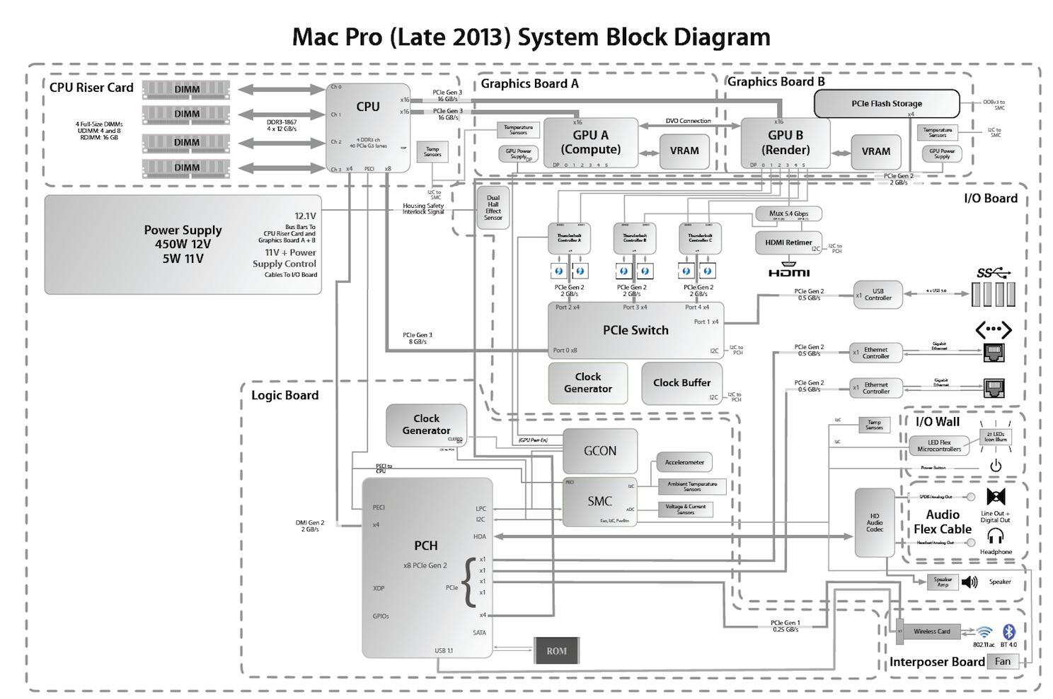

i think i have trouble with one of my gpus is it possible to remove one card and run the mac with one ?!
thx
It looks like you can only remove GPU A (dedicated for compute). If remove GPU B, then no GPU is connected to the Thunderbolt ports and HDMI port.

Just removed one GPU and can't get it to boot. There is a fault on this Mac Pro and I was hoping it was the A card and that the Mac would be fine running on only the B card, but nope. Stuck at the Apple logo on boot.
Thanks for confirming, I believe one of my graphics cards is failing but it must be the one connected to Thunderbolt since I'm getting red vertical lines and am stuck at boot. Would be nice if the two GPU cards were identical and I could swap them, or remove one.

I reflowed the GPU on the B board (one with SSD) using a heat gun and it’s working for the time being. Hopefully ties me over until an M2 Mac Mini. I don’t need a Pro machine, just bought it from a friend a few years ago in need of cash.
