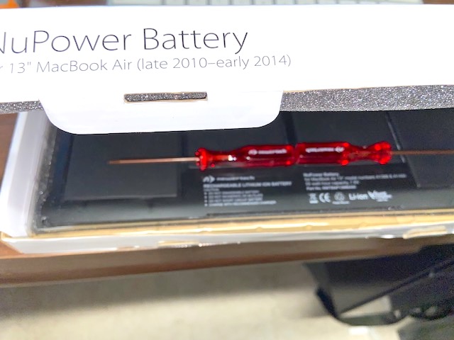

I tried the SMC reset without success. The "newertech battery..." looks like an easy installation. I'll have to see if I have the Apple screw driver set and if so, I may give it a try. Other than a lot of screws to keep track of, I like the simple connector that connects to the computer. Great youtube video that shows the installation.
Thanks
Do it yourself. Many batteries come with screwdrivers as well.
Correct.
The new batteries come with set of the pentalobe & torx screwdrivers.
Luckily, these batteries are not glued down like the rMBP and newer devices making a battery swap easy as pie...
As a rule of thumb, always disconnect the battery as soon as you remove the bottom cover. The last thing you want is to drop something metallic on the logic board with the battery connected.
