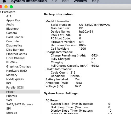

So on AC, you can find the battery, could you get info of battery from "system report - power"? something like :
