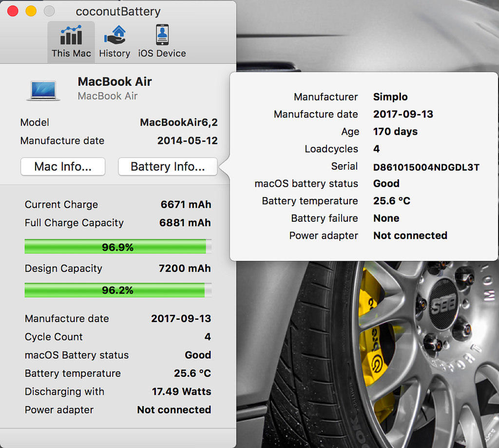

I thought about this and was thinking of getting mine from ifixit.com but went this route since it was only $49.99. I figured if this battery did not work out then I can get one from ifixit. So far this battery has been working very well on my 2013 MBA.... no complaints.
Would you mind posting a screenshot of Coconut battery along with the info it shows about the manufacturer?
Getting it from Apple pretty much assure you another 1,000 cycles, but if u don't intend to keep this puppy for that long, hey, DIY it. I gotta do mine soon, will check out iFixit and chk out what people over there say about iFixit's offerings. It should surprise nobody, lots of floating Chinese batteries with unknown longevity, if they don't swell up before death.
I just installed the battery on my 2013 macbook air and its working good. I show 12 hours on a full charge and 1 cycle. Its the same capacity as the original so im happy for the 50 shipped I paid for it. If I can get another year out of this laptop im happy. My old battery kept showing service battery warning and only showed 4 hours capacity at full charge. It took me literally less than 10 minutes to change the battery since it came with the 2 screwdrivers I needed. Most of the time was cleaning all the dust out not changing the battery.
Mrbobb saying another 1000 cycles, and mine has done 986 with a status of good.
Having said that, it's 2000mah less than the one above running at 77% of full capacity... depending on the cost of that, I might just do it and wait a few more years and spend big on a major macbook update replacement. Can't see the MB as much of an improvement over a 2013 MBA 11...
