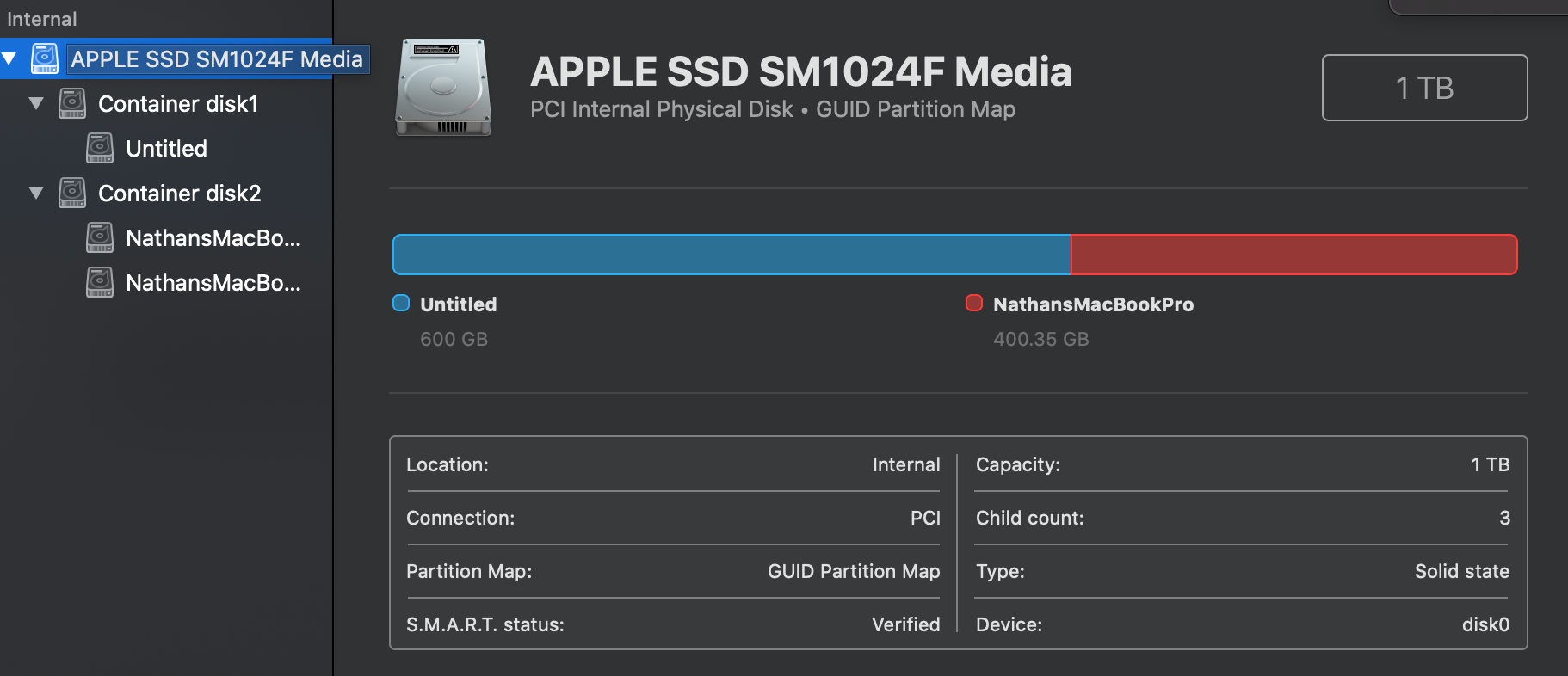

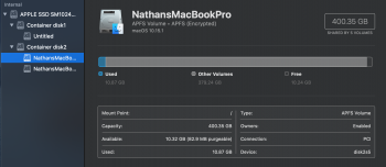

Hello, Ive really messed up my MacBook and could use some suggestions on how to proceed/fix the issue.
The problem began with me helping my parents. They needed to move their old Mac data to a new one, so attempting to be helpful, I partitioned my 1Tb SSD and backed up their stuff. The real issue began after trying to recover the partition. I used disk utilities to reformat and ever since then, major issues have been encountered.

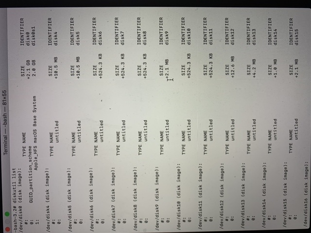

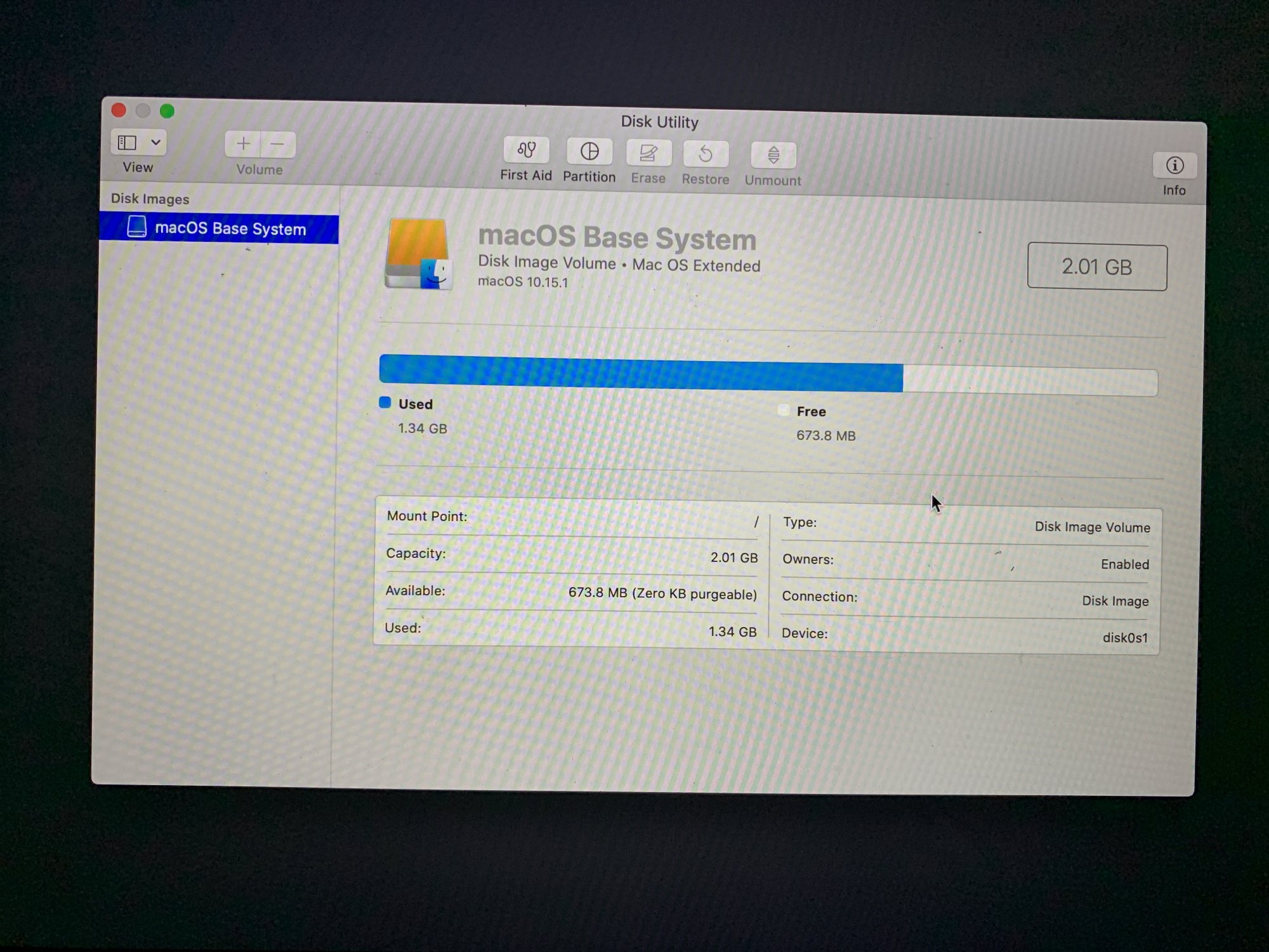

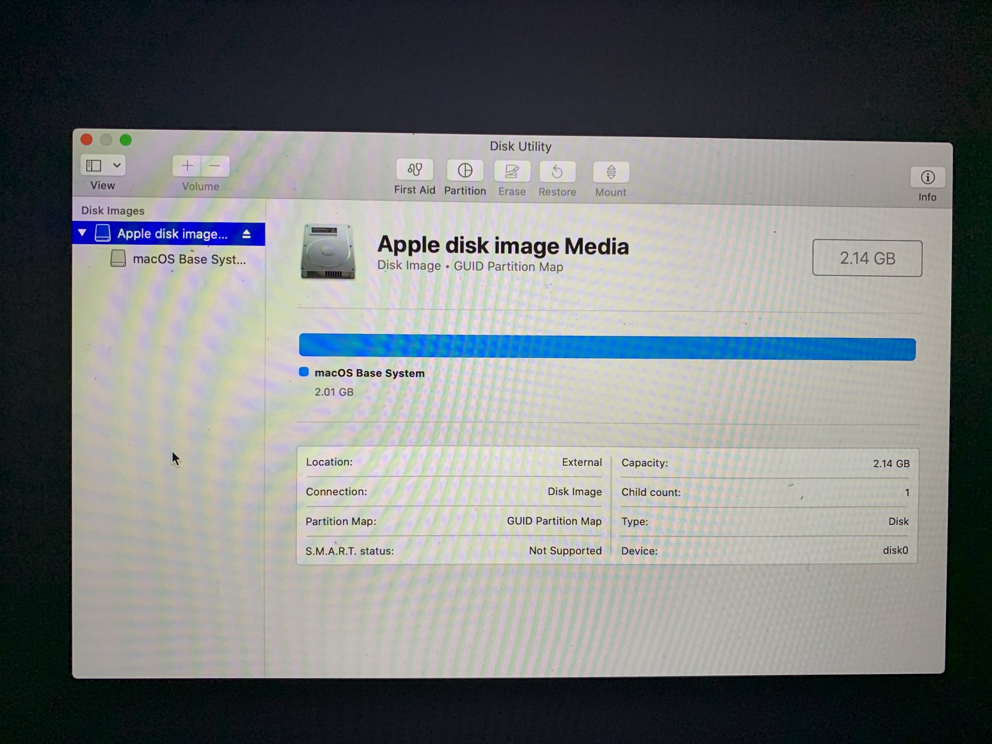

It freezes 4-5minutes after boot up. I can’t rejoin the partition. I can’t even back up anything not in the cloud because it freezes. So I attempted to simply reformat the entire SSD. Booted into recovery mode, but Disk Utility in recovery mode doesn’t see the SSD (just macOS Base System)! Tried going into Terminal and manually mounting the drive, but it doesn’t appear there either. I can boot into Mac OS, but the system doesn’t detect the SSD in recovery. I booted from an external Hard Drive, but still couldn’t detect the onboard SSD.
Pretty sure it has something to do with the OS being on disk2, within disk 0, but can’t mount/find it in terminal.
2013 MacBook Pro Catalina 10.15.1

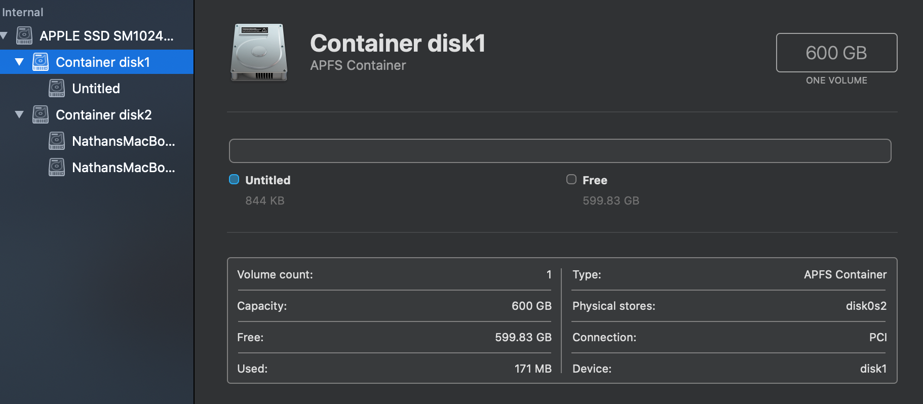

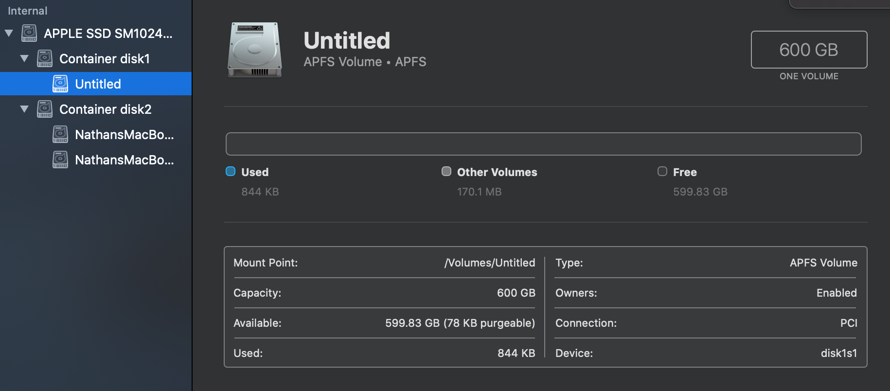

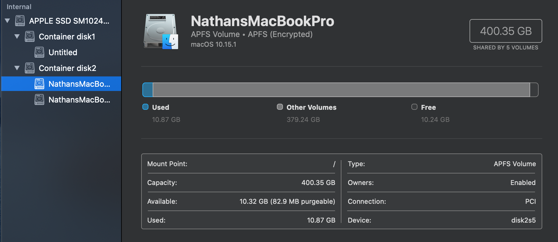

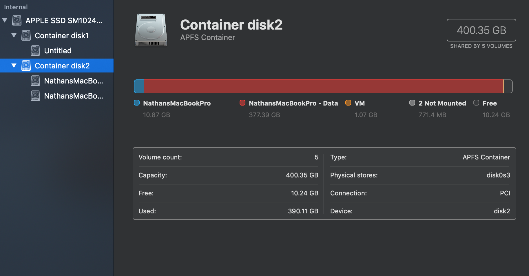

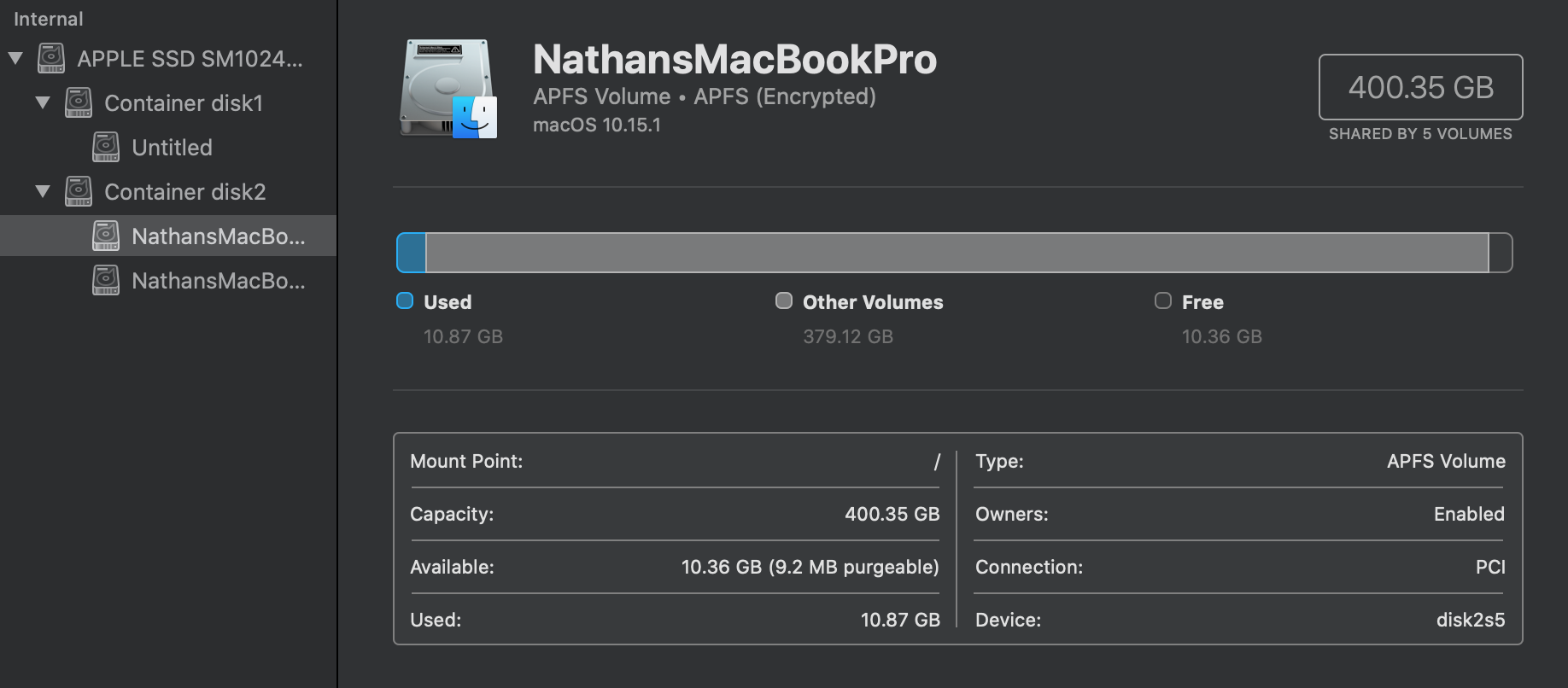

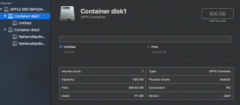

I see two drives and 3 partitions: Container disk1 with 1 partition and Container Disk2 with 2 partitions.
You want the Mac to boot from disk 1?
Disk 1 no longer has any OS. What I am trying to is reformat the entire SSD to a single partition and reinstalled MacOS. I can’t find figure out how to format disk 2 as it doesn’t show up in Recovery Mode Terminal.
Reactions: Audit13
You want to format both disk 1 and disk 2? I thought disk 2 had the backup.
Disk 1 was reformatted, it’s blank. Disk 2 (as seen in the 2nd photo) contains my info. I don’t care about any data on the computer, I just want the entire SSD wiped and combined like new.

Here is what the entire disk looks like when booted

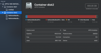

I don’t want a separate disk 1 or disk 2. It’s all on the same internal SSD. I want the entire 1TB combined (though I know MacOS now splits it between data and OS).

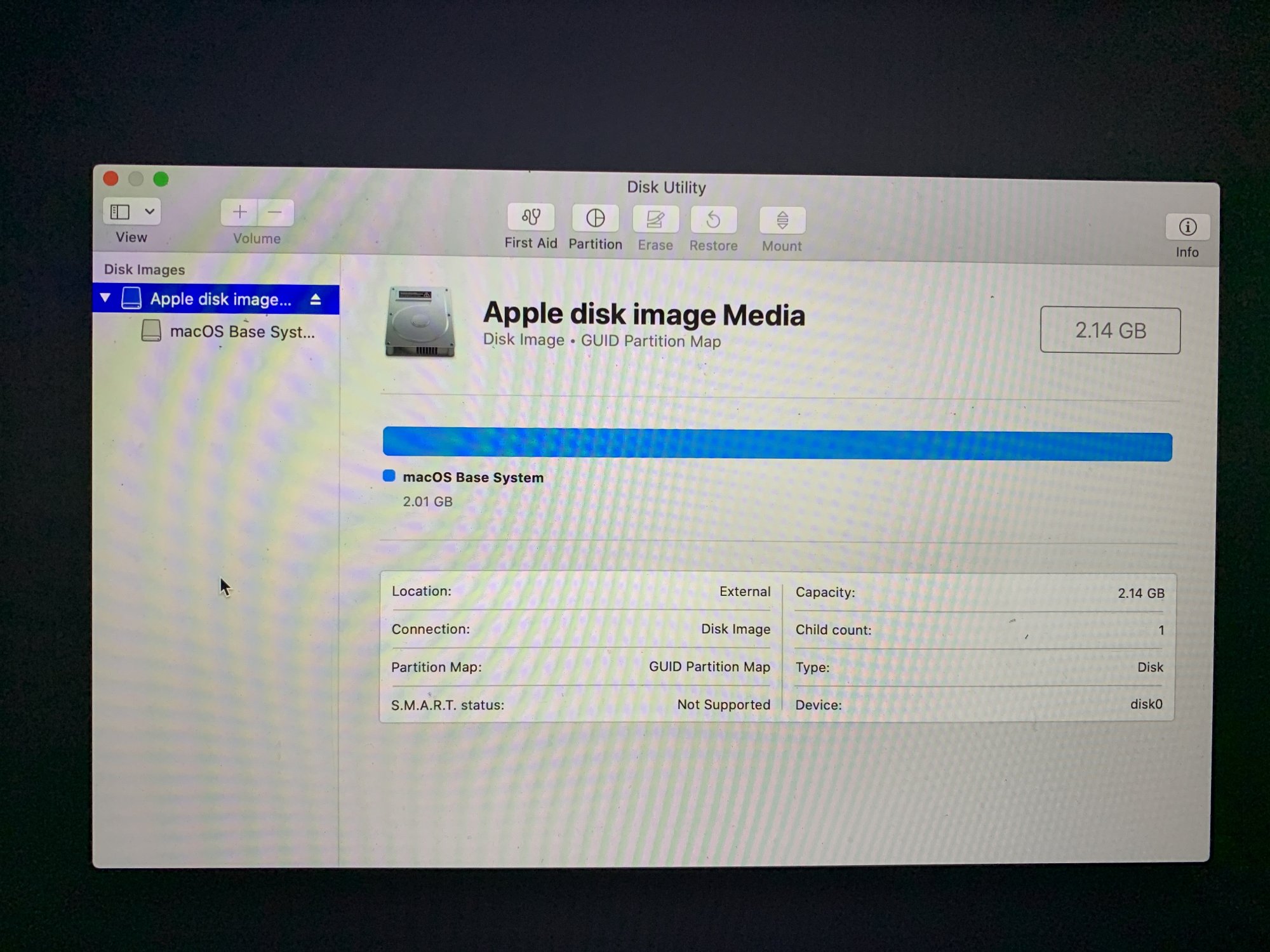

I have attempted internet recovery, but I get the same result as the normal recovery seen here
[automerge]1589828951[/automerge]
Try a newer version of disk utility.

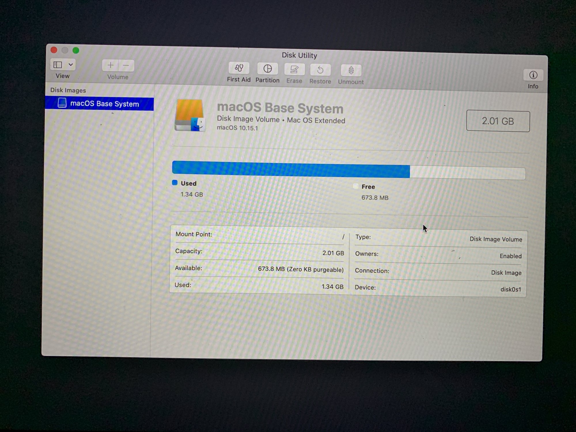

I’ve installed the newest MacOS on an external HDD and booted from there. The internal SSD is still not visible

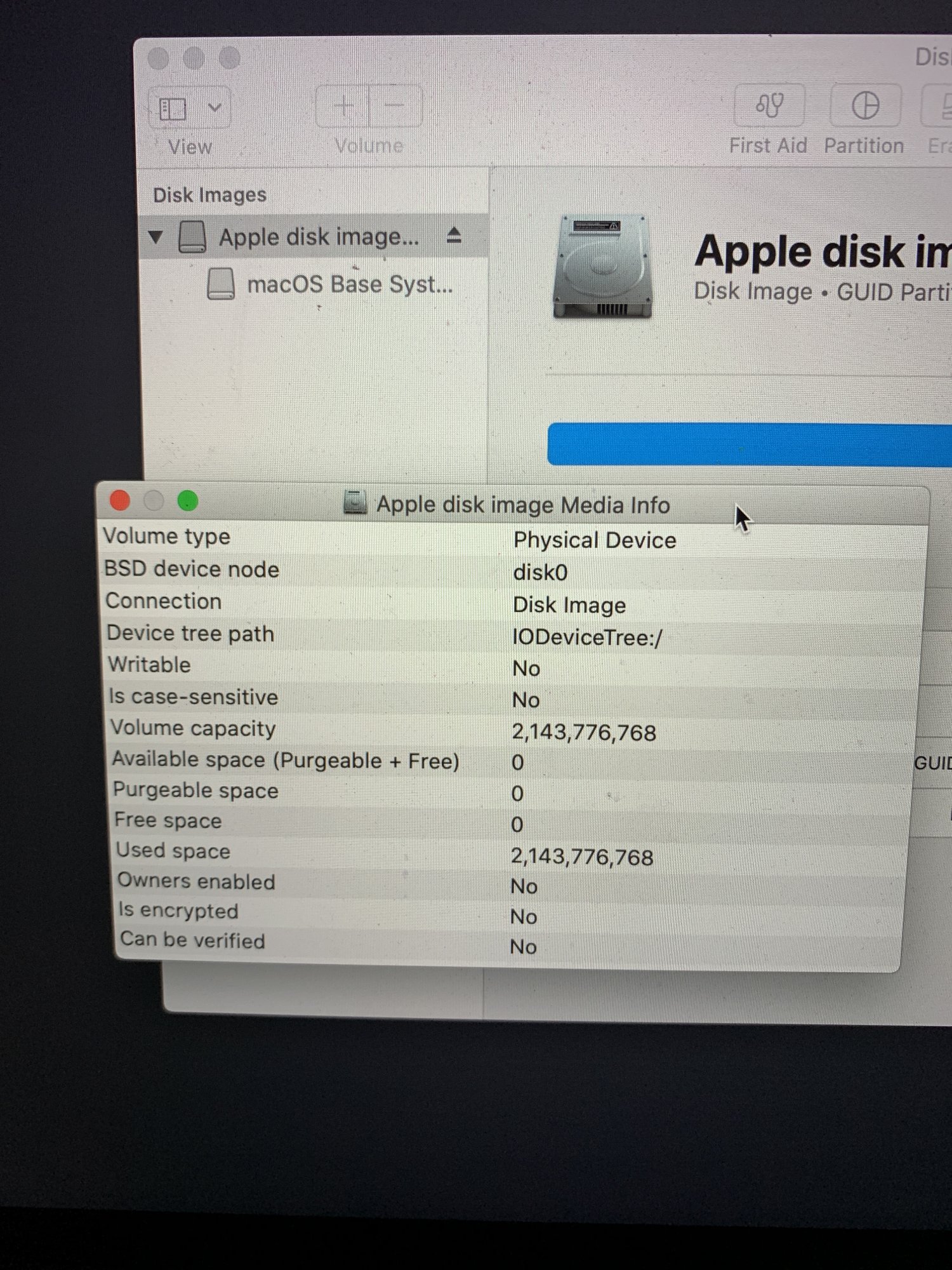

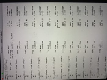

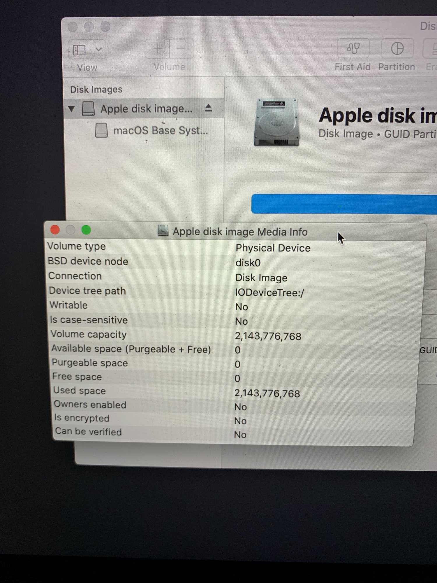

Thanks for trying. Hopefully someone will have an answer. Can’t find any info anywhere that remotely identifies/fixes the issue. Definitely not a dead SSD as I can boot into it, but not addressable. What’s weird is the computer still knows it exists in the info pan

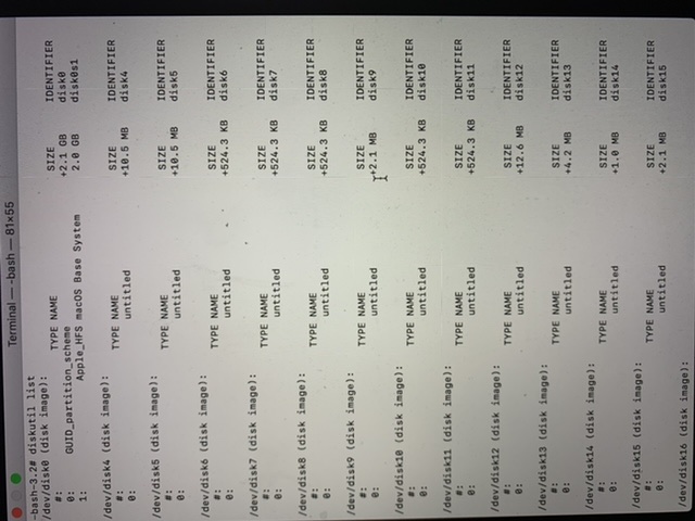

Booted onto the external HDD and now it doesn’t detect the SSD no matter what I do. Gpt, fdisk, diskutil list, nothing. /dev/disk0 is no where. Can still unplug the HDD and the SSD boots

I showed jaytv above that it didn’t show up there. I would think it has failed, but since MacOS was still booting, it must not be.
