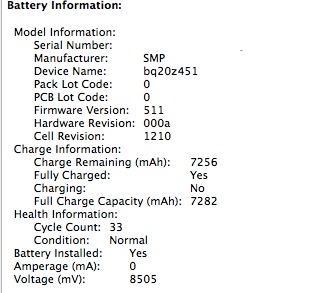

I bought my 2013 MBA just about a year ago, I've attached my battery info.
33 cycles in a year. I intentionally cycle the battery approximately once per month.
What is your battery health percentage a right now?

7282/7150 = 101% accordıng to the screenshot he posted.
