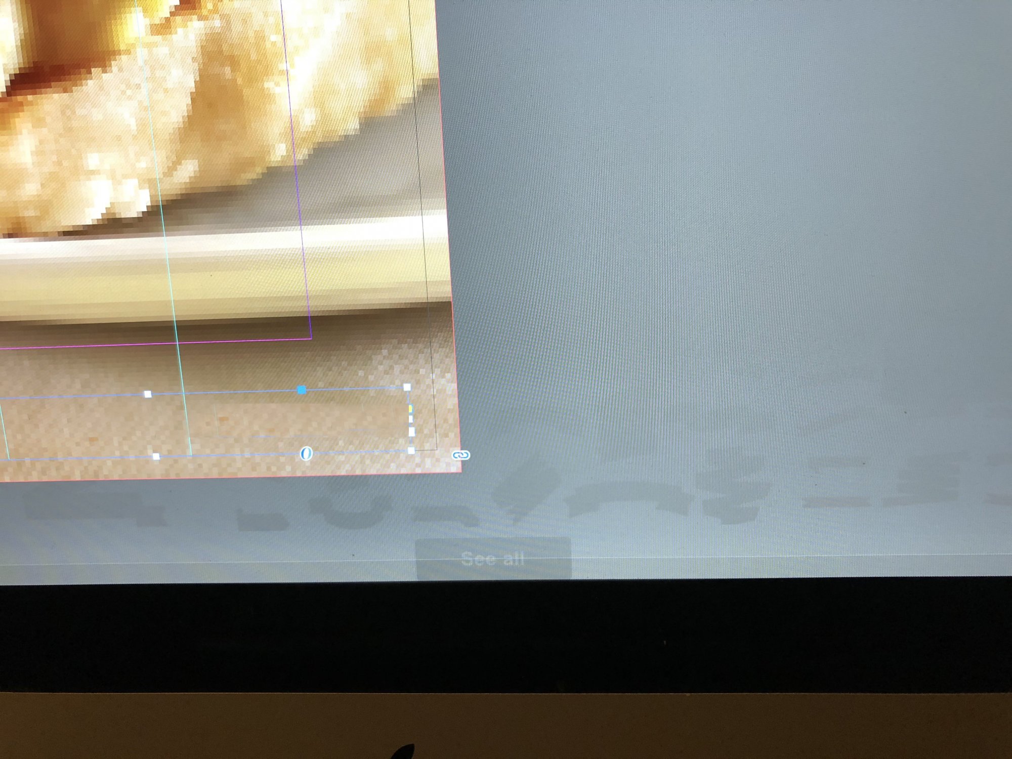

As the subject line says - I have a late-2014 iMac (27" Retina 5k) that is experiencing some highly noticeable screen ghosting within just a few minutes of use. I know that Apple has created a support article discussing how IPS displays can experience image retention... but this seems to be a little excessive in how quickly it appears.
If anything the problem seems to have gotten worse with the upgrade to Mojave and later to Catalina. Attached is an example from today while I'm working in Adobe InDesign. You can see the ghosted image of a stock imagery website in the bottom.
That sort of ghosting will appear heavily at the bottom of my screen and to a lesser degree on the right side of the screen. The screensaver will (eventually) remove the ghosting. But within a few minutes of even casual use the screen will just begin ghosting whatever it is I'm doing... whether that's working in Photoshop or just surfing the web.
Is there anything I can do to help mitigate the issue? Because this whole "Just run the screensaver..." thing doesn't seem to actually do much.

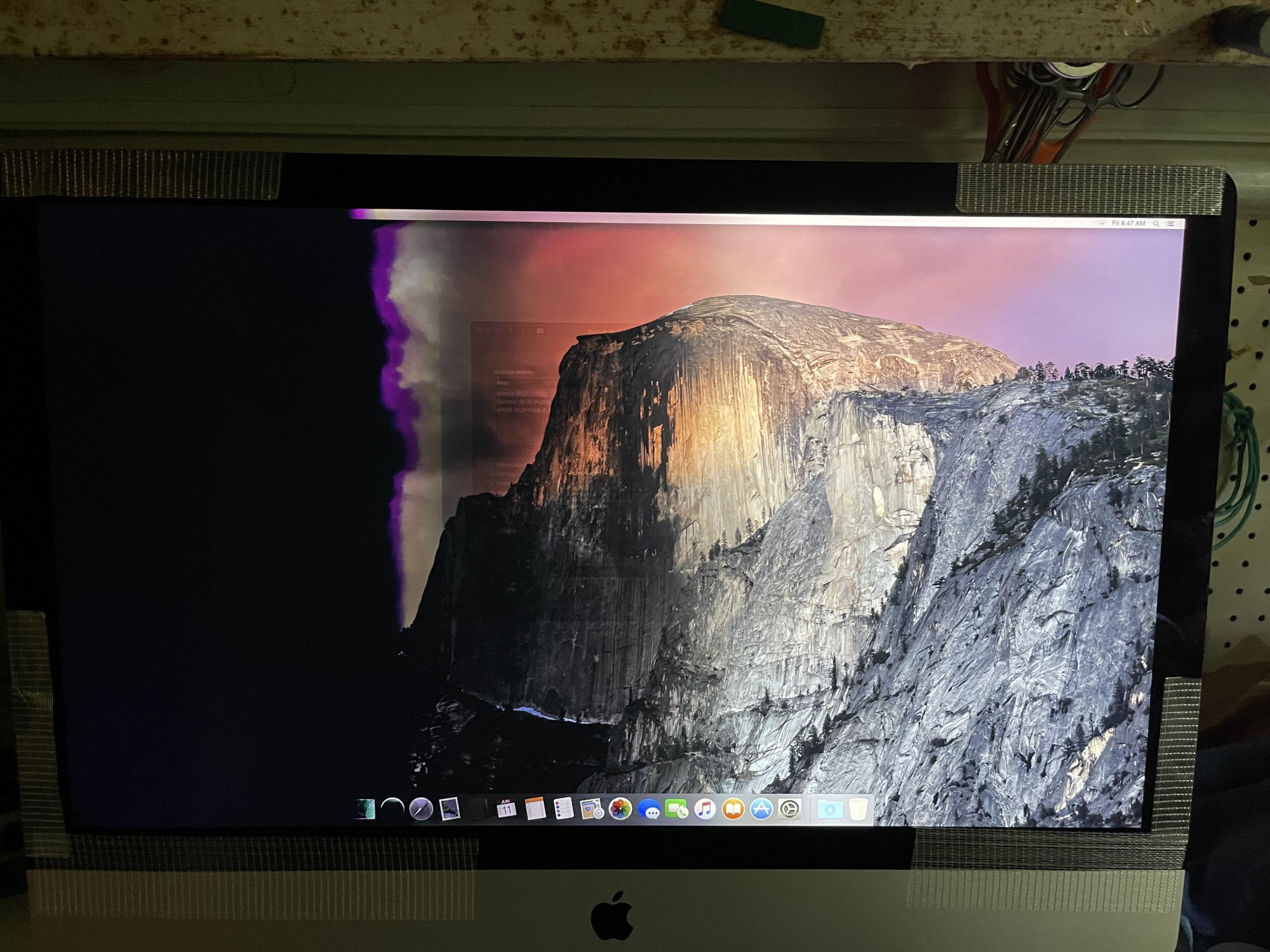

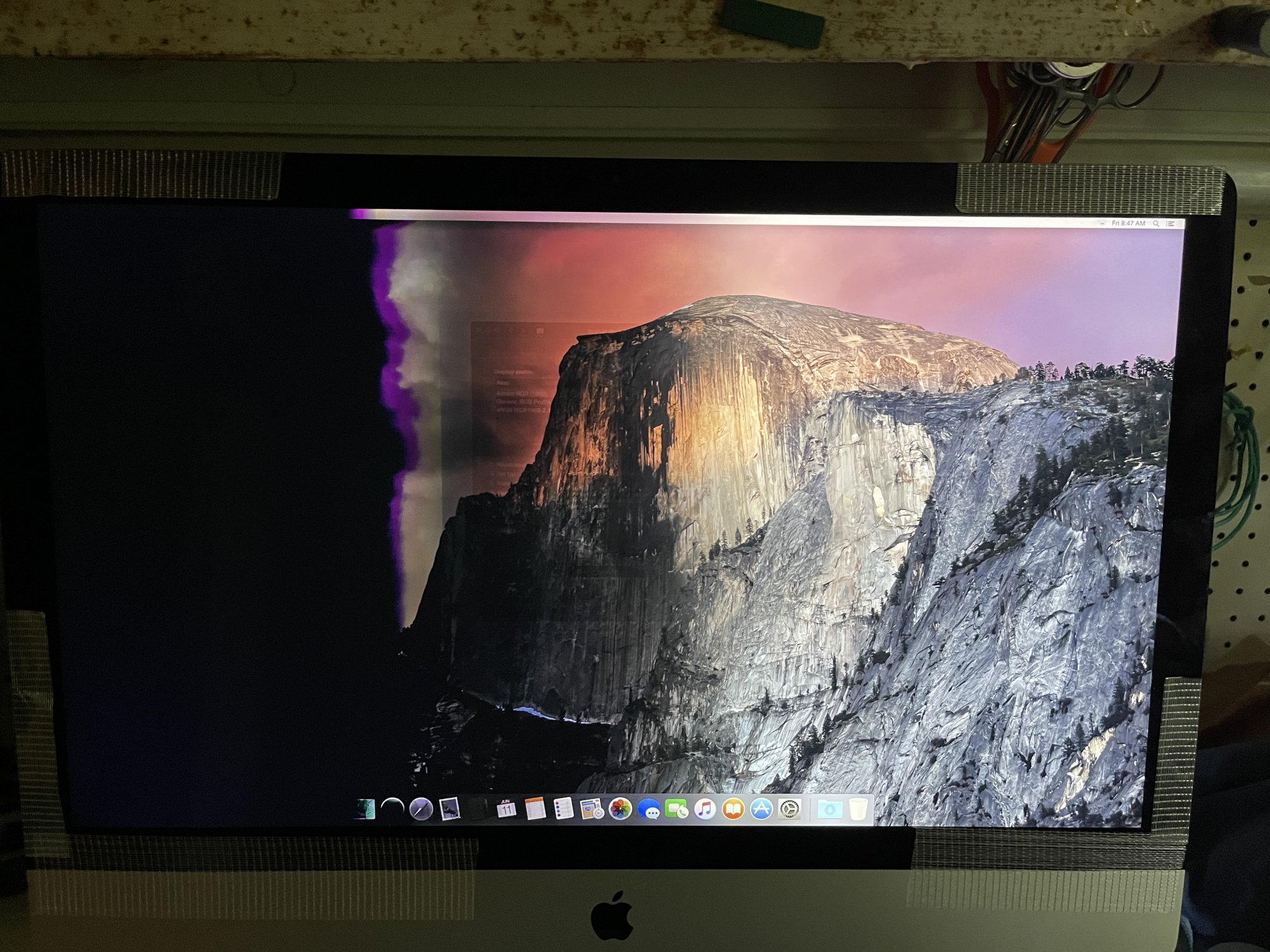

Late 14 27“ iMac SSD Upgrade, was always grounded, first thought was I shot the GPU, but after reading this thread I would like to solicit some opinions here…
thank you for your thoughts….
Nope. At the end of my “upgrade”.… With half the screen I was able to install OSX, in the hopes that the defect might resolve…. Subsequently changed the display cable …
thanks
