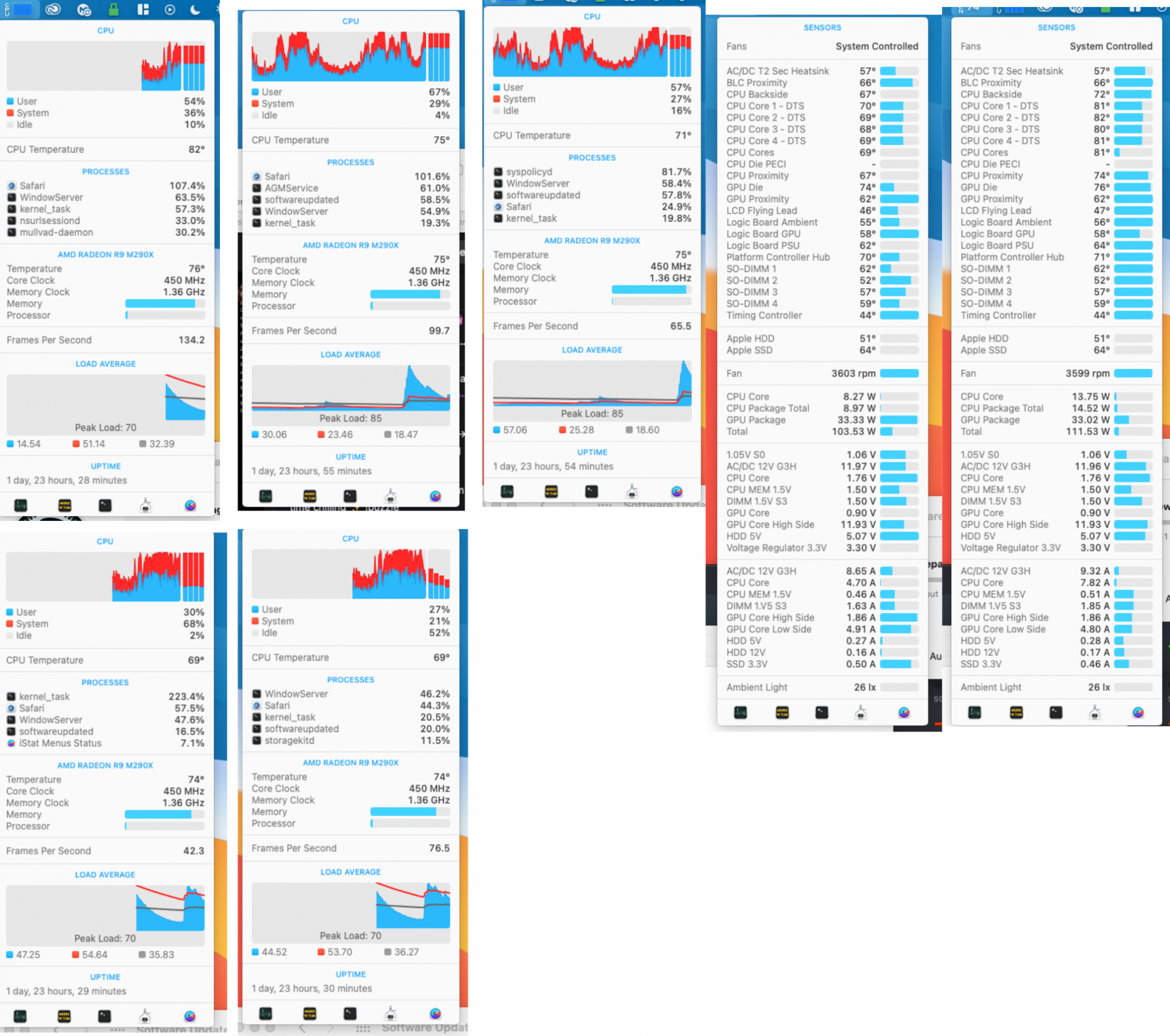

I used iSat to get get some info if that helps:

It seems to me that your CPU temp is a little high.
Safari and software updater are occupying CPU.

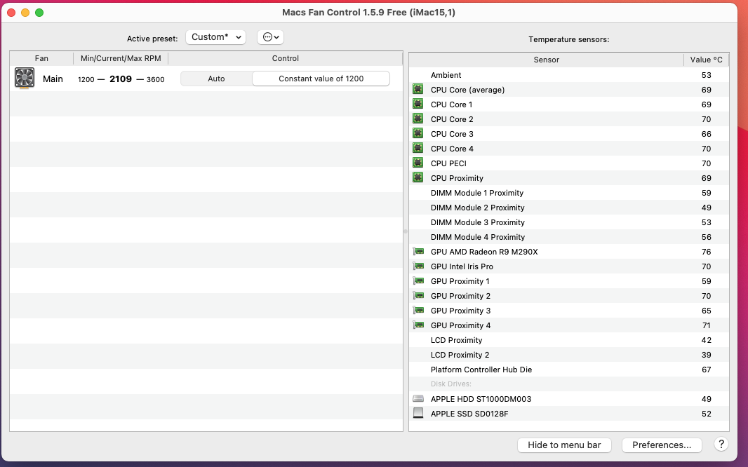

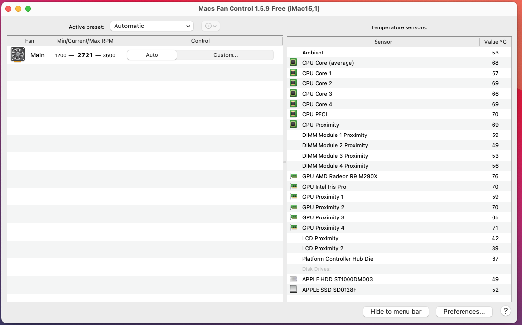

I've tried a SMC and I also just tried MacsFanControl and it seems I'm able to control the fan. I have not yet tired the Intel Power Gadget.

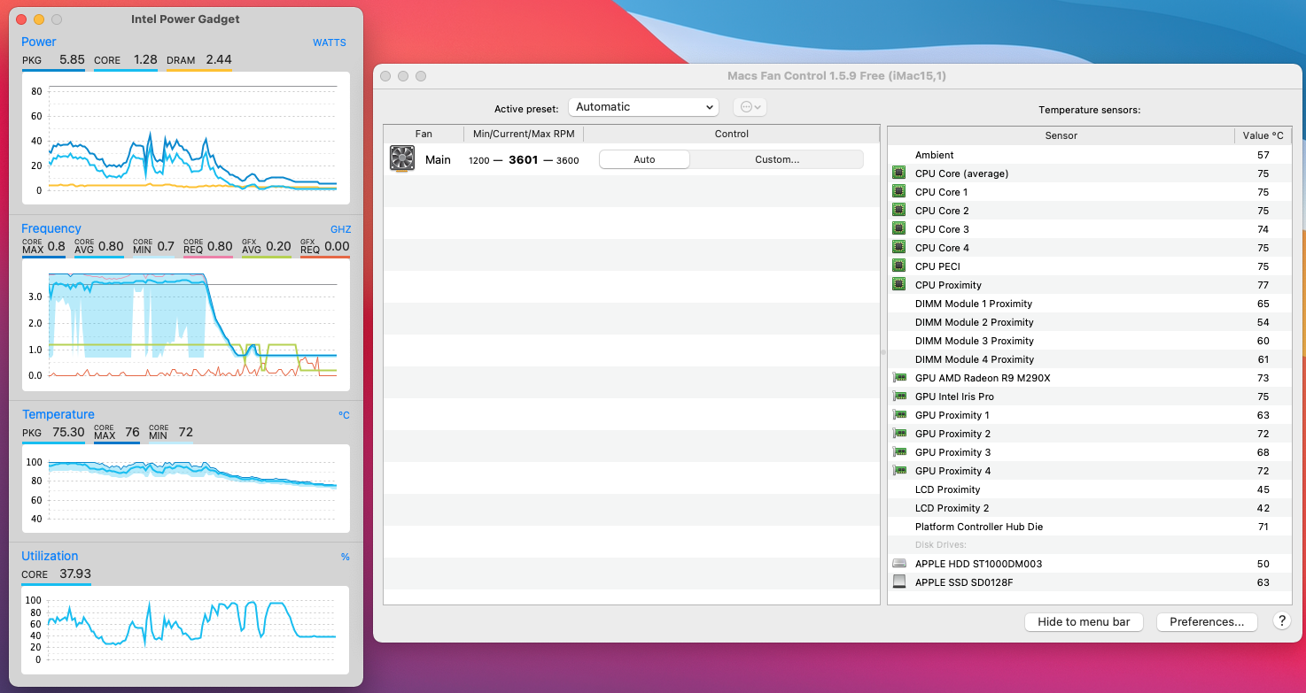

Just installed Intel Power Gadget and this is what information it displayed.
Ok, I don't know enough about this to help you, but a number of things look odd to me. The CPU frequency is dropping to a very low value, and despite the CPU temperature dropping the fan is still running at 3600 rpm, when that iMac fan max speed should be 2700 rpm (at least, mine was, and so is my 2020 5k iMac).
Keep in mind that Apple used the same CPU in your 2014 iMac, as they used with the "2K" 2013 iMac. Your 5K display makes it work harder plus recent macOS may be more taxing on your old CPU as well.
