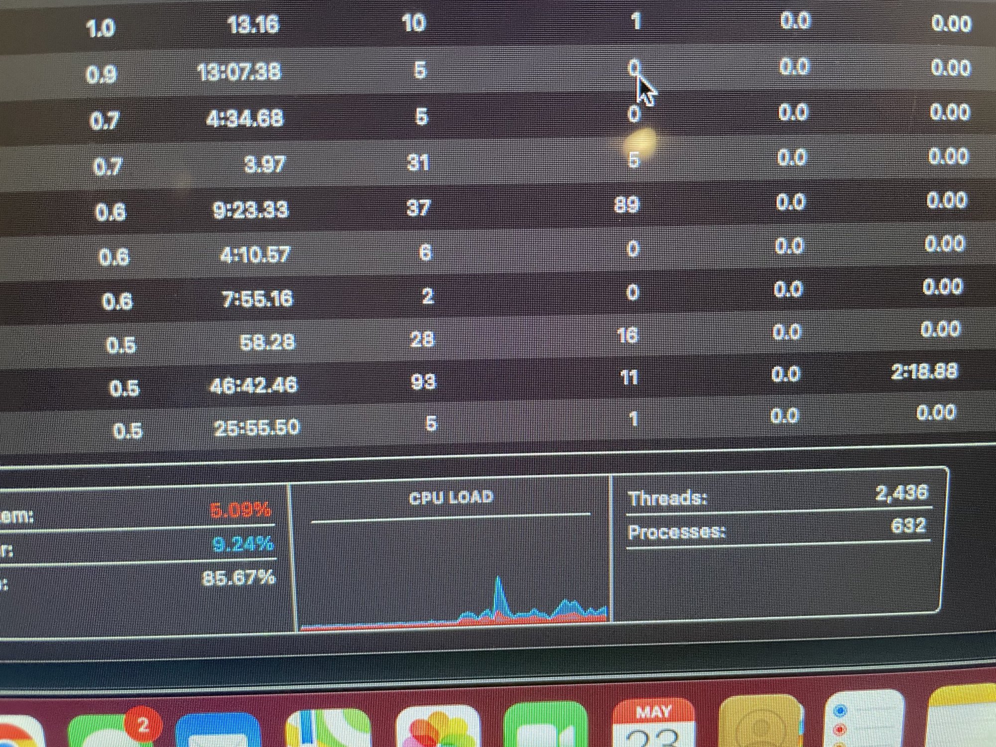

So I bought a used 2014 iMac for my wife. She just reads Facebook and emails, so nothing heavy or groundshaking. Bought it from a local that sells other things.... this was their old POS, they upgraded so I just bought an old machine that would not have been horribly used...
Anyway, it has always seems slow. It was wiped when we bought it, it ran a while (like a day) and we thought it was too slow, so I wiped it, reinstalled.... and it seemed OK... not great but OK....
But really it is just a horrid dog. From a clean power up, clicking on "About this Mac" to the window opening... 7 seconds. Newly started machine, click on Chrome to Chrome opening, 21 seconds....
A dog?
I just want this to run snappier, and I feel it should. OK to reinstall OS, just dont know macs all that well and I dont have a clue what to do....
Attached is image of the task manager during this test- NOTHING is pegging....
Big Sur 11.2.3 21" 1.4 Ghz i5 8 GB 1600 DDR3

That's an underpowered machine but should still run a bit faster than you report. Without more information it's a bit hard to identify where the bottleneck might be. Without much else open, there shouldn't be a memory issue. CPU load isn't high and I get better response from my dual core Air. It likely has a very slow hard drive and the more recent versions of MacOS don't run their best on spinning drives. Swapping the drive for a SSD is a bit of a task. You might consider dropping back to an easier version of MacOS.

I'm terribly sorry, but it sounds like you bought one of the iMac that never should've been.
They were just horrendous value and when they were new, just paying a smidge more could get computers that were 2-3-4x faster
Anyways, as for what you can do with it, the main limitation is the 5400RPM hard drive. The easiest solution is to get an external SSD and install the OS on that. Should make it substantially faster, but not a powerhouse or anything. The CPU is the same type you might find in ultra-slim laptops

Probably because it still uses a hard drive. If you are adventurous enough, consider upgrading the drive to SSD. It will give it a brand new life. I have a base i5 2012 mac mini, and it performs fine with an SSD, handles everything from office and web browsing without issues.

As suggested the 1.4GHz with a slow old 5400 notebook drive was bought out to compete with cheapie PC laptops. Get a Samsung EVO SSD and connect externally via either TB or USB3. The speed of these is about the same, however TB boots miuch quicker.

It's likely due to the fact that you (likely) have a 5400RPM 2.5" hard drive in that machine. The 1.4GHz Core i5 is the same that existed on the lower-end 2014 MacBook Airs, which is to say that it's not the fastest CPU of its day, but perfectly serviceable provided you don't have any other obvious bottlenecks (such as the aforementioned 5400RPM 2.5" hard drive). I'm sure an authorized service provider in your area could toss in a 2.5" SSD that would more than make the difference (and allow Big Sur to actually run smoothly). Though, I'm not sure what your budget is on making that iMac serviceable.
The specs are fine. Get an SSD, external would be fine.
It will be a night and day performance.
APFS has been horrible for HDDs and Fusion Drives, and it has only gotten worse with new OS versions. Get an external SSD, a 1TB for less than $100, and it will feel like a totally different Mac. You can use the OEM drive as a bootable backup, extra storage, or just ignore it.

I have no doubt that your 2014 iMac has the original hard drive, which is the main problem.
If you continue on with the original 5400 rpm hard drive for your system boot drive, then, yes, your speed will not improve.
One way forward is to use an external SSD. That will give you the performance that you hope your iMac should have.
