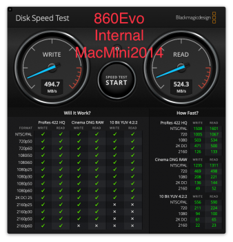

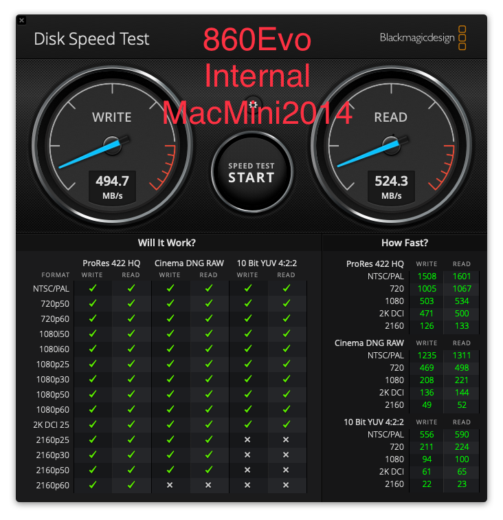

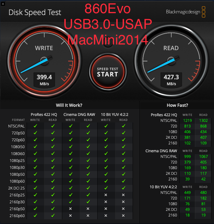

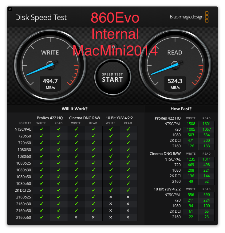

Here's the performance difference between a USAP USB3 cable and internally putting the same SSD in the device (and in both cases, booting off the HDD to get a clear performance indication).
You decide if that's enough significance for you. Note the 860 is limited by SATA3 interface sadly.
