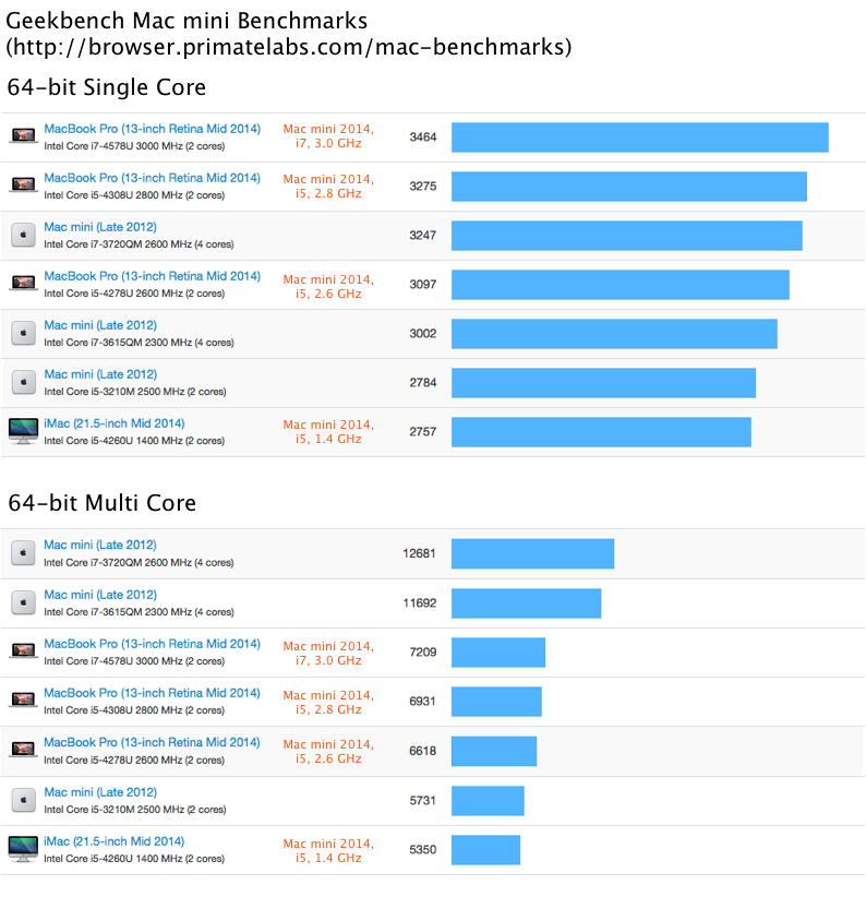

Geekbench scores for:
the 1.4 64 bit scores:
single core :2670 Multi-Core: 5041
the i5 2.6 64bit scores
SC: 3091 MC: 6634
i5 2.8 64bit
SC: 3288 MC: 6999
i7 3.0 64 bit
sc: 3521 MC: 7397
PREVIOUS 2012 QuadCore
SC: 3312 MC: 12960
