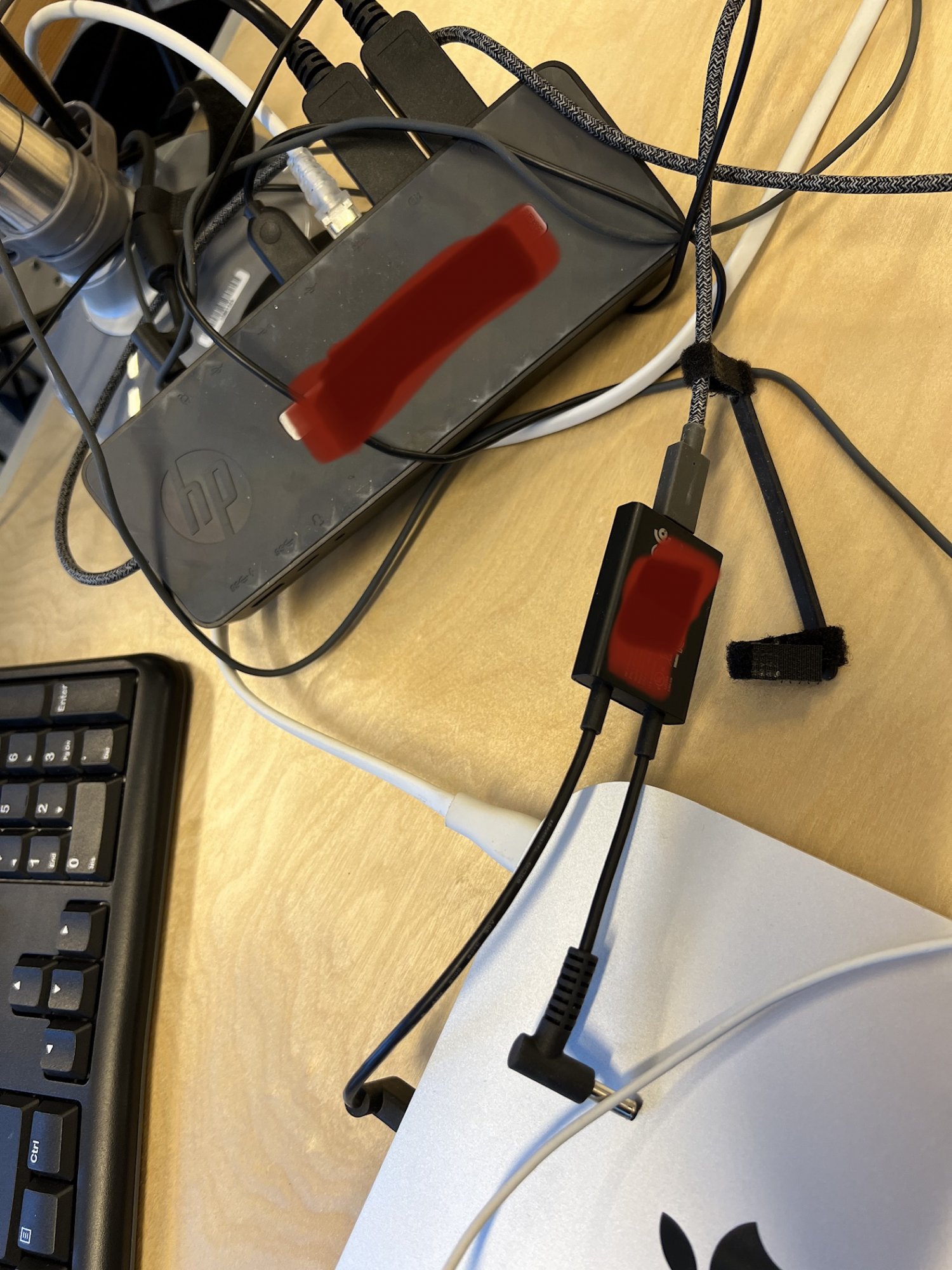

I found a similar adapter at work. I plugged it in and nothing happens. Is there any steps I need to take once I plug it in?

But my picture is showing an adapter that is USB 3 not working.

Your Mac does not have the ability to do video over USB period. Regardless of what adapter you have, your computer has USB 3.1 Gen 1, or as it was called in 2014, USB 3.0. It does not support DisplayPort over USB no matter what adapter you try to use. The only way that is going to work is to use a Thunderbolt 2 to Thunderbolt 3 adapter and then you can plug in your USB-C cable into that and get video over it.
