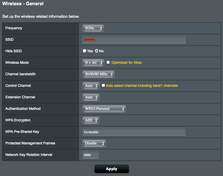

the only option is N +AC

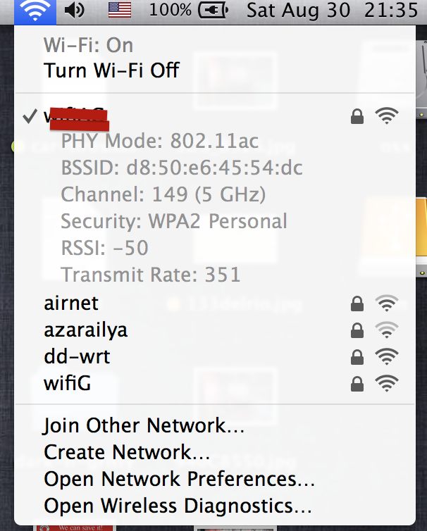

changed the forced N+ AC to auto and the transmit rate only increased to 350

It looks like an issue with signal strength from your router. It's connecting as AC wifi, it's just not getting a high enough quality signal to negotiate speeds closer to the AC cap. Either interference or the number of devices on your network or crappy antennas on the router are probably resulting in a signal that is not strong enough to establish a higher speed connection.

the issue with latest FW on RT-AC68R - 5GHz was in AC + N mode. Has to be in auto. Signal strength is an issue - going through few walls - therefore the reflectors i put on the antenna. Initially what was bothering me is that 2012 connected at 450 with no help. 2014 only about 300. 2014 must have weaker airport card.
