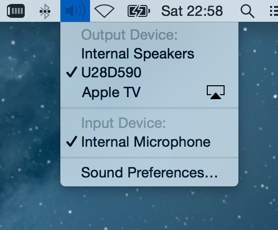

What kind of display connection are you using? If you are using HDMI or DisplayPort, that may cause the problem, since these can carry digital audio as well as the video signal. It does not matter if your display has no speaker connected, the operating system may still be routing the audio to your display. Volume control is not enabled if the audio output is digital, that's why the volume control icon is grayed out.
If you press option (alt) while you click on the volume icon, you can change the default output from your display to the built in analog output.
Hope this helps.

Thank you. I had already unplugged/replugged my speakers 3.5mm so I can't see what was chosen when grayed out but it is showing both monitors as sound output options so that is probably it. Why does the OS flip my sound output to the components that are sleeping? That makes zero sense. How do I force it to always go to 3.5mm out? Or maybe I'll have to plug my speakers into one of the monitors, which seems silly but may be a workaround.

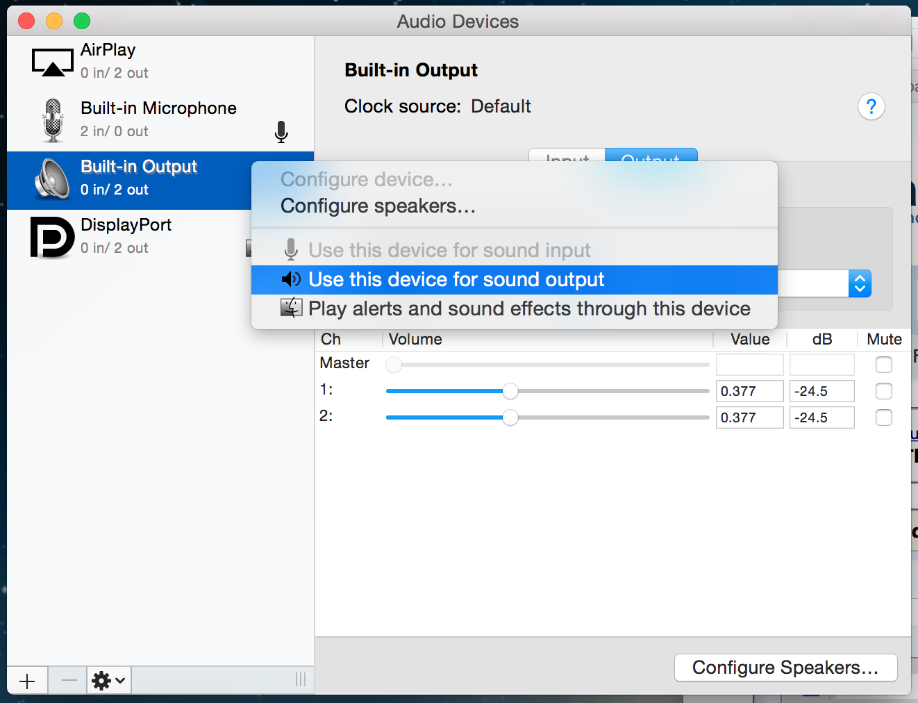

Plugging my speakers into one of the monitors is absolutely not a viable option. Even though it works, the status bar icon is grayed out and my volume control from the keyboard stops functioning. Do I REALLY need to buy TWO MORE adapters to go DP-to-DVI instead? How dumb.
You can change the default sound output in two ways:
- Alt+Click on the speaker icon and select the desired output
- Open the "Audio MIDI Setup" and right click on the desired output in the left panel - you can set an output as the default there ("Use this device for sound output").
