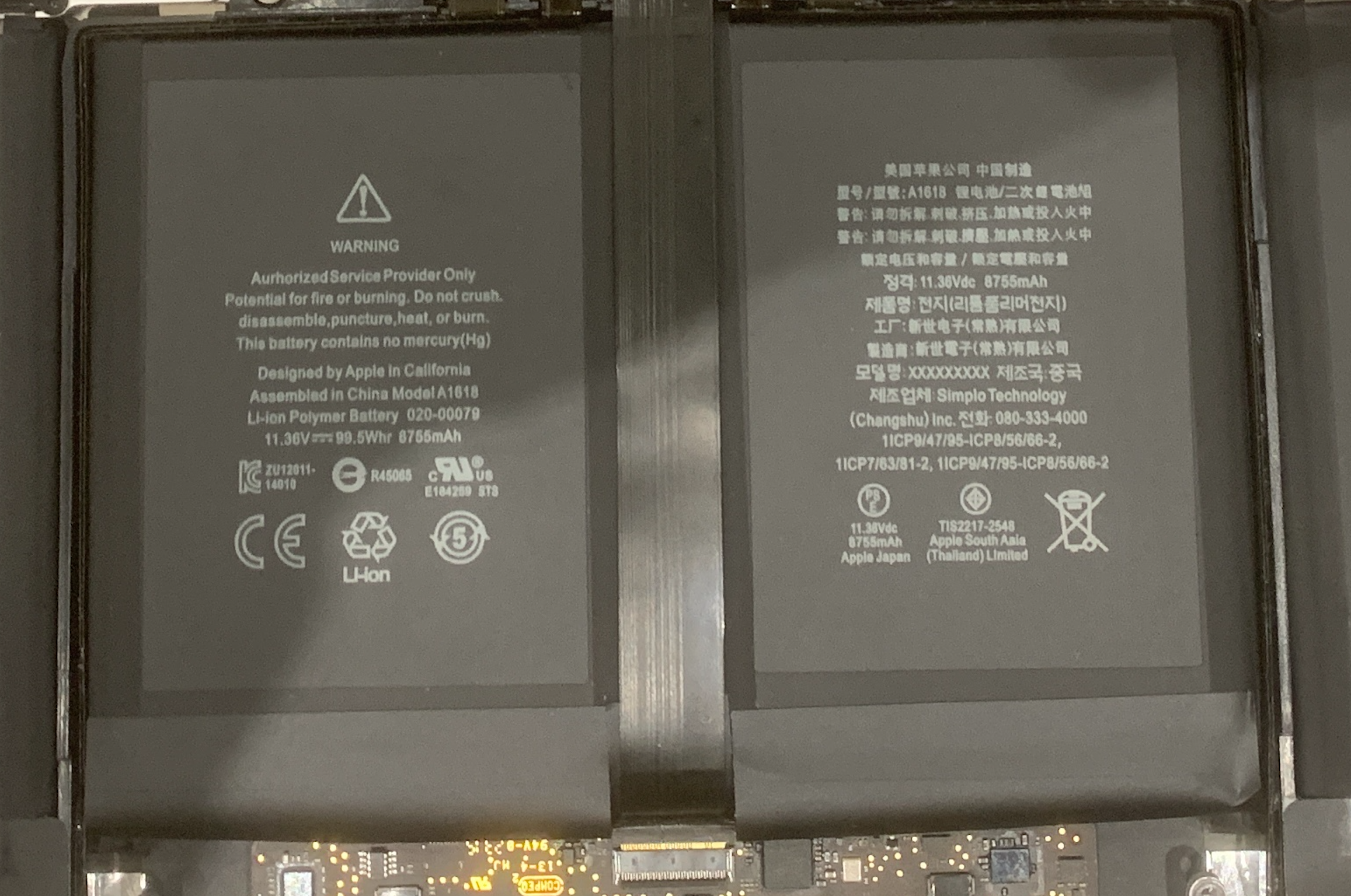

Last year, I had my A1398 Mid 2015 rMBP Battery replaced by a colleague who repairs Apple Stuff. Sadly, despite it being an genuine/original battery (made by SMP who I believe Apple use & with the very exact same markings as the original factory installed one) there were issues from the very start. The full battery calibration was done but the battery could never ever be run for more than a few minutes without going dead & the "Battery Needs Servicing" message was present.

It does appear to be the correct model number and specs.

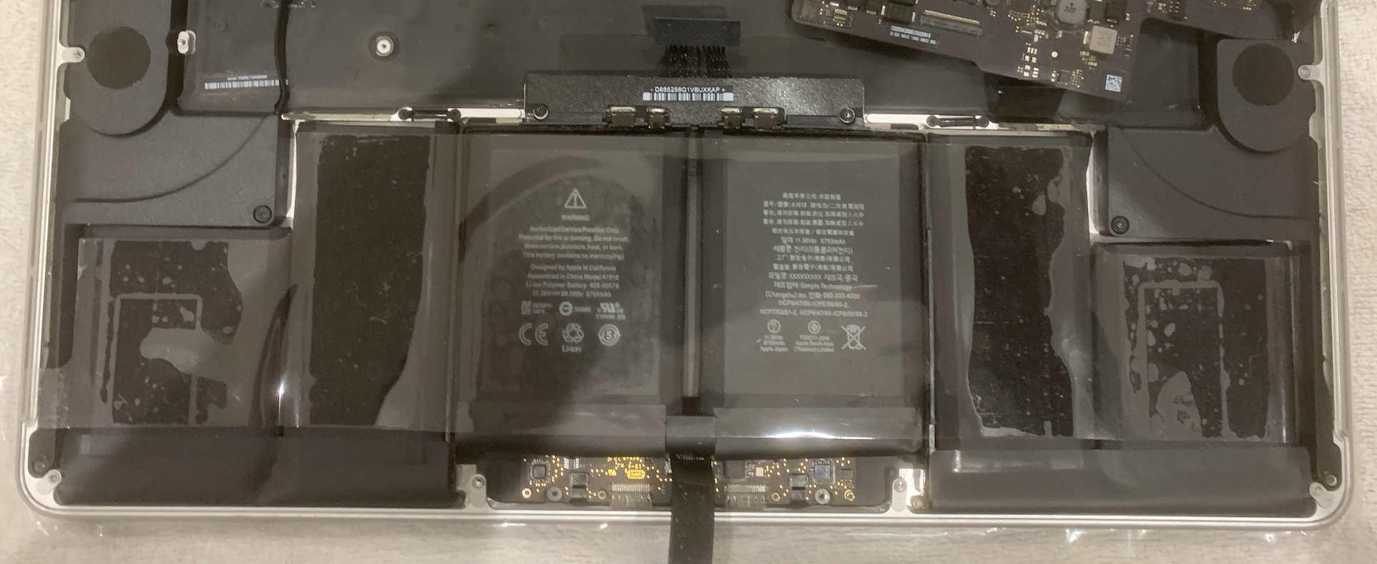

Something strange but wonderful has now happened. Although I was fully sure that the battery connectors etc were all fully seated when I installed the new battery, out of desperation, I thought let me just check again & opened the MBP up again. Yes, I was correct - the battery connector was firmly & fully seated to the logic board - there was no room or gap between the connector & logic board.
I then just pressed the connector down a bit - no idea why I did that as if that would change anything & then just resigned myself to the fact that I would need yet another new battery & screwed the bottom case back on & restarted the computer.
I could not believe it - everything was now showing fine - all the Battery warning messages disappeard & the battery is now showing Normal. I was still suspicious so I ran the Macbook on battery power alone a couple of times & it did in fact run for a few hours from 100% rather than the 2 or 3 minutes like last time before it went to zero.

Your latest description sounds like one of the connectors is faulty, or at least intermittent.
It could be the connector on the battery, or the connector on the Mac. There's no reliable way to tell, except by trying different connectors. On the battery side, a simple way to do that is to try different batteries. If they all behave the same, i.e. if they all charge and behave badly, but are suddenly cured by pressing hard to seat the connector, then that suggests the faulty connector is on the Mac. If they behave differently, then that suggests the faulty connector is on the battery.
This isn't a definitive diagnostic method by any means. It could be that the actual problem is the battery connectors are all out-of-spec, and are sourced from the same crappy supplier, so they all fail the same way when connected to the Mac. The Mac's connector could actually be perfectly fine, but all the crappy connectors fail identically, such as by not making solid electrical contact with the Mac logic-board's contacts.
I'm not a Mac Jedi, or even a battery Jedi, just someone who has years of experience in working with electronics. Bad connectors are a well-known source of intermittent problems, and diagnosing exactly what's wrong can be difficult.
The problem could come and go. If the connector gets warm and expands, it could worsen the electrical contact. Any vibration, such as travel or just moving the MacBook around, could worsen the electrical contact. Or it could work just fine for years.
