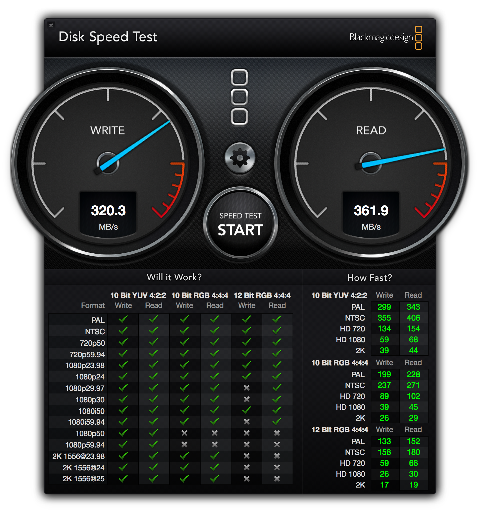

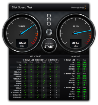

But here is a speed test for an external SSD connected to Thunderbolt:

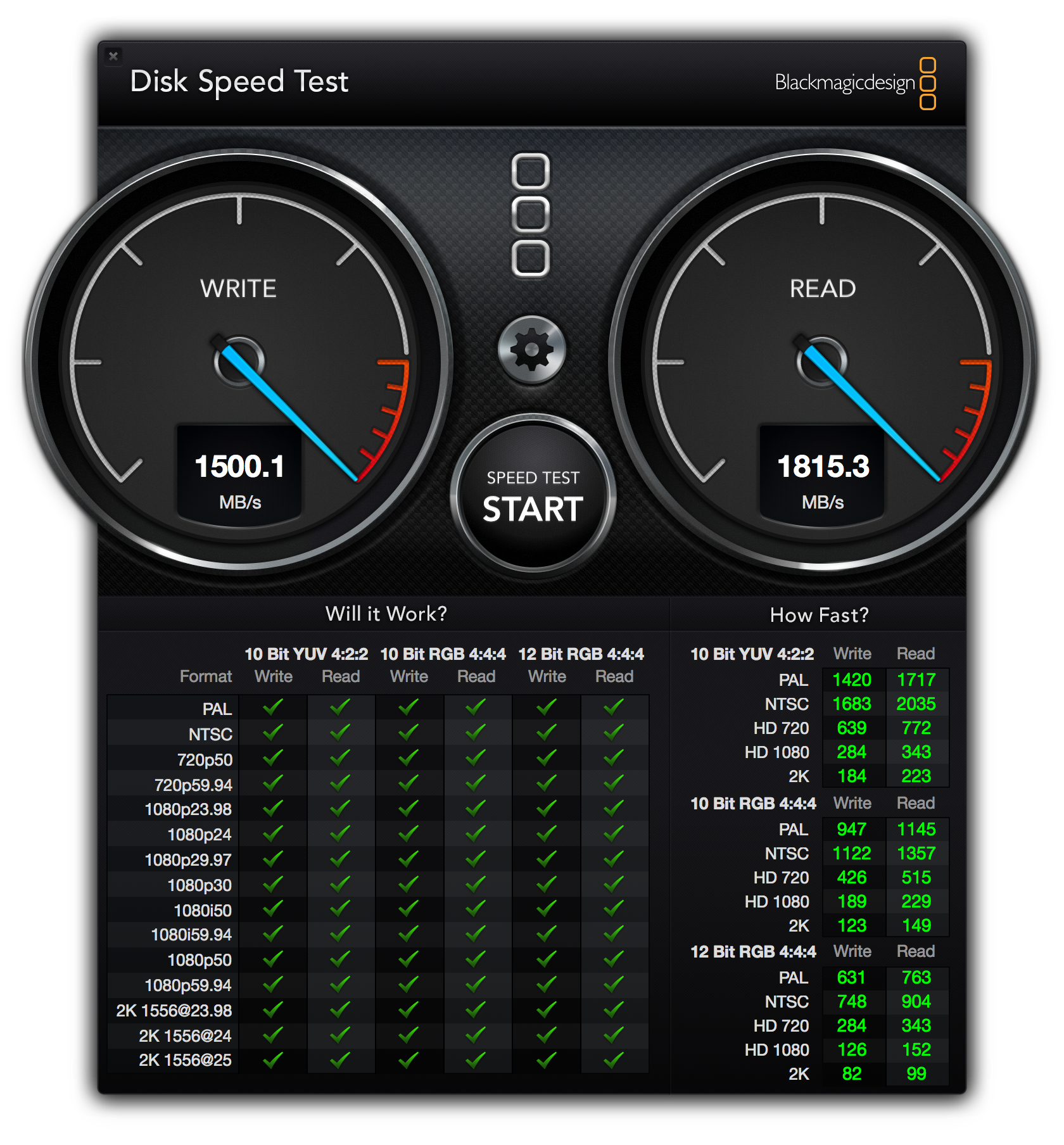

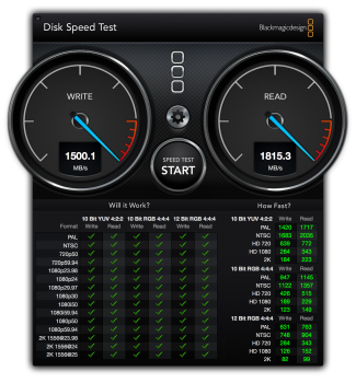

And that's the internal SSD:
You would be spending more than $100 for an external boot set up. The 1TB Fusion drive will yield results nearly identical to the external test that was posted above. Gains would be minimal and ultimately it would be more costly and less conveinient.
Few people need 1500MB/s. 300+ gets most things done very quickly.

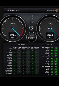

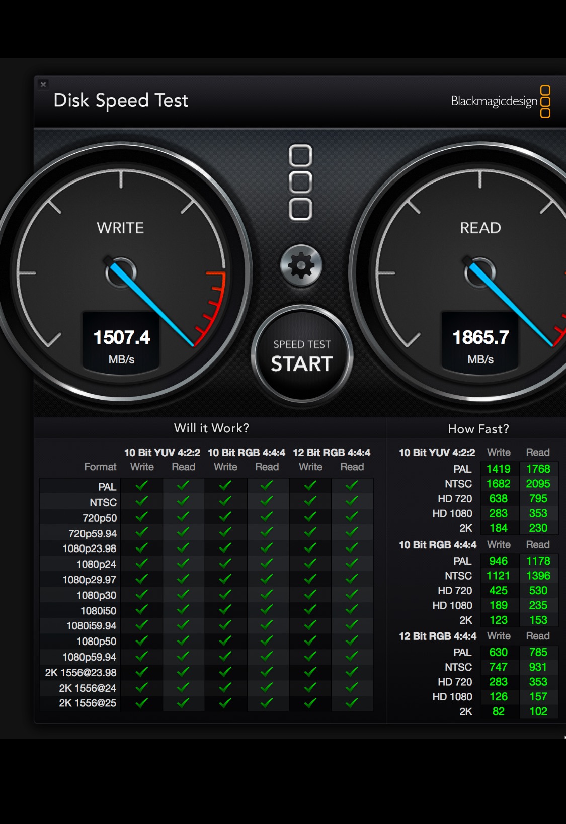

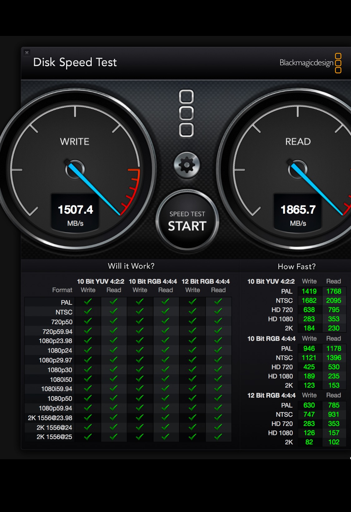

like you, I was tempted to get an external TB drive for boot. After weighing in the cost of a TB LaCie little disk empty TB2 enclosure and 500gb ssd, I decided to go with the internal PCI-express. I can't express how amazingly fast the internal ssd is.
This was a test on my ssd whilst having chrome, safari, transmission, and handbrake running. Running my external Samsung ssd via usb3 I get 550 mb/s read and 500 write. Now the internal ssd is 3-4 times faster than usb, and I have no regrets about spending a few extra $$ for the 500gb internal pci-e ssd. I have my Mac storage on one half, and windows running on the external ssd.

navaira asks above:
"What SSD gets 1500 MB/s and 1815 MB/s speeds?!"
The new PCIe-based "blade drives" that come factory-installed from Apple do.
Far, FAR faster than ANY external SSD you can add, thunderbolt or USB3-based.
