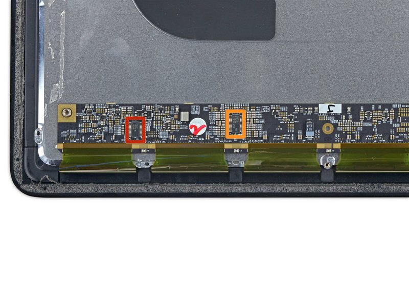

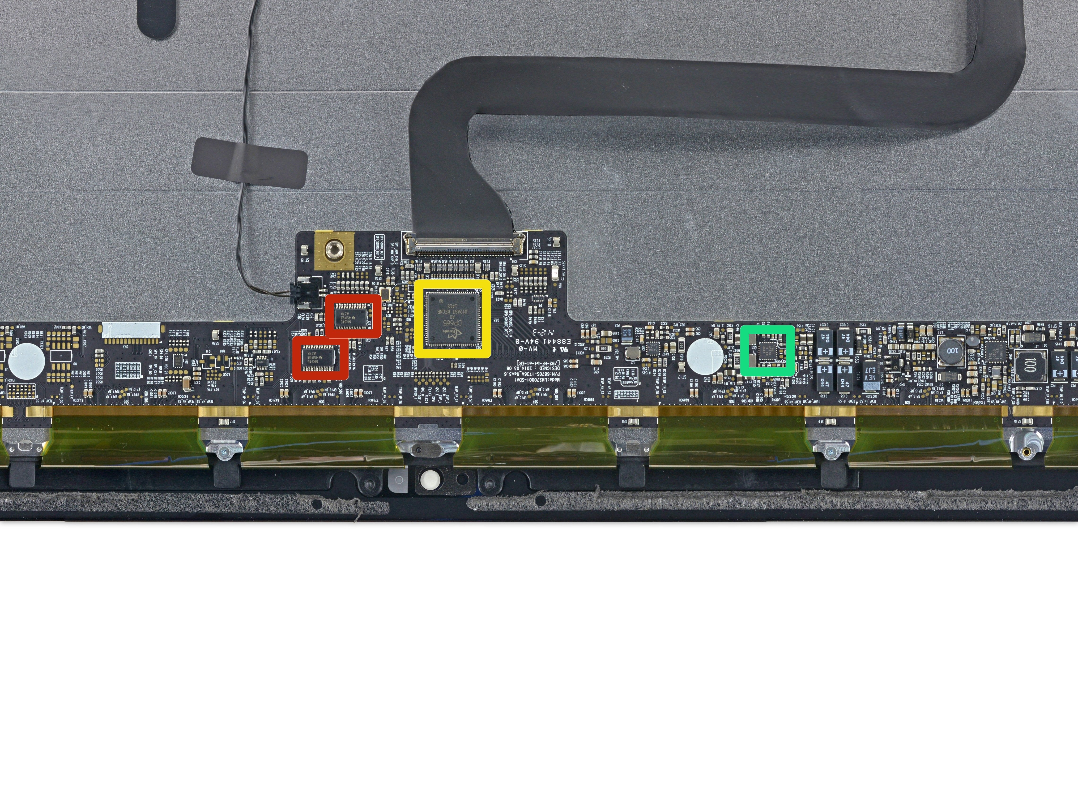

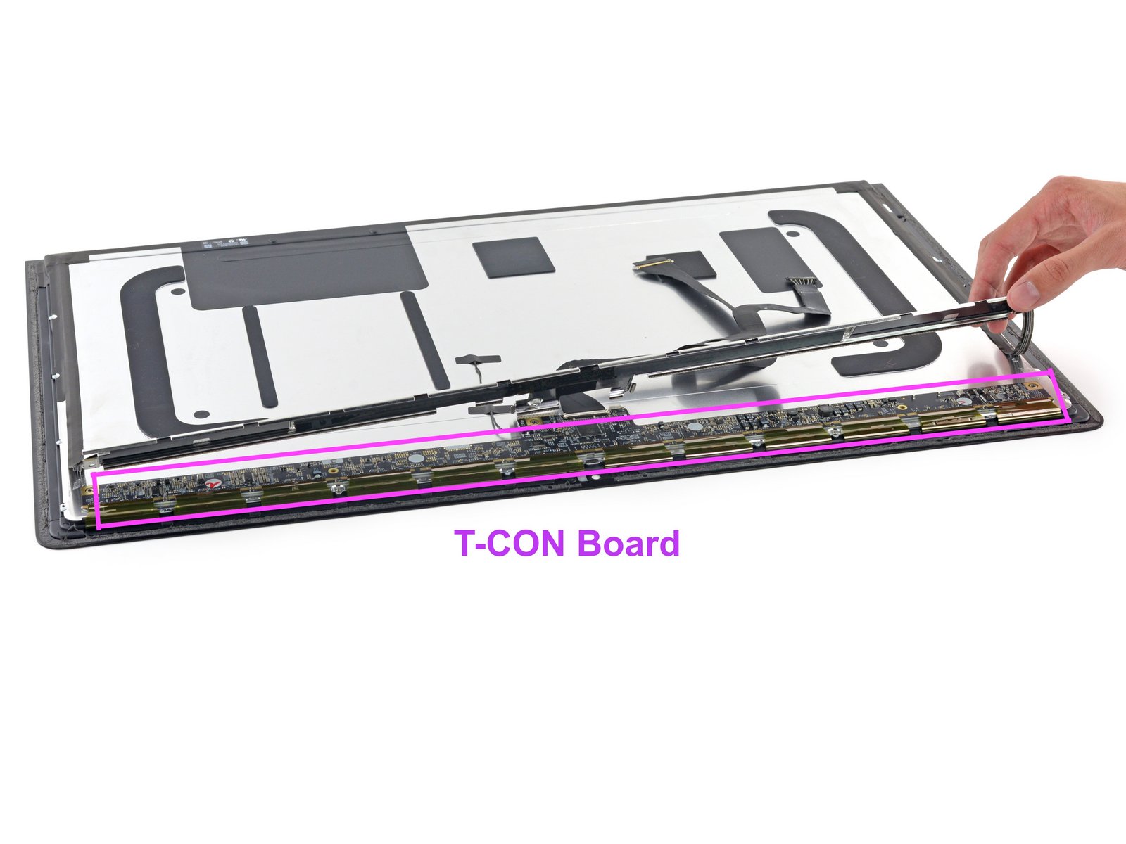

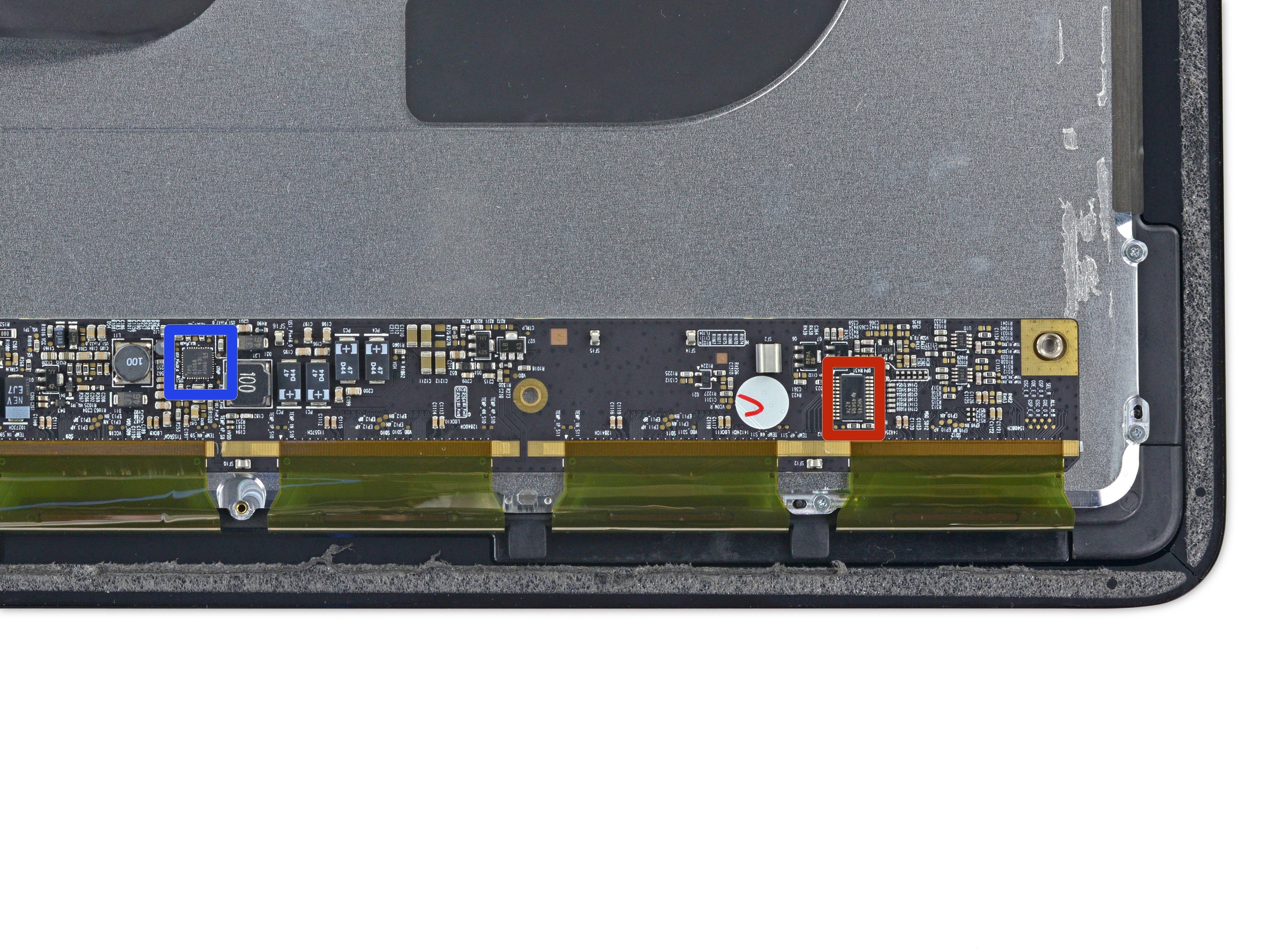

The information I have so far is that the T-Con board can be easily damaged and the issue would be one of those chips on that board - but which chip and why that happens is still a mystery to me:
