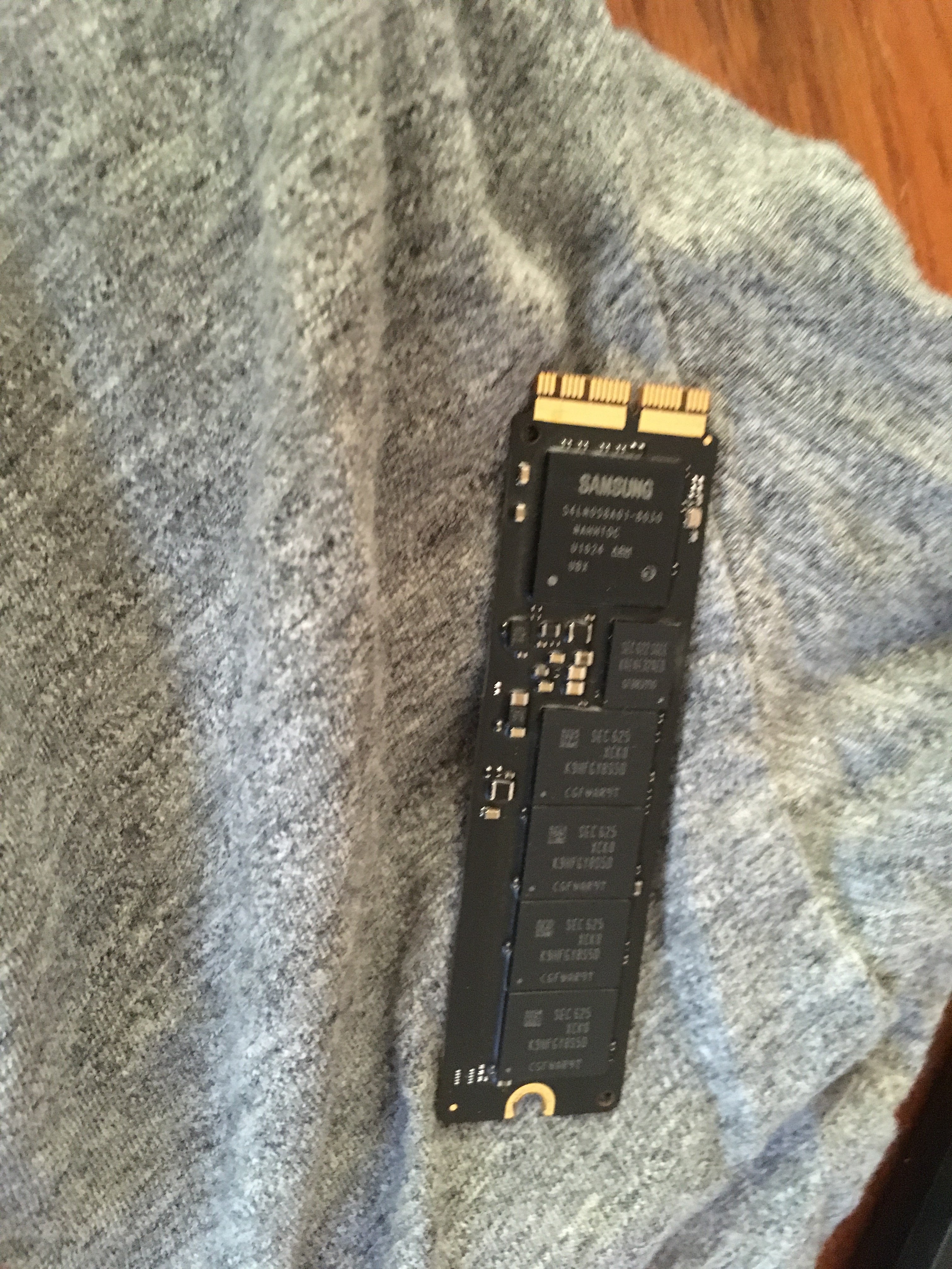

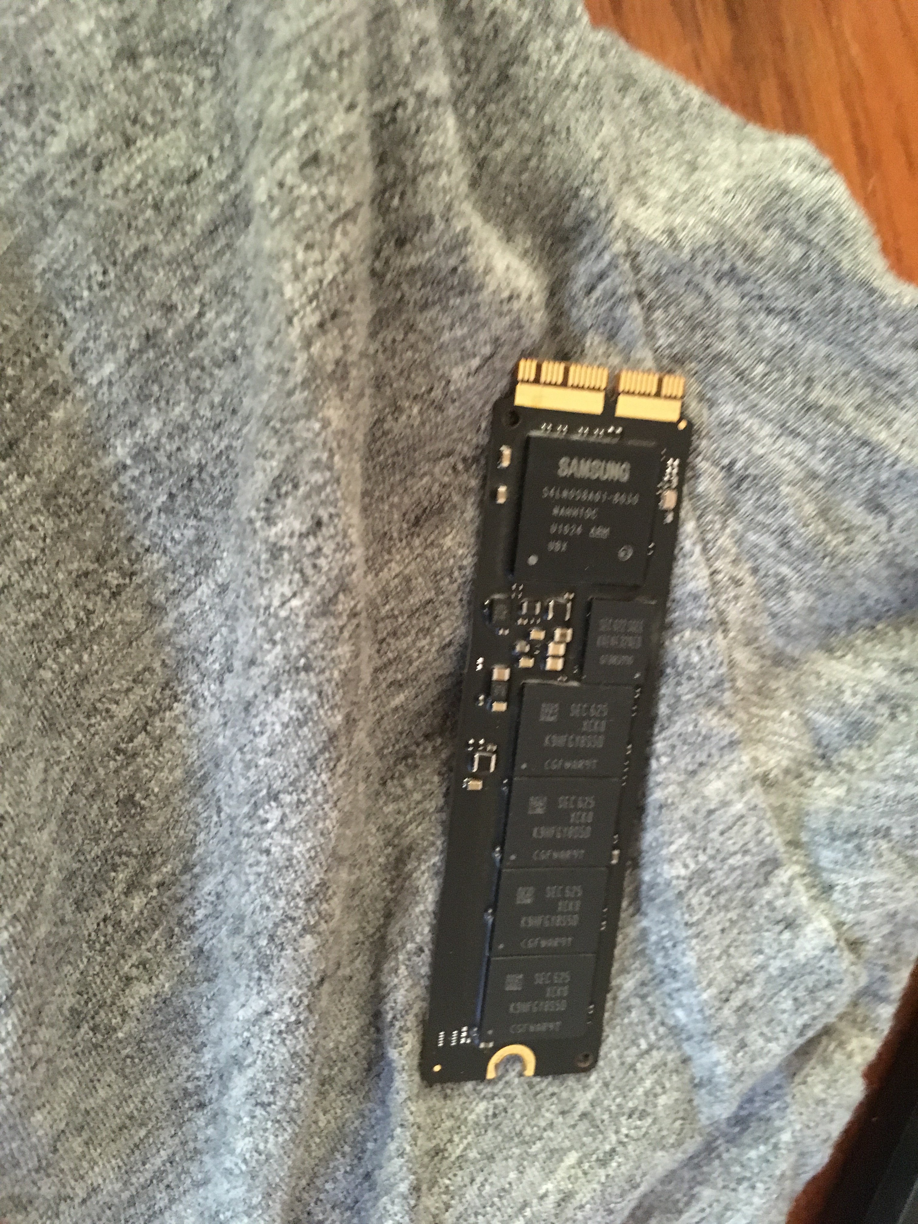

  2. Remove the old drive by removing the single support screw.
  3. Install the adapter. I found it was easier to fully seat the adaptor without the new SSD attached to it.
  4. Install the new SSD into the adaptor and secure it with the new longer support screw provided with the adaptor.

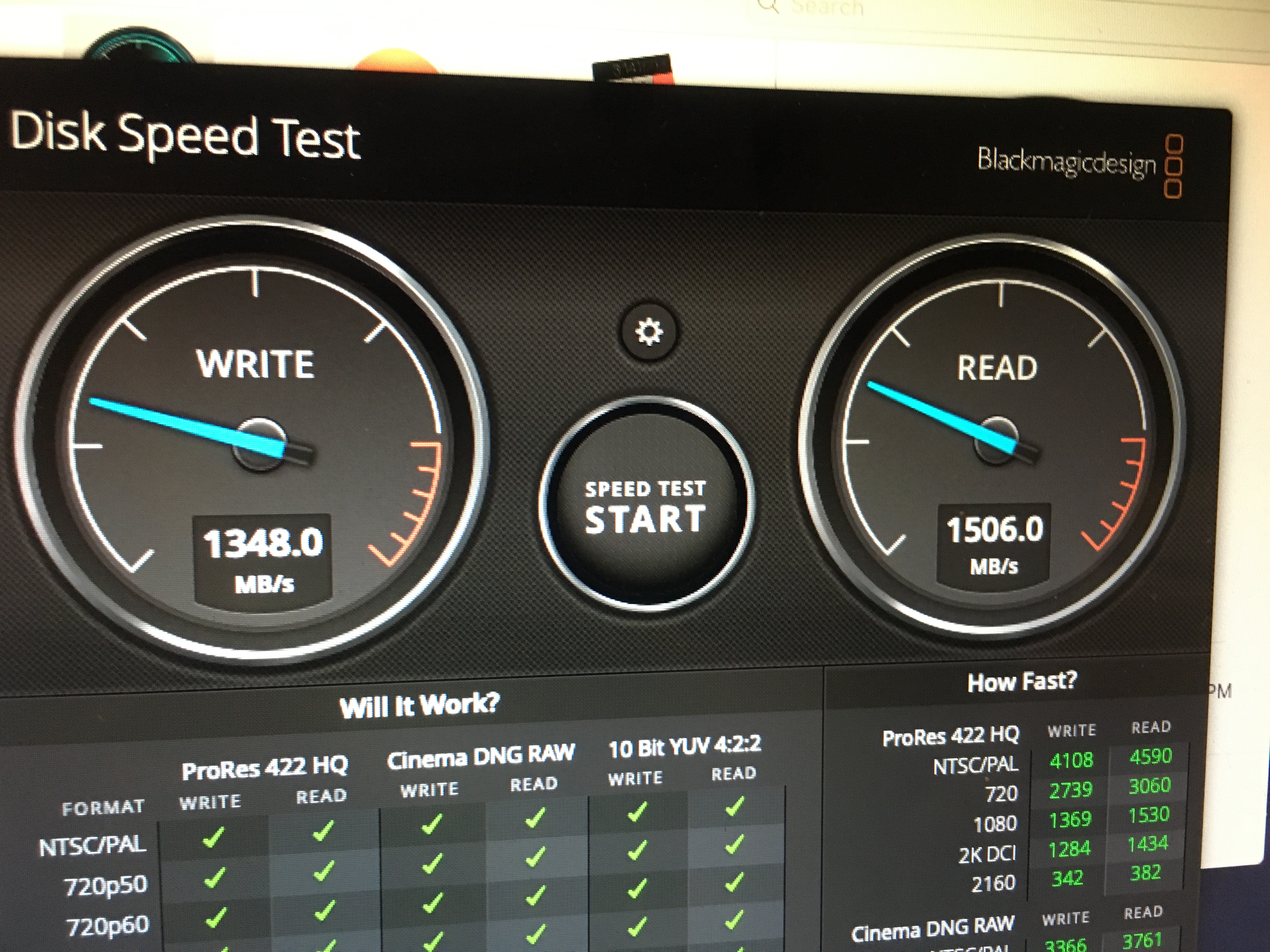

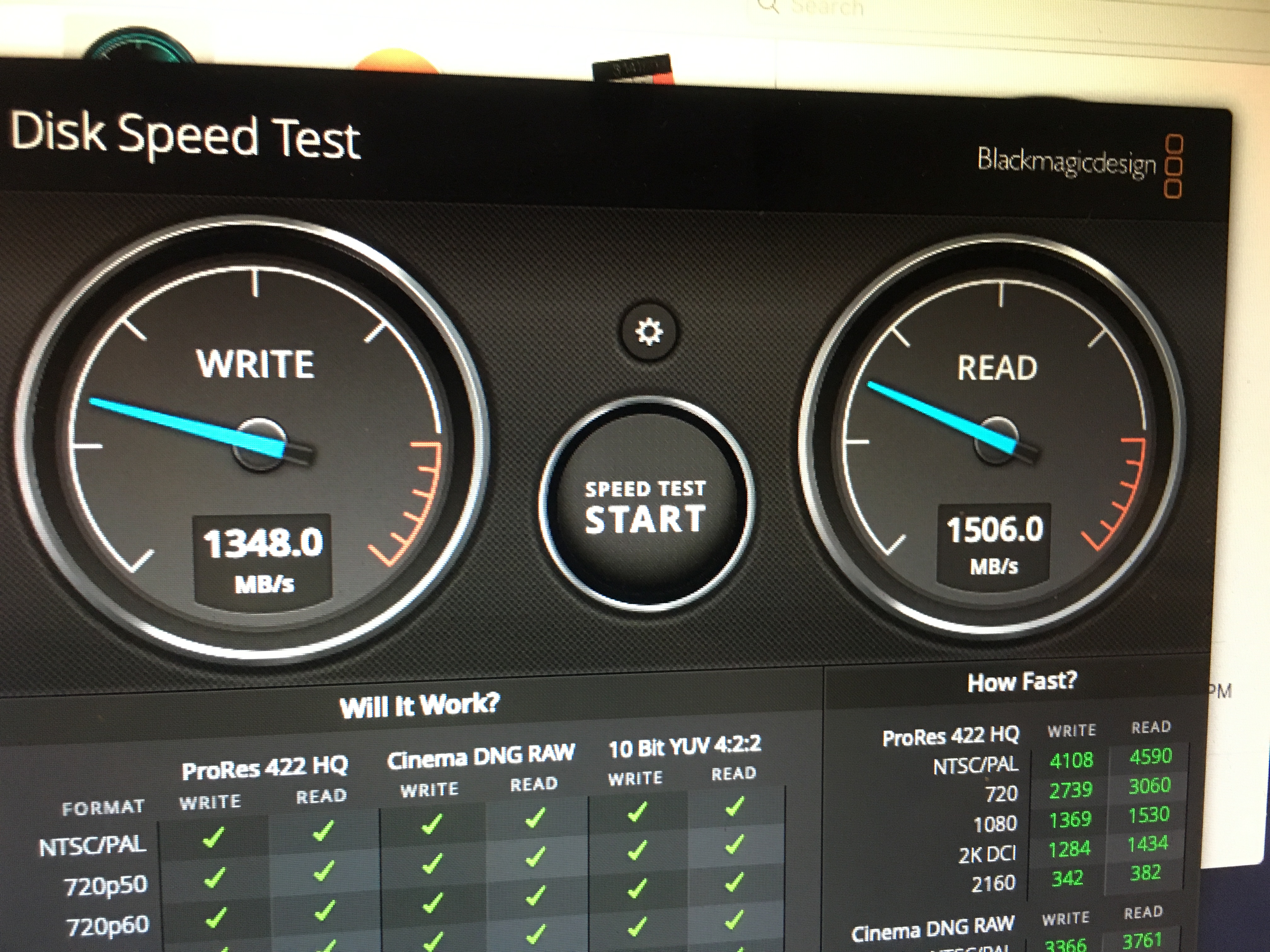

Read speeds 1500MB/s
Write speeds 1350MB/s
SSD temperature 40C plus minus 5C
