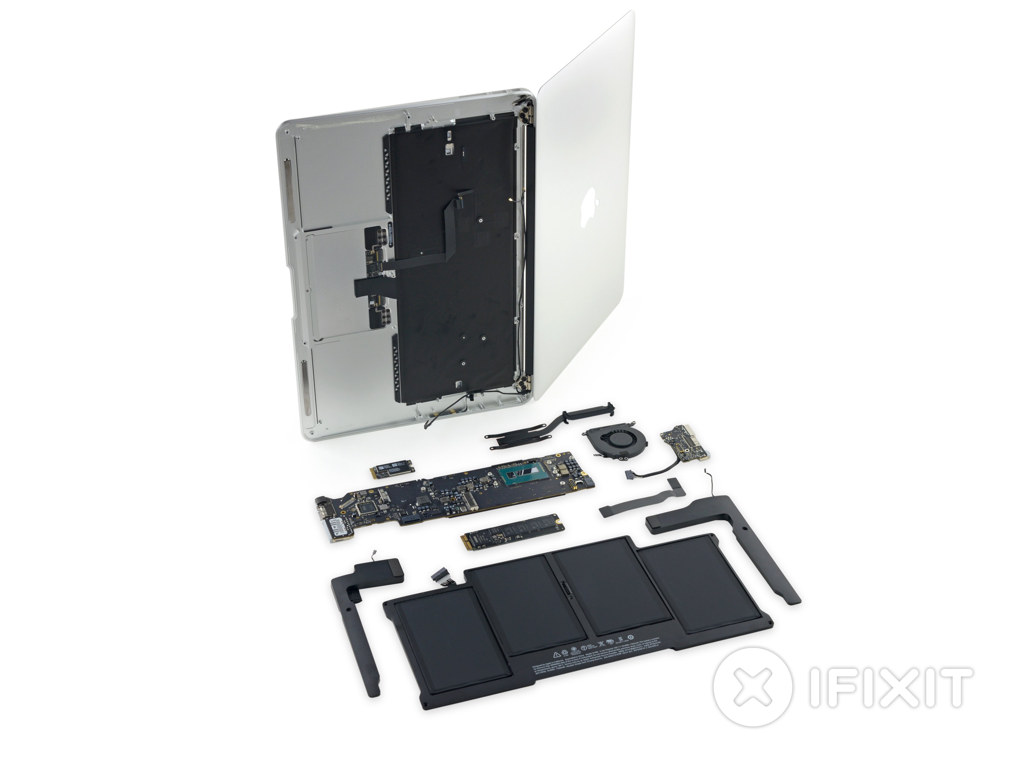

There is a center screw that adjusts how much play you have on your trackpad. Sounds like you need to adjust the screw. Take a look at the trackpad replacement guide found on the ifixit website. Link provided below and then go to step 10 to do the adjustment. This guide will list tools you will need to do the work. If you don't have the tools you can easily get them from this website as well.
It is very easy for you to do this yourself. You don't need any Apple store tech to do this when you can save the money and do the adjustment/repairs yourself. It is not hard to do... if your trackpad is faulty then that is also easy to replace using this guide.
