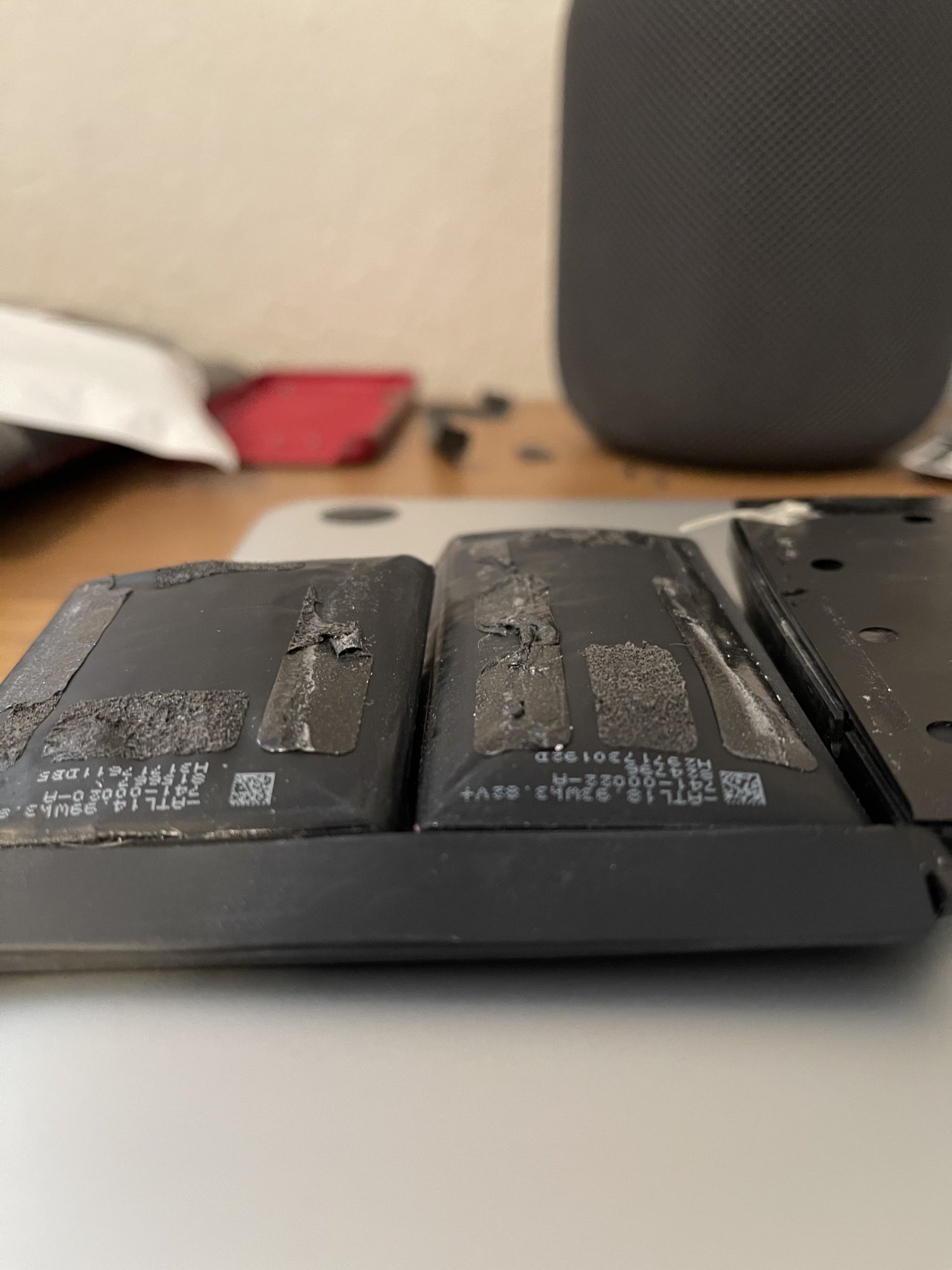

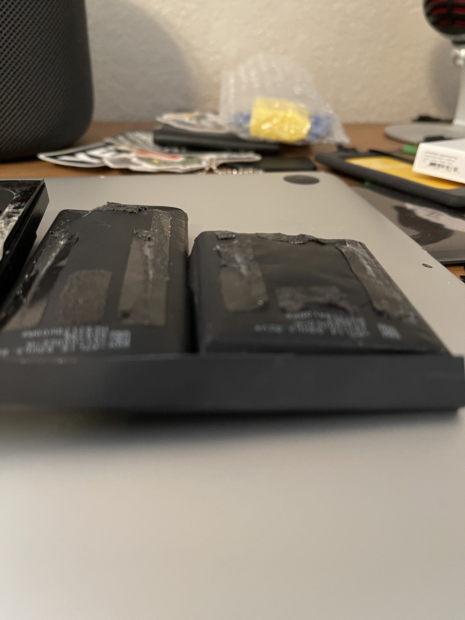

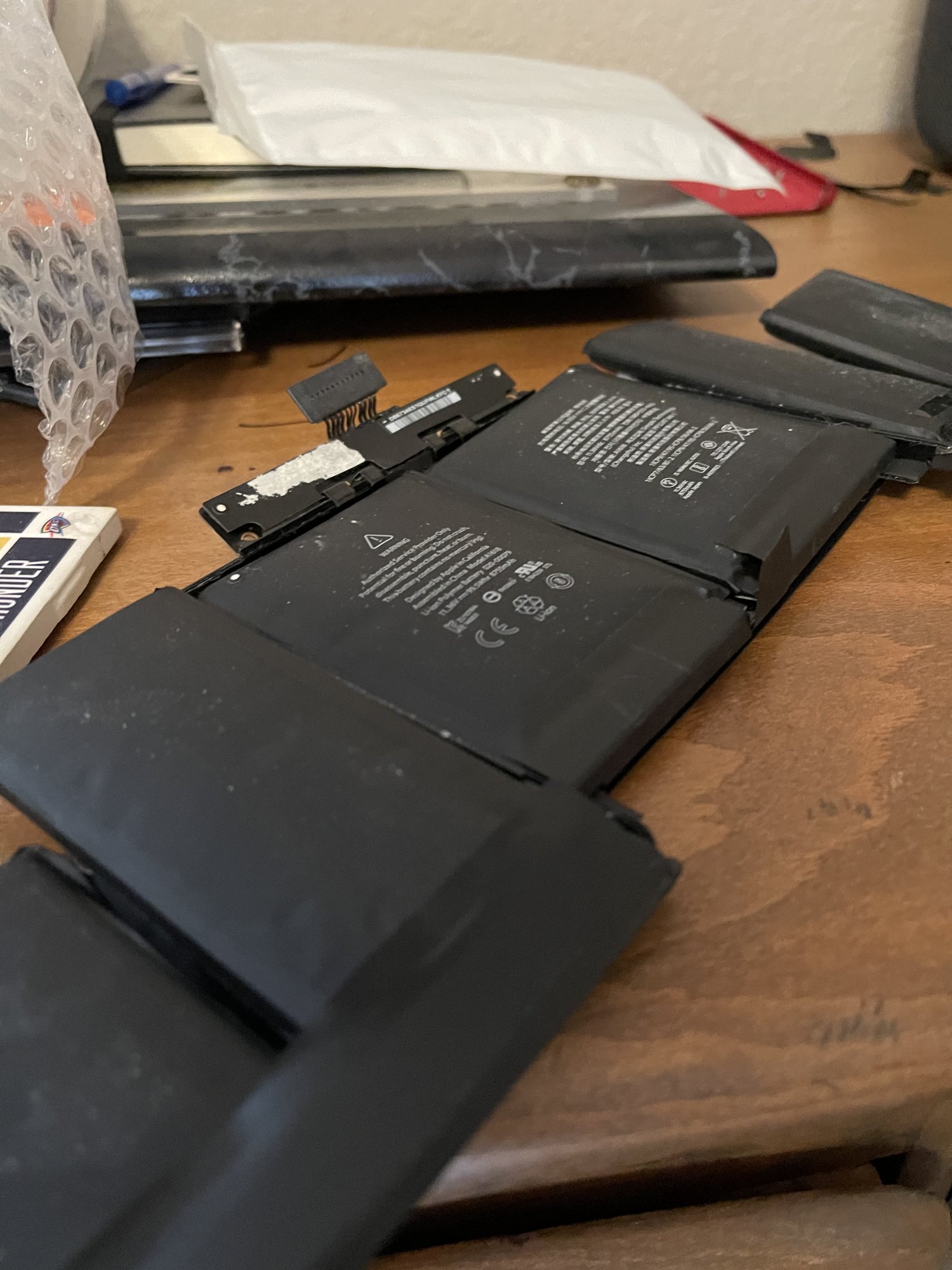

As you can see the battery was swollen. Took less than 30 minutes remove. The adhesive was already pretty weak, so it came out without much work. I just used a plastic pry tool that came with my screwdriver set. New battery arrives Wednesday.
Like i stated in OP i just bought it used. Talking to the previous owner he kept in clamshell mode using MagSafe pretty much at all times, hence the low battery count of 255. He also used it for his development job. So, he never experienced any issues since he had it in a stand most of it’s life.
Lesson, use your laptop as a laptop throughout its life
