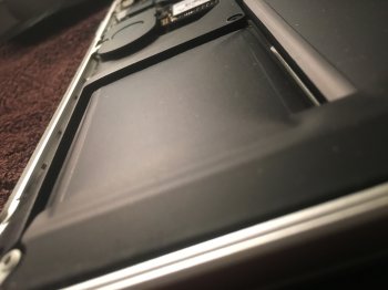

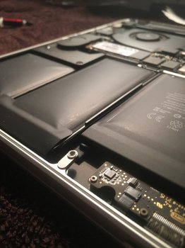

I opened my 2015 15" retina today to repaste the thermal paste and noticed upon reclosing the 2 tabs on the bottom don't click into place.
I noticed also, that my battery is possibly swollen - on a 2.5 years old machine. I took some pictures for evaluation as I can't determine wheter my battery is really swollen or it just looks like it. I can slightly press on the battery.
Is the battery supposed to be completely flat when new?
My machine is a desktop replacement and constantly connected to power.
Definitely swollen. Take it into Apple. They can do a top case replacement (battery, keyboard, trackpad, and Al plate). Some people have been able to get it for free on 2015 models.

I showed the genius my Macbook Pro and told him the undertray can be pressed in the middle where it's supposed to be solid. He asked if he can check in the backoffice.
After 10 minutes he came back and told me the battery is indeed swollen and needs replacement.
So I get a new battery with topcase. Free of charge, covered by Apple Care.
