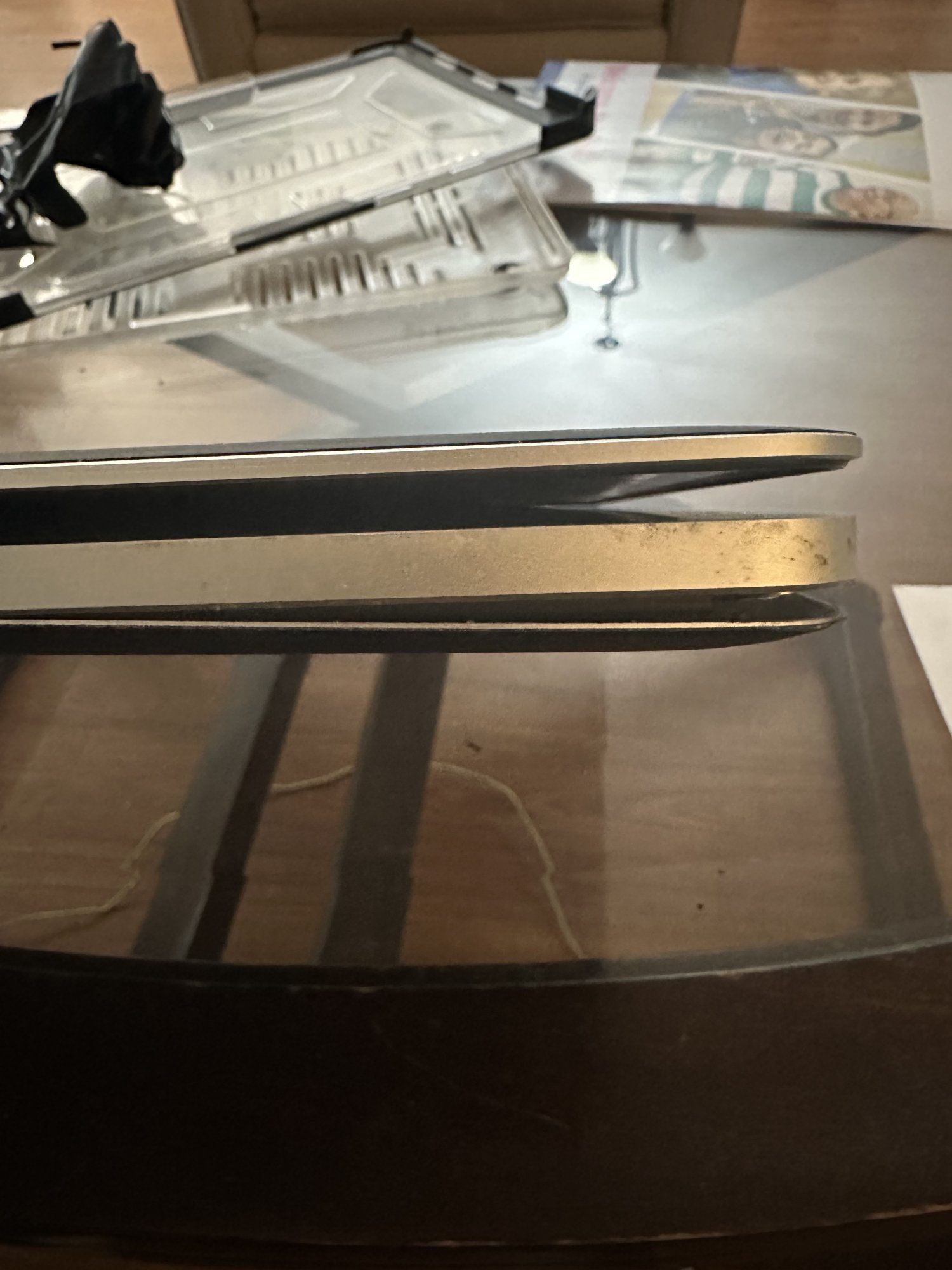

Thank you all for your responses and advice. After reading through I was convinced of the battery replacement route made an appointment at the local Genius Bar and started getting the laptop ready.
I took the case off and only then saw the true extent of the swelling (picture attached). It seems the lid is left open quite a bit because of the swelling and the bottom cover has popped out in one corner.
Again everything seems to be in working order at the present time but I’m unsure what kind of damage has been caused thus far and if replacing the battery is now still the right course of action. Thoughts?
For anyone who replaced their battery was your case this bad?

Probably makes sense to take it to the Apple store and they will evaluate it for you. If something is damaged they will tell you. They will run a full diagnostic before the accepting the laptop. I think if they encounter a problem during the battery replacement they will not complete the battery repair and return laptop to you -- I think that is how it was explained to me. So I do not think you have anything to lose by seeing what they say. Be sure to back up your data in any event.
If they say you need a new screen or logic board, etc., I would just take the laptop back and research Plan B on a new purchase. I would not put any further money into it other than the battery service if it was my laptop.
The 2011 I fixed was similar, but the bottom lid didn't pop out. The trackpad had been pushed out of the case from below and was preventing the lid from closing. I had seen mildly swollen batteries before, but this one was severely swollen. It looked like for sure either the case was deformed or there would be mechanical damage. To my surprise, everything popped right back in place (with a little encouragement) once I removed the swollen battery.
I know you're dealing with an rMBP with the scalloped battery so removing the battery isn't an option, but you could remove the bottom lid, disconnect the battery, and plug the laptop into a power source and see how it's running. It should run just fine without a battery (but it must be disconnected).
Yeah concur here. The main reason I'm favoring a battery replacement is because I incur so much pain in time lost and frustrated phone calls if I change anything that one of my tech challenged parents are used to, but that's assuming there's no damage to the machine. If the machine's damaged then I probably won't be able to avoid that day when I have to ask them to try something different so I might as well bite the bullet and do it when I have some semblance of control over the situation.

Indeed, the Apple technician told me that the batteries are designed to swell for safety purposes. The bottom of my laptop was slightly bent and the trackpad was not functioning optimally when I brought my computer in -- due to the swelling. When I got the laptop back it showed no signs of this wear.
I replaced a battery in a late 2013 rMBP that was at least as bad. I don't know what the 2015 procedure is; I can tell you that about 80% of the delicate disassembly that iFixit suggests for the late 2013 is unnecessary. Some careful work with dental floss and judicious use of the adhesive dissolver did the trick for me, took about an hour all told.
BTW the late 2013 will run without a battery, but performance is horrible. Apparently the CPU turbo function is effectively disabled without the battery. I found this out when my replacement battery died (mostly my fault, the replacement adhesive didn't stick well and flexing broke a connection; for the second replacement I ensured that the cells couldn't move, using bits of foam). I suspect that the 2015 might be similar.
