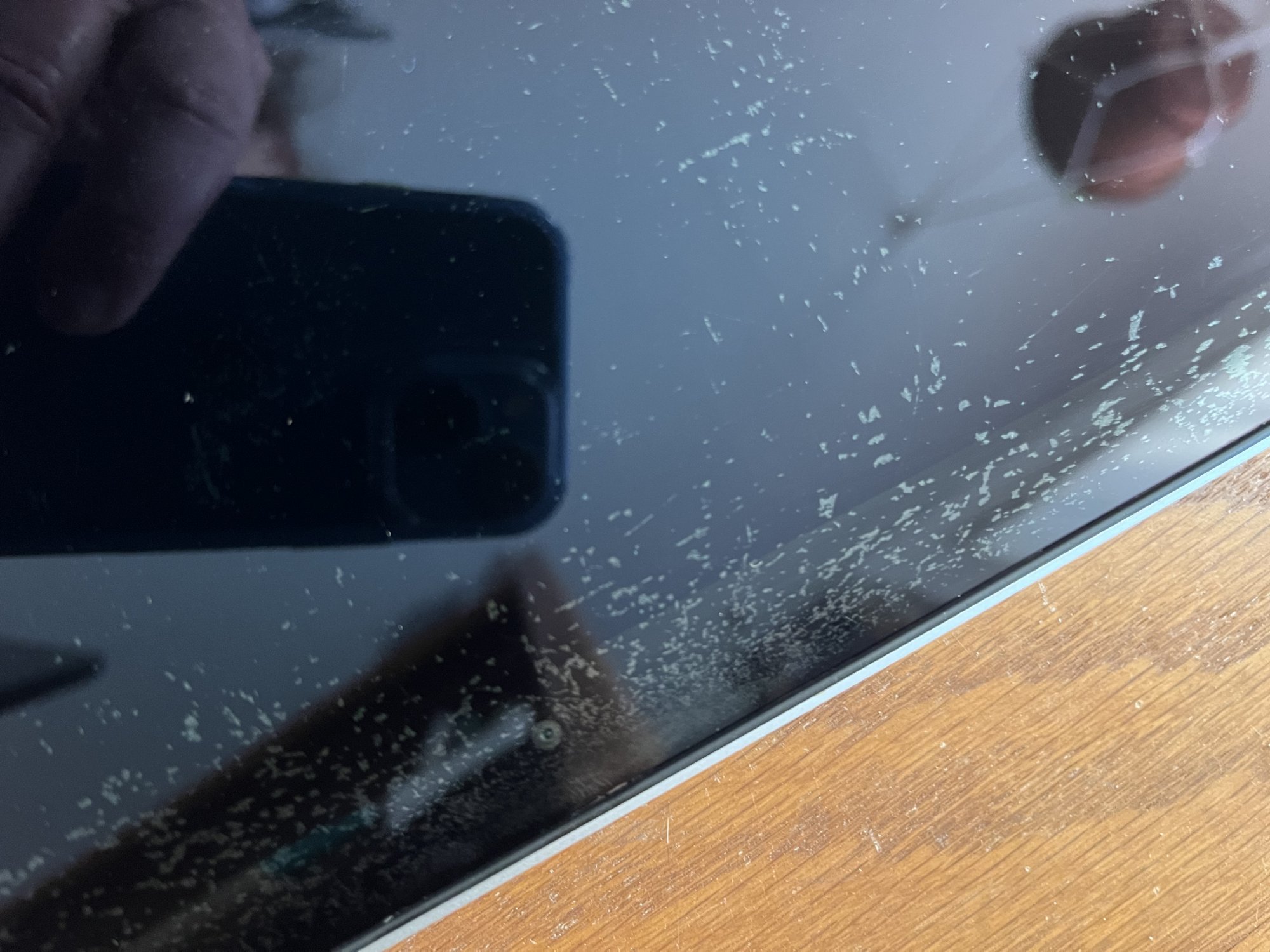

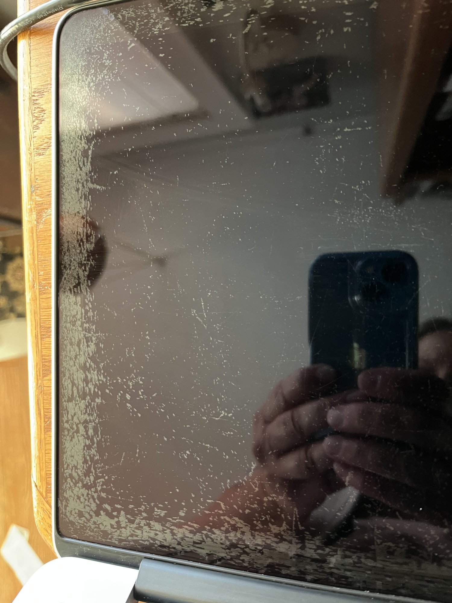

I bought this machine new, May 2015, with AppleCare (now expired).
Monday I brought it into Apple for a new battery. When I got it home late Tuesday, I noticed swish marks across the screen. They had used something wet to clean it and didn't wipe it off well. I tried to get it off with the cloth that came in the box, but could really only get the center clean. Yes, we had it open and booted before I left the store, but the lighting was such that it wasn't apparent. I *could* see that they had cleaned the screen as I tend to leave fingerprints all over, but I didn't see the swipes until I was back at my desk.
I went back in today to ask them to clean off my screen. He whips out an alcohol wipe, wipes it all down again and announces it's delaminated. They claim they can see a bit of it in the pix they took as I gave them the machine Monday (and did not send me the pix as I asked, so I will need to make ANOTHER trip up there, and am fully annoyed by that).
I do have a couple of pix I took Tuesday as I was installing a new router, and can't really see the delimitation in them. What I see now that the screen is fully "cleaned" is awful, and definitely not what I gave them Monday, fingerprints or no fingerprints. 😡
How long does it take once delimitation start? Does it really happen this quickly?
I have never used anything wet on the laptop anywhere, but with covid they apparently do wipe everything down with alcohol - quite liberally too!
I took these pix when I got home from the "cleaning". I would have noticed this before now, I use the laptop all day every day, in all types of lighting! The entire screen looks just like this, all scratched up. $400 to replace from them, they say in their chipper voices.

I had the same problem with delamination of my screen on my Early2013 15 inch MBP. I used mouthwash and microfiber cloth to "wipe off" the rest of the peeling anti-glare coating to clean up the display. Since I use my 15 inch in my home away from the window, it does not bother me not having the anti-glare coating and the screen is clean.
Since Apple won't warranty my delaminated screen with a fresh new one, this is the alternative for me...
This is a common problem with the 2015 MBP. So you're saying the Apple tech caused the delamination? If you have proof it wasn't like this before I'd bitch and moan with them saying they caused this.
It was likely that yours was on the verge of delamination, or perhaps it had just started, and then someone there used a solution on that screen they shouldn't have and all hell broke loose on that screen.
But yeah, as @Macdctr says, people have used microfibre cloths with Listerine, or else baby wipes, to remove the rest of the anti-glare coating. The problem though is that some people have damaged their screens doing this, either by putting too much pressure on the screen and/or hinge, or else by using too much liquid which seeped into the seams.

Thanks to both of you. I don't know if I have proof, I asked them to email me the photos they took when I dropped it off, and they didn't. They sent me the work order without the pix. So I have to go back again (that area is pure hell this time of year) - unless someone knows how to call and Apple store and get them to answer.
Are the alcohol wipes safe for these screens? The guy did it again in front of me, I'm saying ok I thought nothing wet on these screens, he says it's not wet, and it's dripping until he wipes it off. Yeah, it was wet. So that's twice this week they did that.
Then he says, well this happens if people use ammonia. Great, except I already said I've NEVER used anything wet on the computer anywhere because of the damn screen!
How quickly does delimitation happen once it's started? I think my only hope is the original photo they took. There are no notes on the work order noting any defects other than the battery issue.
When it delaminates will everything eventually come off on its own or does one have to rub it off?
I'm no expert but from what I gather, when it delaminates, it will always look like garbage unless you intentionally remove all of it. Basically, part of it rubs off, but other parts stubbornly stay on for the life of the machine, so it looks horrible. So the solution is to rub it off with a Listerine or baby wipes or whatever.
I've seen descriptions saying they could rub it off in 15 minutes, and others saying it took almost two hours. And then at the end of it, if you haven't done it carefully, there is a chance you've wrecked the screen.
So this guy says he used rubbing alcohol to remove his coating.
Different people have used different stuff.
Bottom line is Apple used a crappy anti-glare coating, and various different solvents can remove it, faster than they should be able to remove it.
I'm not sure I'd recommend using cotton balls though. They tend to release a lot of liquid quickly. You don't want that stuff to seep in under the screen. However, YMMV.
Is that the same as what's in the alcohol wipe packets?
My understanding is that they're most often ethanol + water. Rubbing alcohol is usually isopropyl alcohol (which is poisonous).

This is where you have to be very careful when wiping off the peeling anti-glare coating using a microfiber cloth and Listerine. It takes patience and you can't rub too hard on the surface or you will crack the screen.

The MBP retina displays have a VERY fragile "sprayed-on" particulate anti-glare coating.
Almost any contact with it can begin to wear it down -- hence, the spots and streaks you see.
The best way to maintain a retina display is to not "clean it" at all. Of course, this is impossible, so the next-best way is to touch/clean it as little as possible.
If there's dust on, just "dust across the surface" (NO pressure) with a soft cloth.
If there's something that won't come off that way, use a dampened cloth (NO alcohol) and as little pressure as possible to dislodge the item. Then... dust dry.

You can use microfiber and a bit of isopropyl alcohol to remove dirt attached to the screen.
If you you use clorox wipes it's the same as listerine, it will destroy the anti glare coating
Some people have used isopropyl alcohol to remove the coating.
That said, I have used tiny amounts of lens cleaner to clean, and that AFAIK usually contains some isopropyl alcohol.
