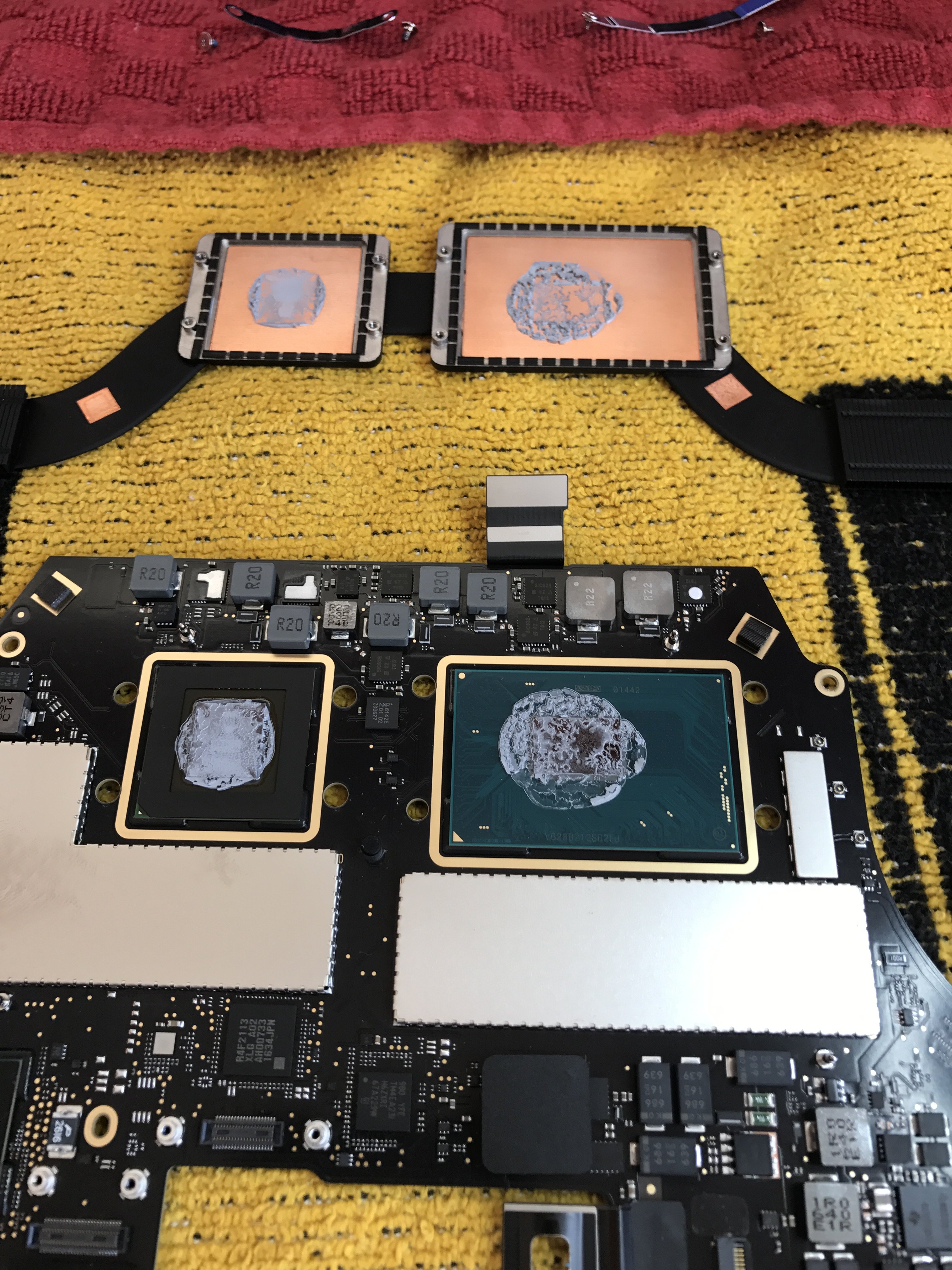

You guys are more scared than I was 🙂 and understandably so. I just got done and it doesn't hit thermal throttling like it used to.
Before Handbrake encoding mkv to mp4 my max ghz was 2.7 and it kept hitting 100 Celsius.
Now it never goes over 96 Celsius and stays at a constant 3.2ghz the whole time. I thought the turbo frequency was higher than that, but seems like 3.2 is all it liked.
Anyway, much cooler now.
Pic of before attached. I didn't do step by step but it basically is about 300 times harder than previous models 😛. Took about 2 hours.

Ummm, you have the PCB on what appears to be a towel, rug or carpet. That's a pretty great way to have static discharge destroy your laptop. Why would you do this?
While the system is still under warranty, if you have concerns about temperature, then have Apple deal with it. They can reapply the thermal paste for you at a Genius Bar, if you want it done bad enough.
If you want to do it yourself, then wait until the system is out of warranty. The new ones, as you said, have the heatsink on the top of the board, as opposed to the bottom like in previous generations, so it requires complete removal of the main board to even get to it, increasing the risk of damage and subsequent voiding of the warranty.
Geezuz ... you didn't wait very long at all before you just went and did it anyway ... and on a towel to boot. Makes me wonder why you even bothered asking to begin with. You could've had the Genius Bar do it for you for free.
... and holy moly, that's a lot of paste they put on there. I think that's even more than they put on the older models.

For the record ... I mentioned the towel because it introduces the possibility of components getting caught on the small loops of fabric in the towel, thereby increasing the risk of physical damage to your board when you lift it up ... and that was not a complaint, just an observation.

Kudos to you for doing this, and it sounds like it paid off. How did you clean the old paste off?
I always use this arcticsilver arcticlean. It seems to get the job done. I apply with qtips and just make sure there isn't any cotton residue on it. Ive also used high percentage isopropyl alcohol, but the articlean seems a little less messier.

3.2GHz is the max 4-core turbo for 6820HQ (2.7GHz without turbo). What's the average temperature? Since it's been a year, anything changes?
