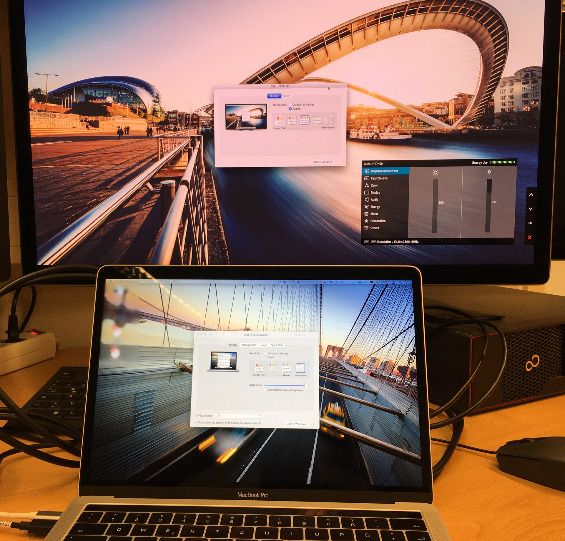

I had the chance to connect a Dell UP2715K and an HP Z27q to my 13″ MacBook Pro with Touch Bar (running macOS 10.12.4) today. Both worked without any problems at the full resolution of 5,120 × 2,880 pixels at 60 Hz, using two USB-C to (Mini) DisplayPort adapters. (Admittedly, my test lasted only several minutes.) No issues, no need to fiddle with SwitchResX, no matter whether I used the ports on the MacBook Pro’s left or right side.

I’m a bit late to the party, but the following information might still be useful for some people:

The Dell UP2715K comes equipped with three ports: two full-size DisplayPorts and one Mini DisplayPort. For 5K, you need to use both full-size DisplayPorts, while for 4K you need to use the single Mini DisplayPort. (See the user manual, p. 11.)
Using only one of the full-size DisplayPorts will work, too, but the resolution will max out at 2,560 × 1,440 pixels, in my experience.
4K looks fine, I would say, but—due to the interpolation involved—nowhere as razor-sharp as 5K.
In addition, you have to tell the screen via the on-screen menu which input(s) to use. The screen is “too dumb” to detect by itself which input(s) is (are) are being used.
Regarding the USB-C to (Mini) DisplayPort adapters or cables, make sure that they support 4K at 60 Hz. Some support 4K only at 30 Hz.

(1) Yes. That’s why I posted the image in my post.
I also tested my (late-2016) 13″ MacBook Pro with an HP Z27q display, and it worked equally well.
On my MBP, the two Thunderbolt 3 ports closer to the front have a noticeably tighter fit than the two closer to the back. This is why I use the ones closer to the back almost exclusively for power supply. When using the ports closer to the back, I could produce a flickering image with the adapters mentioned below by moving them slightly inside the ports—which didn’t happen with the two ports closer to the front. This means, of course, that you have to use ports on both sides of your MBP simultaneously.

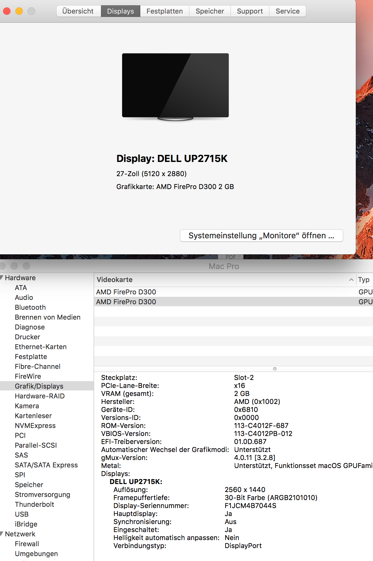

Hello arijon, wodge, Halbertus and the others!
I would like to thank all of you for your fast help with my problem. Today, my Sonnettech Thunderbolt 3 to Dual DisplayPort Adapter arrived. I think my test was successful! 🙂
In the display monitor of the Dell I have a native 5120x2880, 60 Hz resolution and the symbol for two DisplayPort cables. By clicking "About the Mac" and "System report", I was surprised, that the Mac OS shows the resolution "2560x1440", which is suggested for the monitor. I am able to switch into 5120x2880, but the letters are too small. I am also able to scale the letters, but it returns automatically into smaller resolutions (in the system report).
Is it the same with your Mac? What about using a iMac 5k? Is the resolution in the System report smaller than the native resolution of the monitor? If yes, I am fine now. If no, I think the Sonnettech is not full supported. But at the end I tested something: I compared the resolution in Lightroom with the One-cable-solution of the Choetech-cable. With the Sonnettech the resolution is much sharper, both tested in 2560x1440 (System report).
Maybe anyone can help me to find out, if it's normal that the resolution in the System report is smaller than the native resolution of the monitor.
Thank you!
Regards,
Timo
PS: You are right, that the monitor turns off in closed lid mode. But isn't it normal? I have read, that Apple does it like this to prevent damage on the MacBook Pro because of the heat. So I think, it has to be the same with fully supported displays like the LG. Am I right? See: https://support.apple.com/en-us/HT201834
Hi timo_k82,
Yes you can absolutely scale up and down with this arrangement. And an important point to note though is that on a Retina 5K screen you will have a 5120x2880 native resolution, but by default run "pixel doubled" at a setting that looks like 2560x1440, it just has four times the detail of a "traditional" display. 🙂
Cheers~
That's normal and fine!
