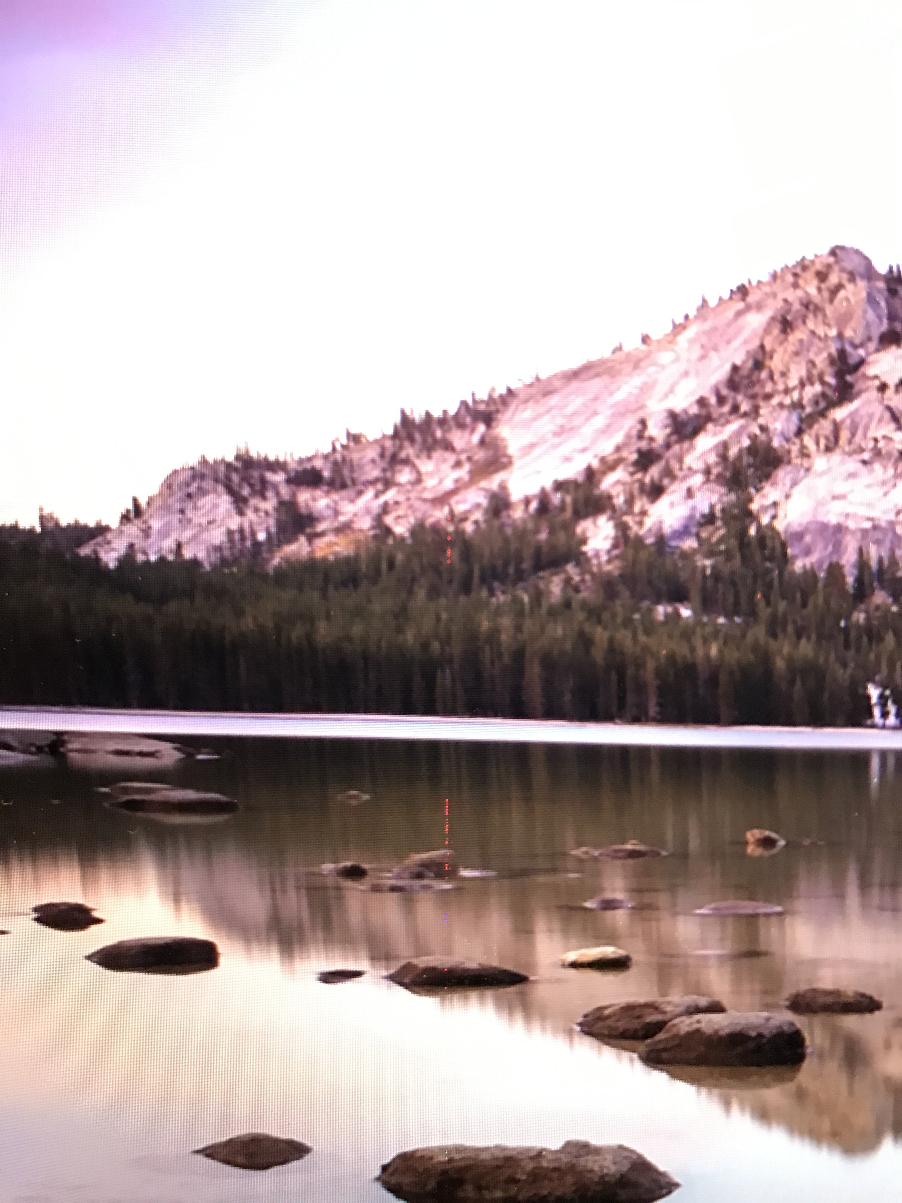

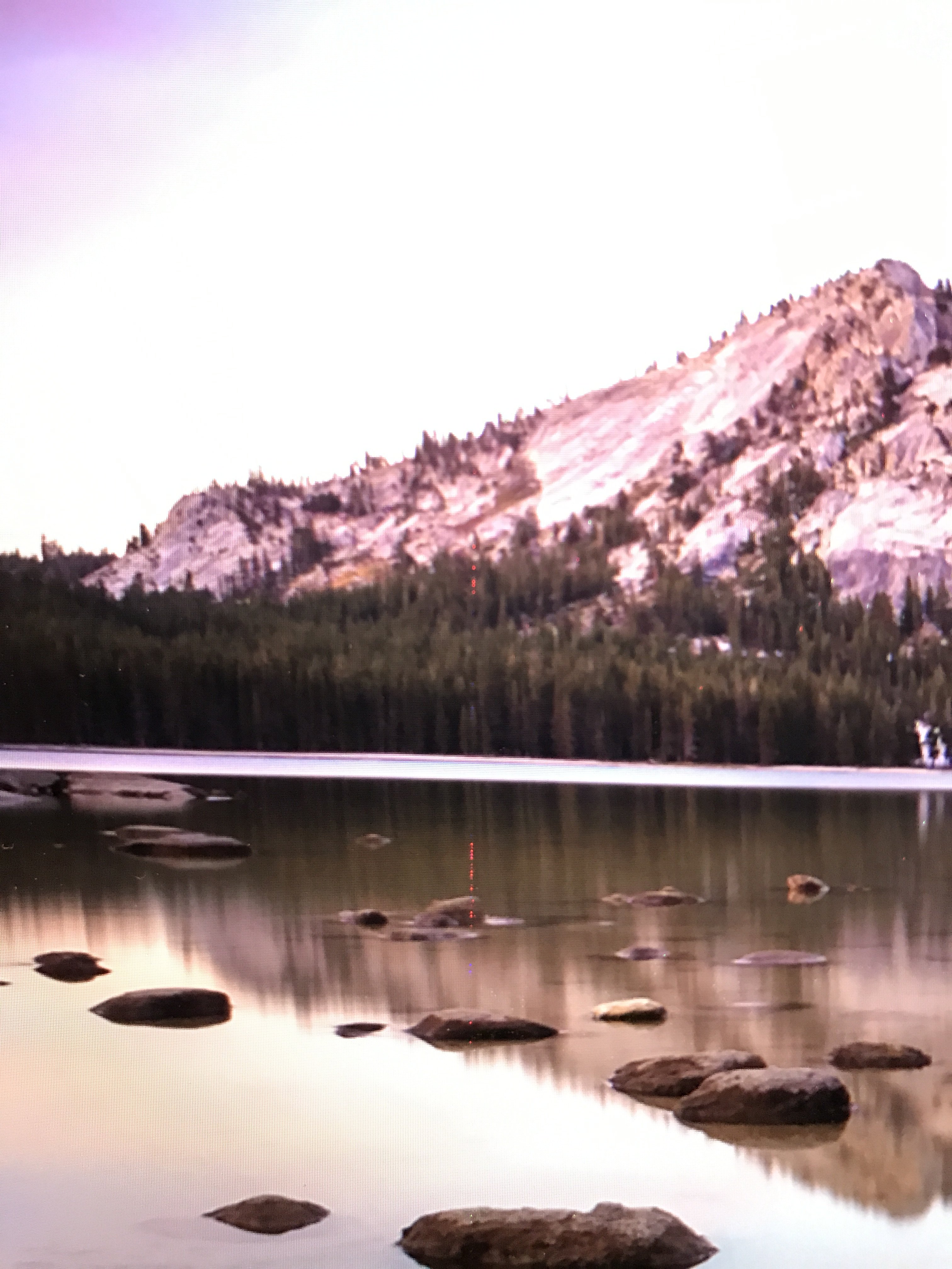

Here's mine, with or without FileVault

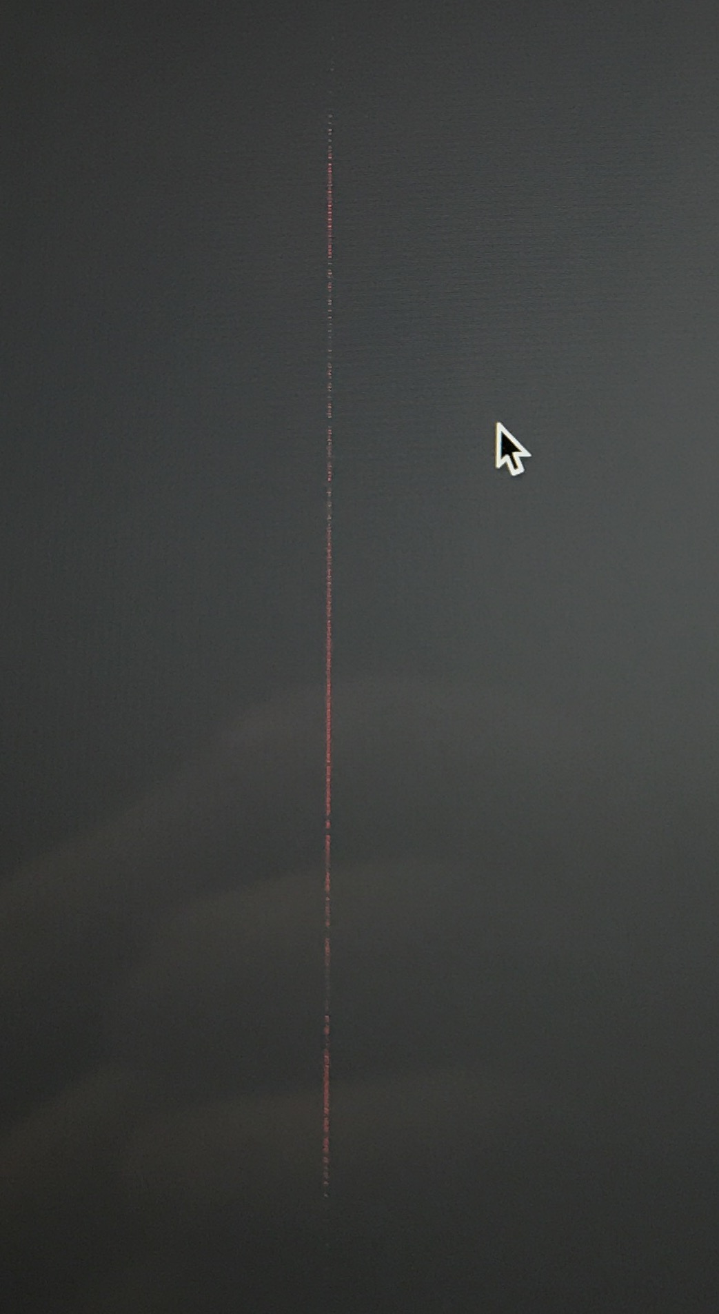

Mine did something similar but all the time - not just when logging in. Also had vertical distortion lines. It did it in recovery mode too. Swapped in store yesterday.

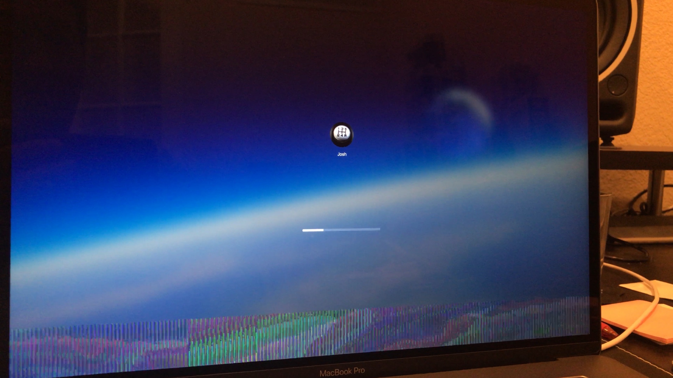

[doublepost=1480015993][/doublepost]I'm having the same issues ... here's a video of what is happening to mine.

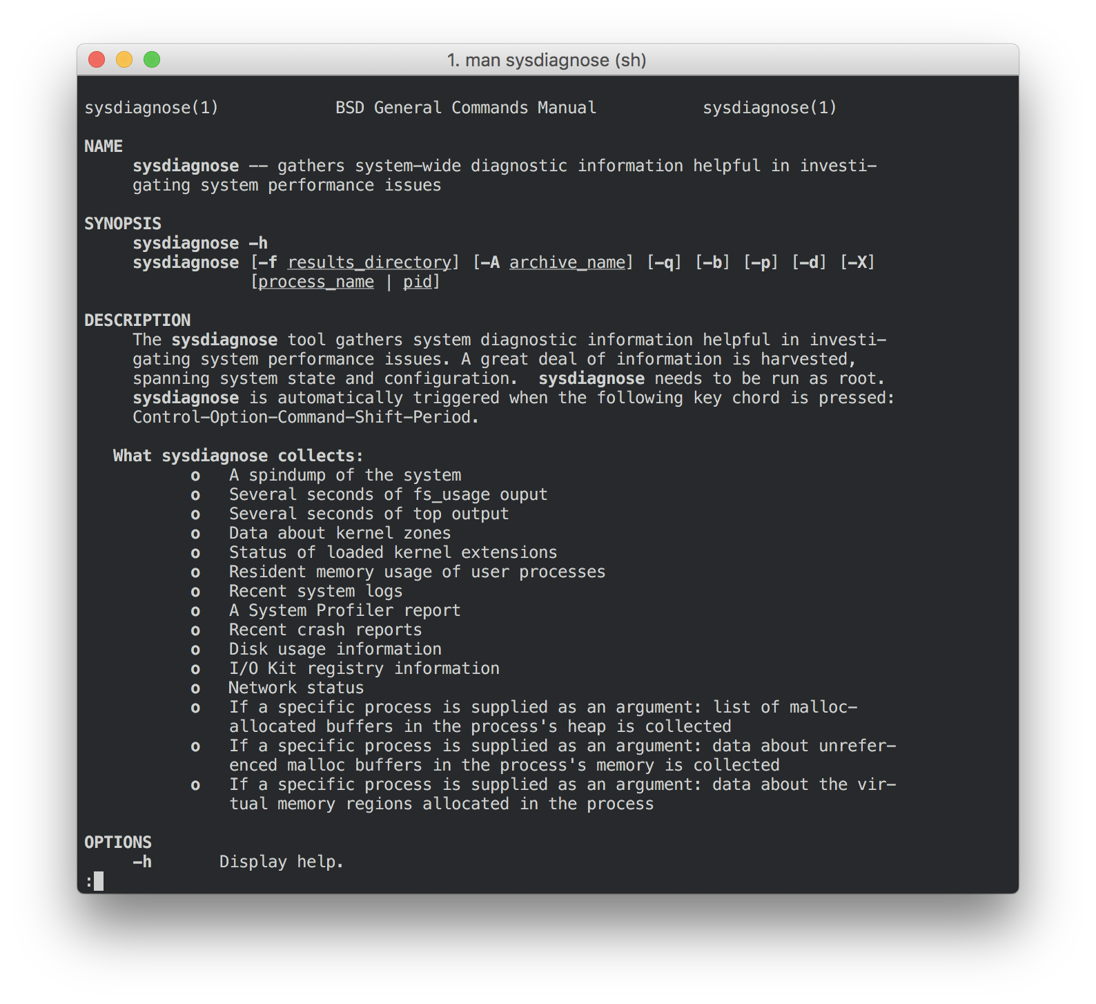

More on sys diagnose:
If you press shift-control-option-command and then period, you should see the screen flash brightly for a moment. I found that this starts dumping a system diagnostic to disk. The best time to do this base d on reading up on it is during the issue. The man page said it captures a few seconds of various places data sits. This file can go to Apple, and if you go to a apple store they can do a dump with you.
man page:
