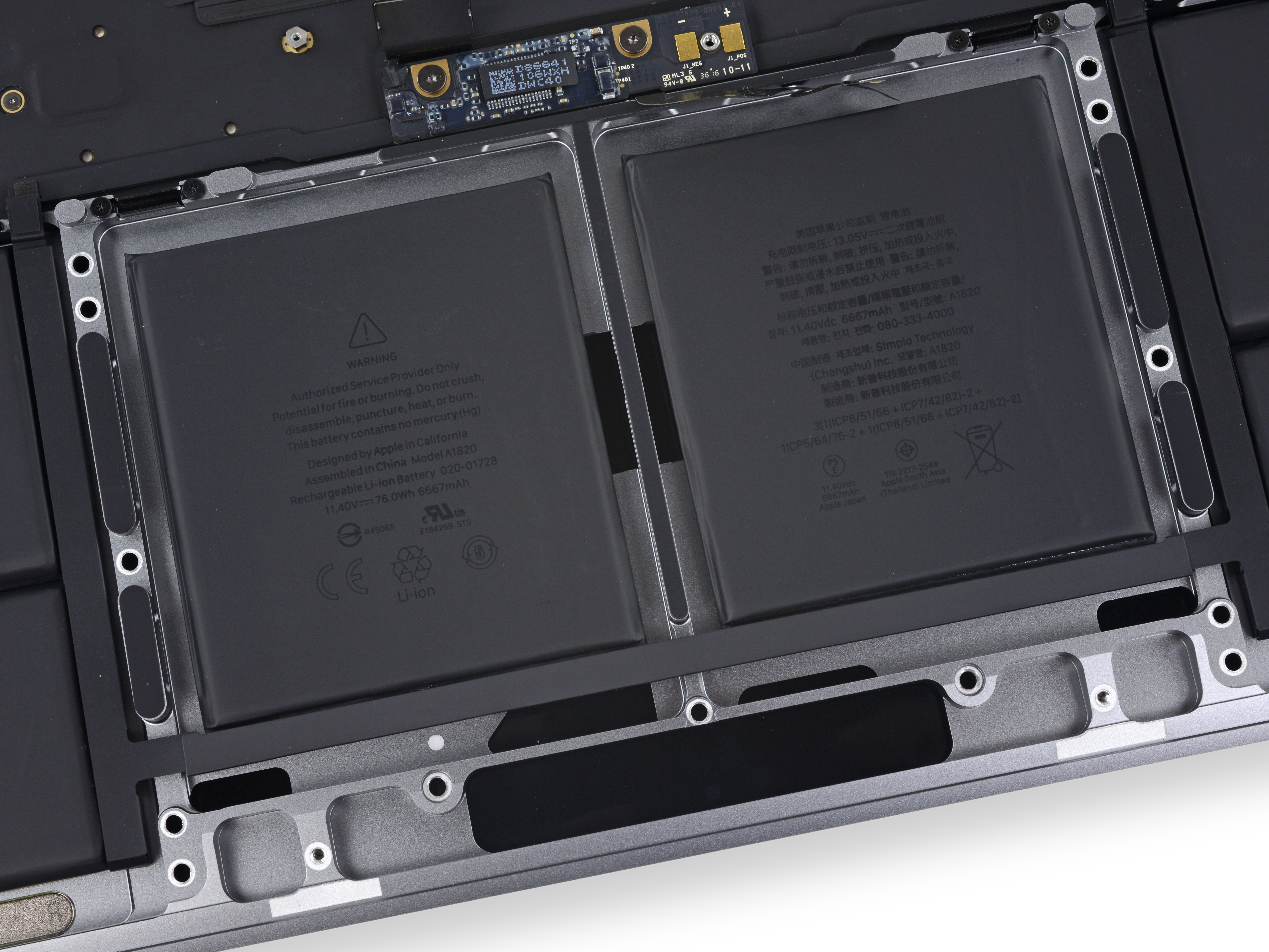

The battery is nominally rated at 11.4V and 6667mAh. It's stamped right onto the battery itself.
https://d3nevzfk7ii3be.cloudfront.net/igi/y2nrVjxllI32cO3r (via iFixit)
Thanks that makes more sense. I wonder why it states 12.8v under system information.
