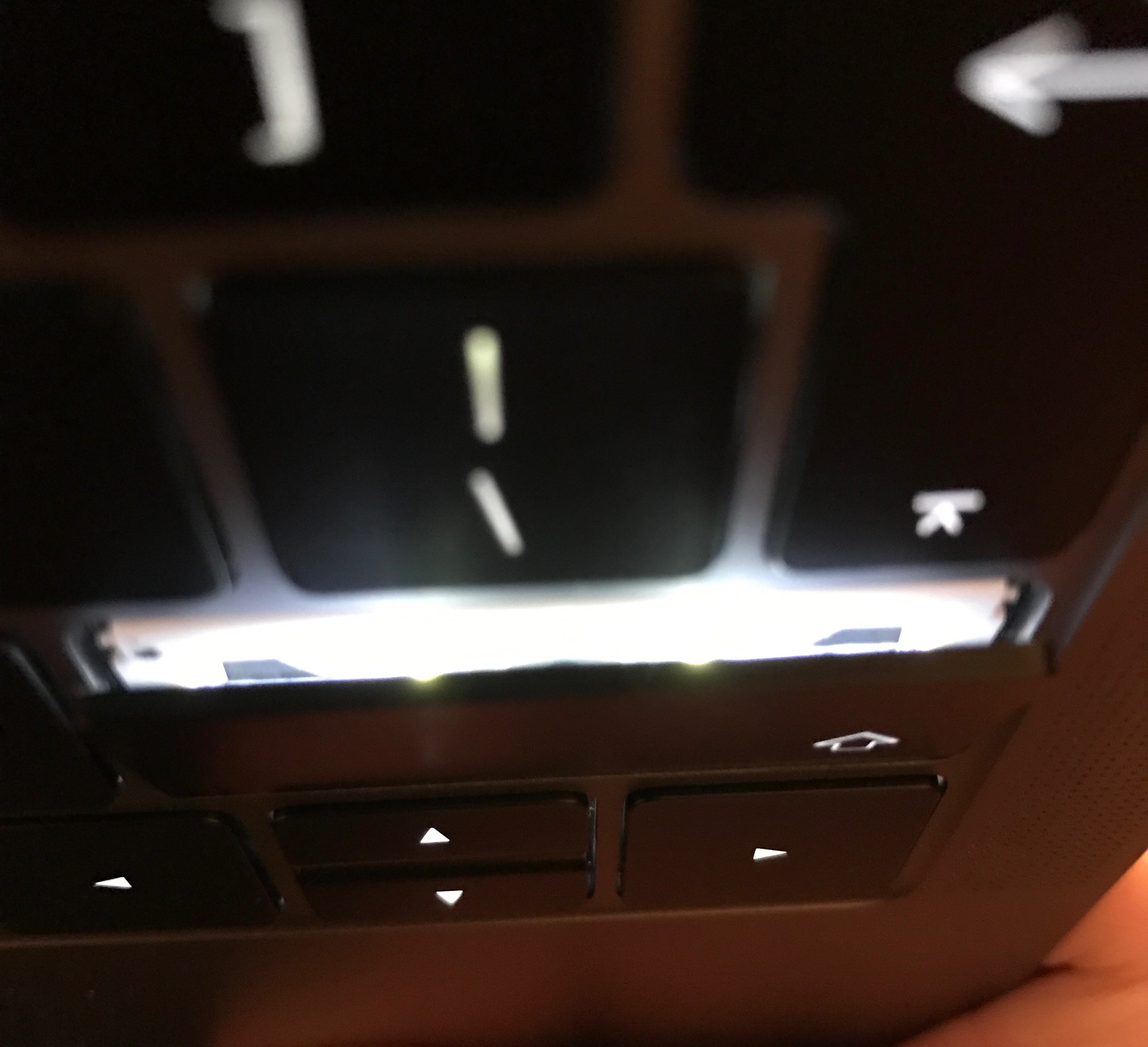

FYI, to remove the key caps on butterfly mechanism keyboards:
It's a very finicky process and they are quite easy to break. However, you can half-remove them so they hinge upwards from the bottom, which gives enough room to remove debris (especially if you have compressed air) without much risk.
  • Get a guitar pick, or, if you don't have one of those, a sheet of decent quality paper will do
    • If using a pick, prise up the top part of the key cap. It takes quite a bit of force.
    • If using paper, slide the paper into the crevice above the key cap as far as it will go, and then wiggle the paper to the left or right edge of the key cap so that the paper is under the corner of the key. Prise up the top part of the key cap. It takes quite a bit of force.
  • On the shift key (pictured) there are two clips - one on the left, and one on the right. On other keys there may be just one, or more in the case of bigger keys like the space bar
  • Keep pulling until the clip(s) un-click. Now the key cap will hinge from the bottom as pictured, allowing you to clean underneath
If not absolutely required, do not remove the bottom clips as these can break very easily.
To replace the key cap, simply press down on the top part so the clip(s) re-seat.
