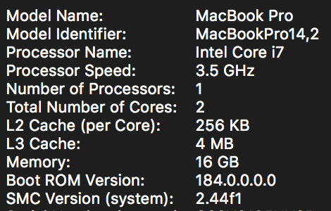

plays ok for the most part. however i wish the frame-rate was higher (I selected 4k@60 in youtube but it looks like ~20 fps to me). a few stops/buffers here and there but overall not too bad.
2017 13inch i7 3.5G - latest Chrome, played in both window and full-screen mode.
