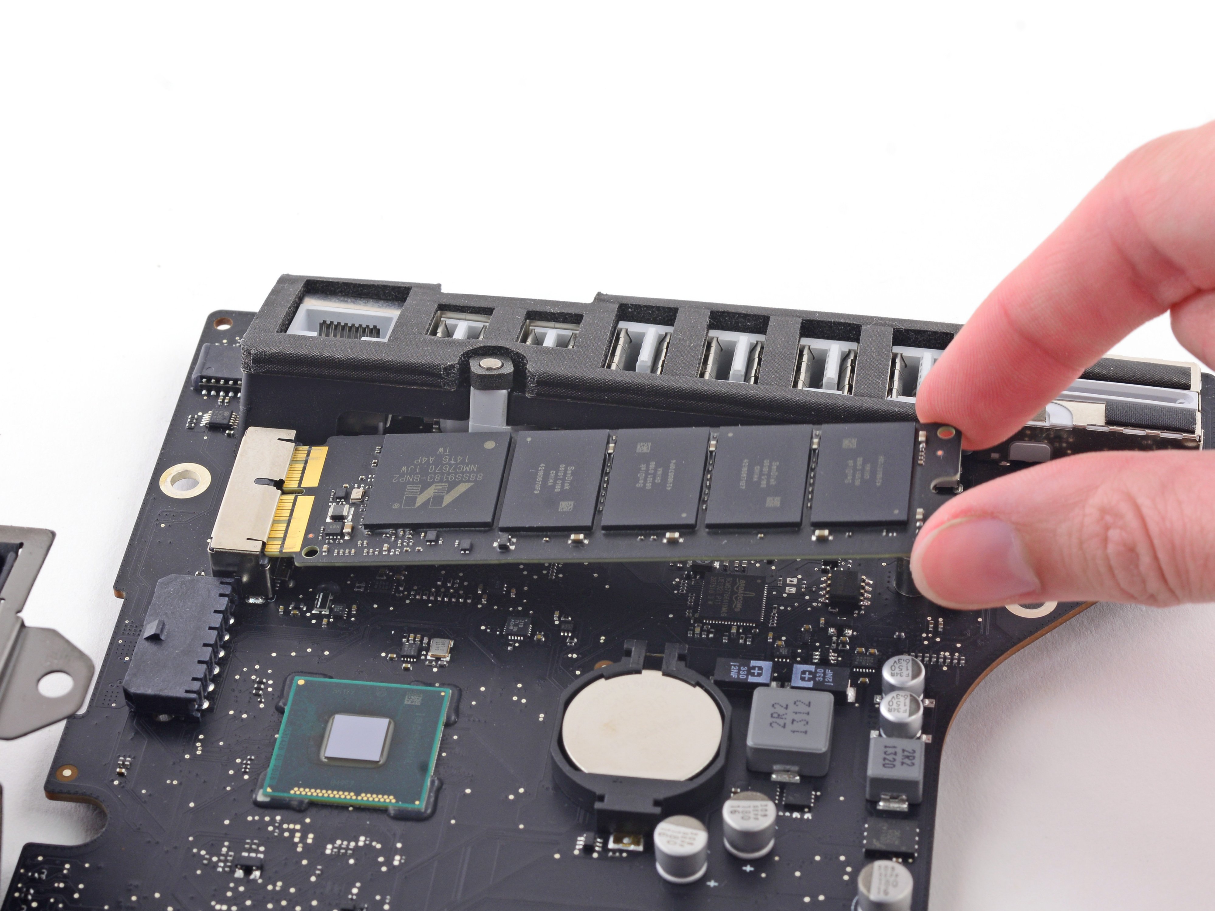

The SSD that came with my 2017 iMac is failing. I need to buy a replacement. I have no idea what to buy. For example, will a Western Digital PCIe Gen3 x4, M.2 2280-S3-M (WDS500G2X0C) work?
If not, what should I look for?

You know, I've replaced batteries and upgraded RAM and drives in several laptops (MacBooks) and a Mac Mini, but I just don't have the confidence to take apart the iMac. My goodness. Sixty steps plus that adhesive.
Haha it looks scary but I've done it 3 times so far, it's a lot easier than it seems.
