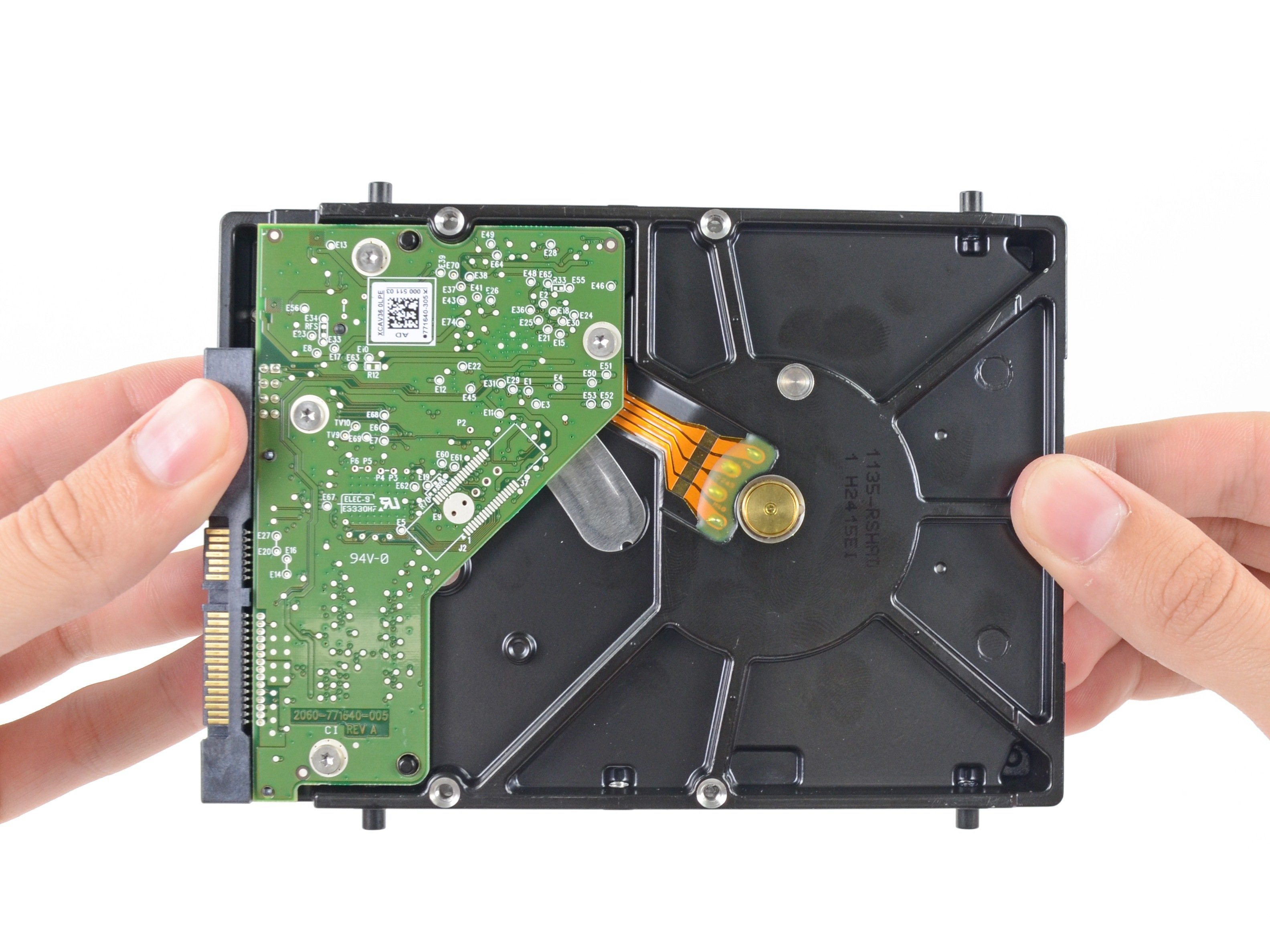

seriously, i do this upgrade all the time. You cut off the screen and replace the 3.5in spinner with a 1,2 or 4tb crucial sata ssd in a cradle.Then you reboot off an external and install your OS on the crucial ssd and import your files from the backup. Then you erase the mobo ssd format as apfs and delete the little volume so you can ignore it from now on ..... its the best way i have done dozens of them. just be careful with the tool to remove the screen or get someone else to do it whos done one before !

agree if you are not used to opening them up there is a risk of cracking the screen, and its not worth getting a new screen so that would be that. Since its a fast usbc/thunderbolt connection on the back, and external nvme blade in a housing will work well, provided the internal spinner is not actually failing and can just be ignored..... gosh, even a sata ssd in a usbc housing works ok, but a blade would of course be better.

I have done this upgrade myself, to multiple iMacs, including those with the "glued" screens.
Actually not that bad, just take your time, and don't rush it.
