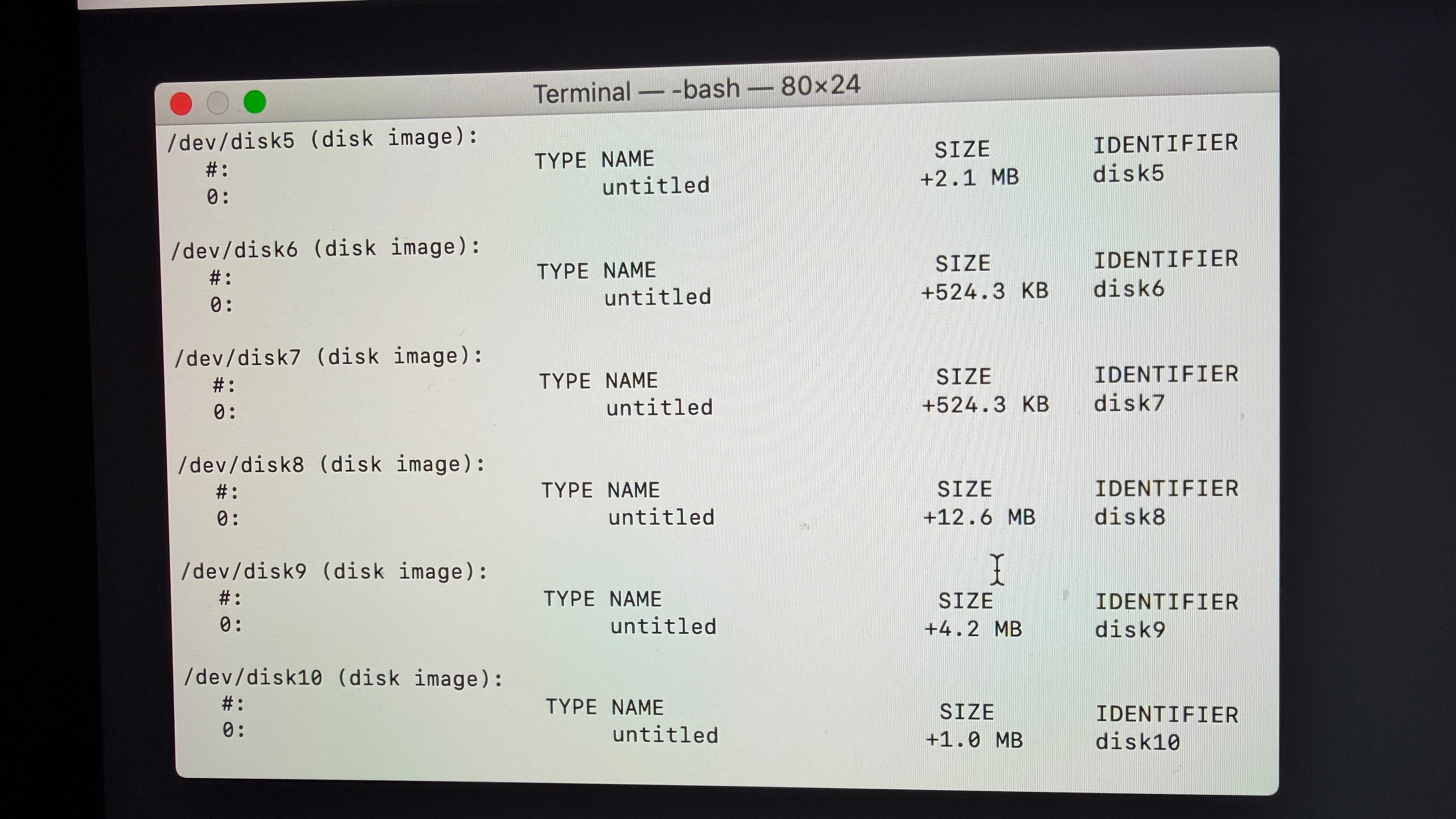

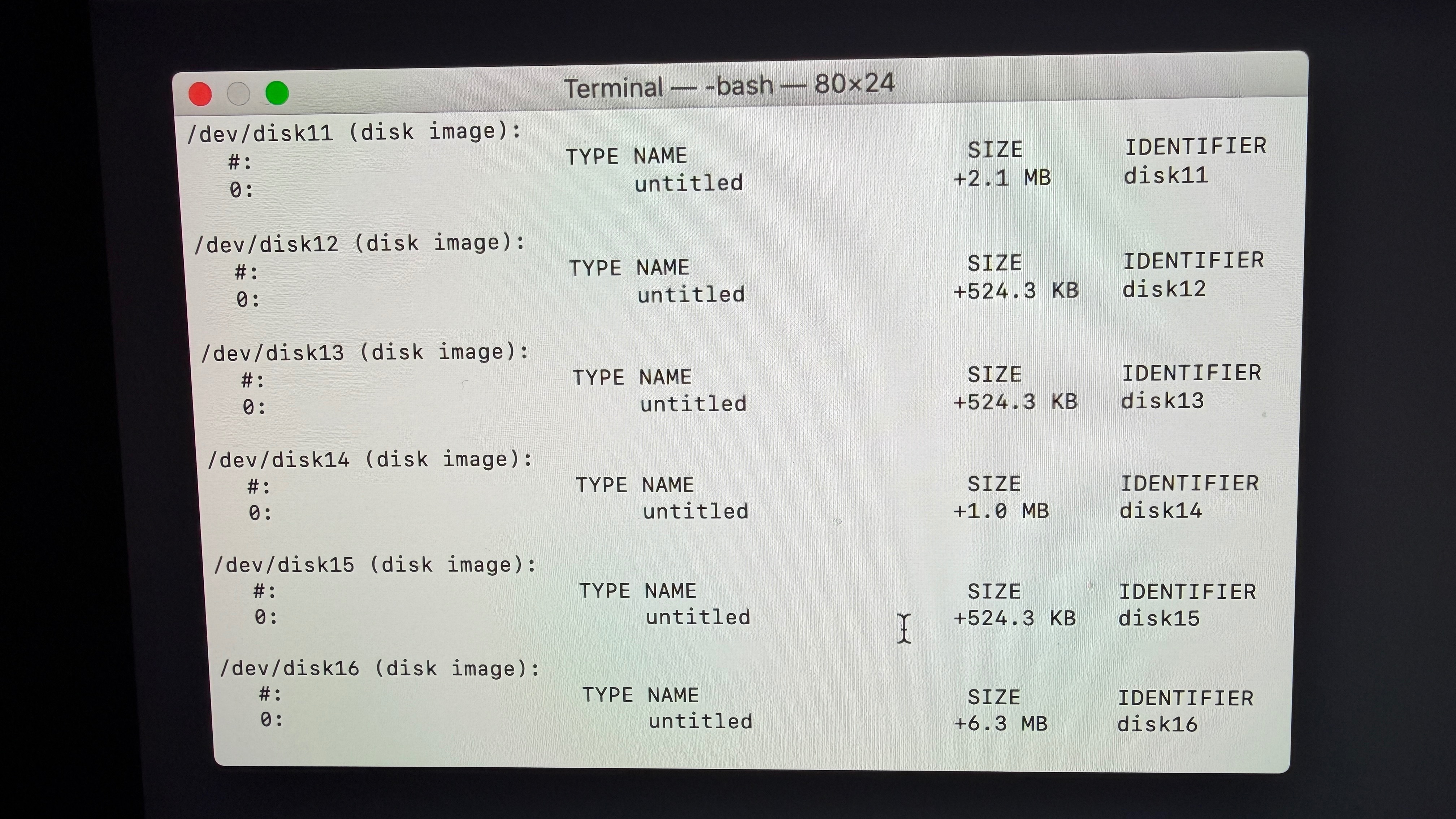

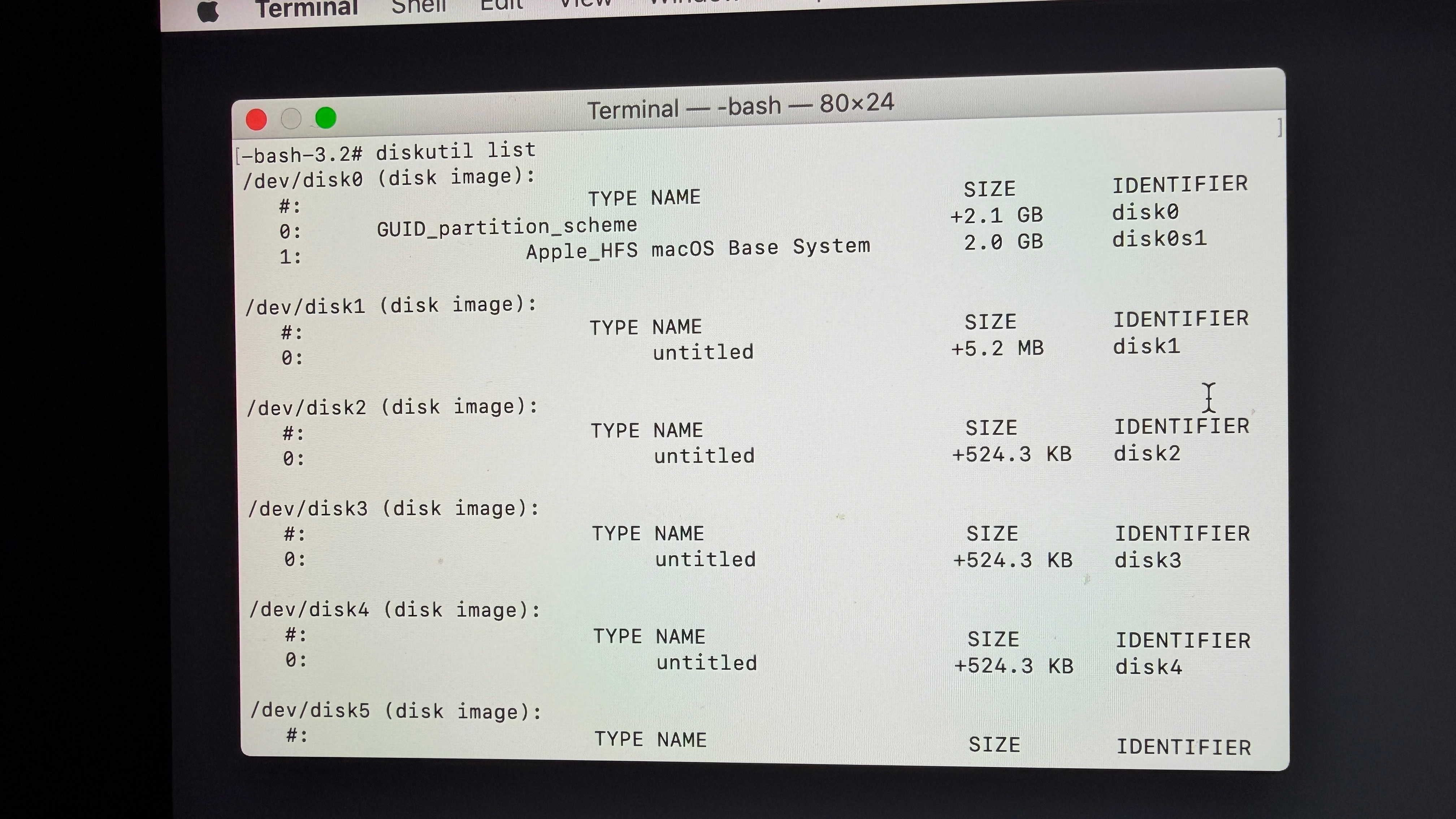

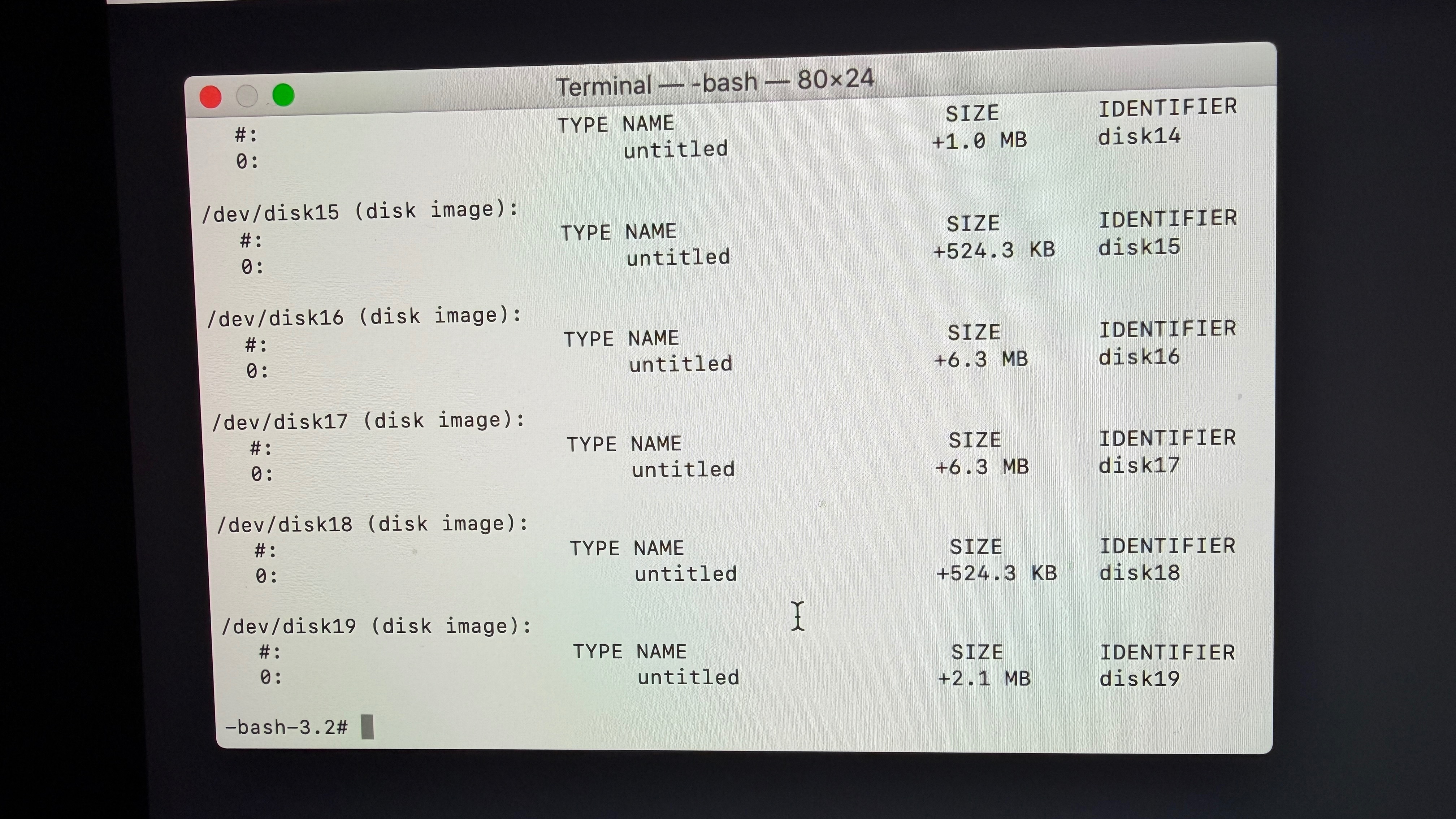

Once you're in Recovery, open Terminal from the menu and type "diskutil list" then supply the result here. You'll likely need to take photos of the screen.
Probably not a fusion drive. The diskutil only shows a variety of different size images, all very small, and nothing that appears to be useful for any storage -- likely just a result of trying to boot in different ways, and then trying to find a usable drive to format and install a system. AND, there appears to be nothing internal that you can successfully use for storage. The diskutil list does not show anything other than what it thinks is an SSD, and does not show anything that might be a hard drive (the spinning platter part of a fusion drive), nor does it show the SSD device that would be the other device that is part of a fusion drive. So... it appears to be a 1TB SSD, and that would seem to be dead... All files that are not already backed up are lost, unfortunately. You can contact a data recovery service, such as DriveSavers, and see what they have to say.
Those tiny volumes are normal when booted into Internet Recovery. However, like you say, the real drive isn't showing up and therefore has likely failed.

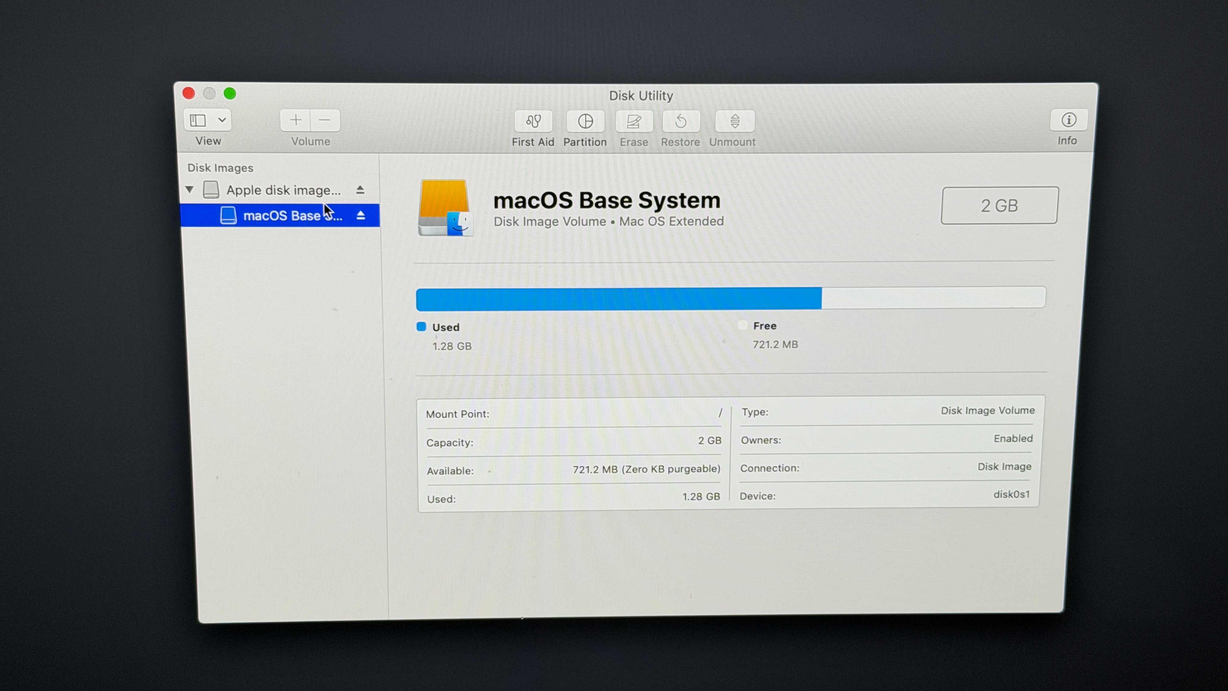

First, thank you for the info you have posted. Very helpful! I rebooted in target disk mode. It get a thunderbolt icon moving around then display. I then connected the computer to my MacBook with a USB-C. The drive doesn’t show up on there.
Why is the boot drive (on your MacBook that you are booted from) also not appearing in your Disk Utiliry?
Click on the View icon (top left corner of the Disk Utility window) and choose All Devices from the View drop-down.
The photo was taken without the iMac being connected to my laptop. Just shows what the iMac sees.
