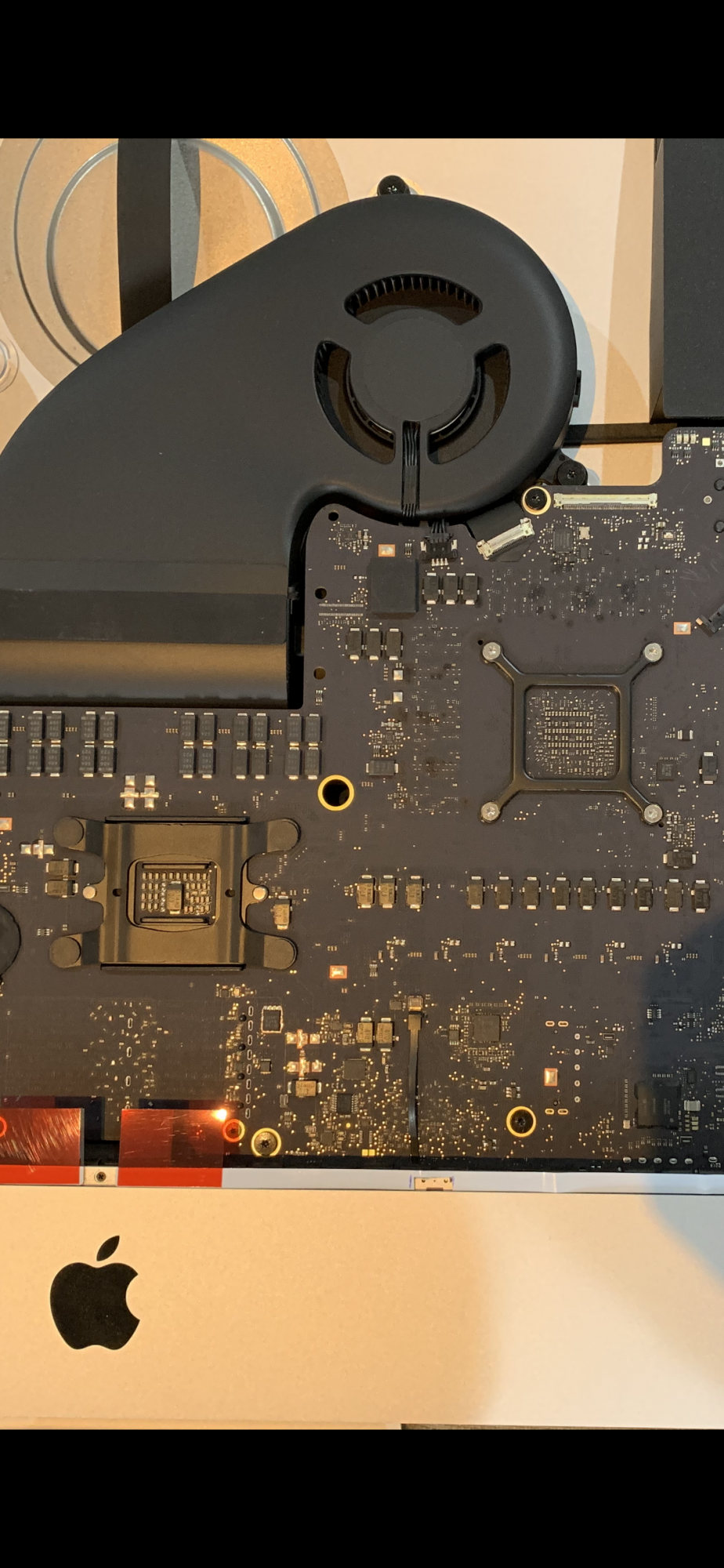

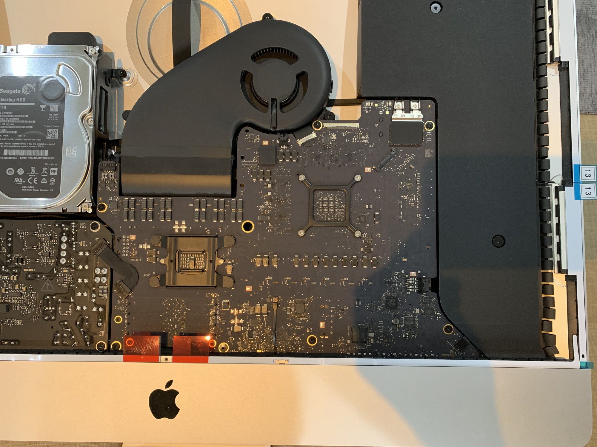

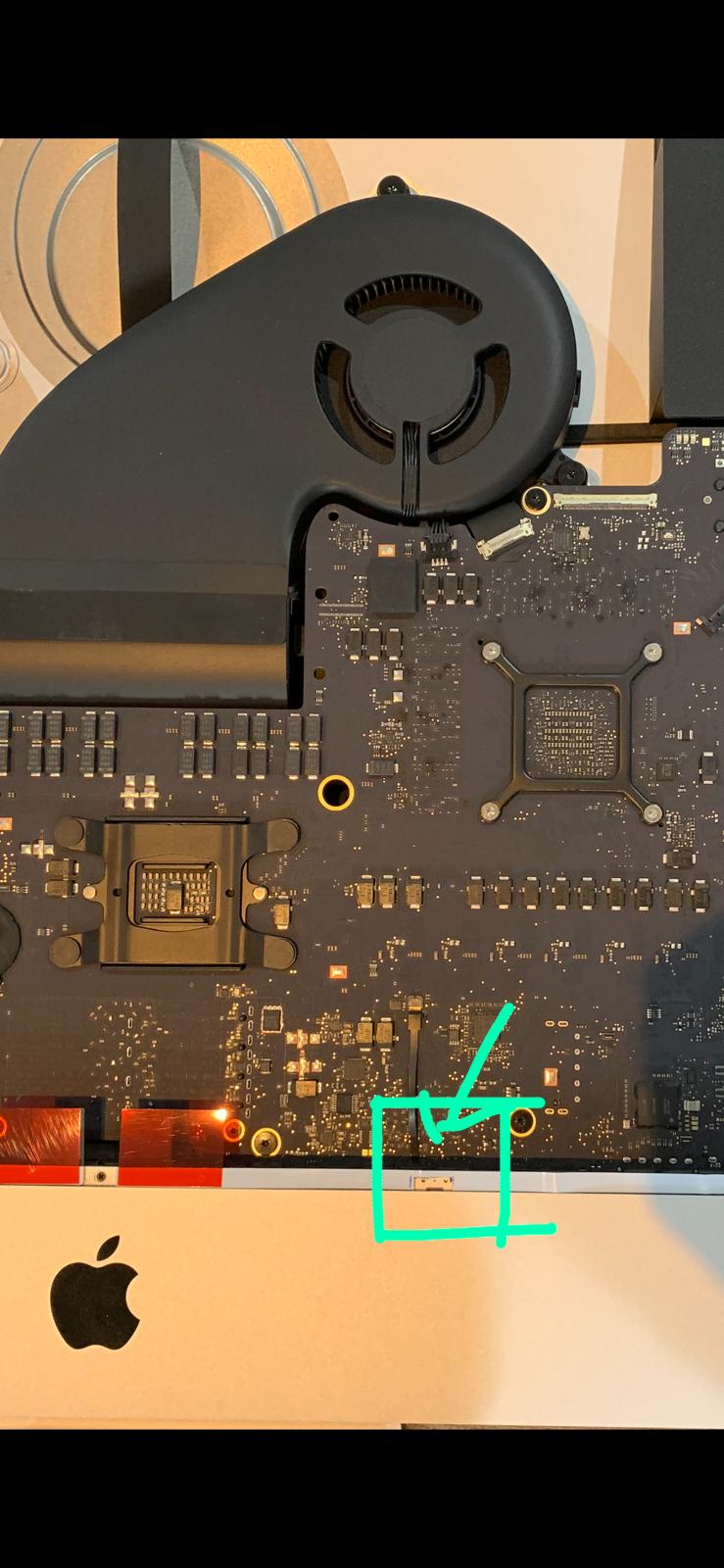

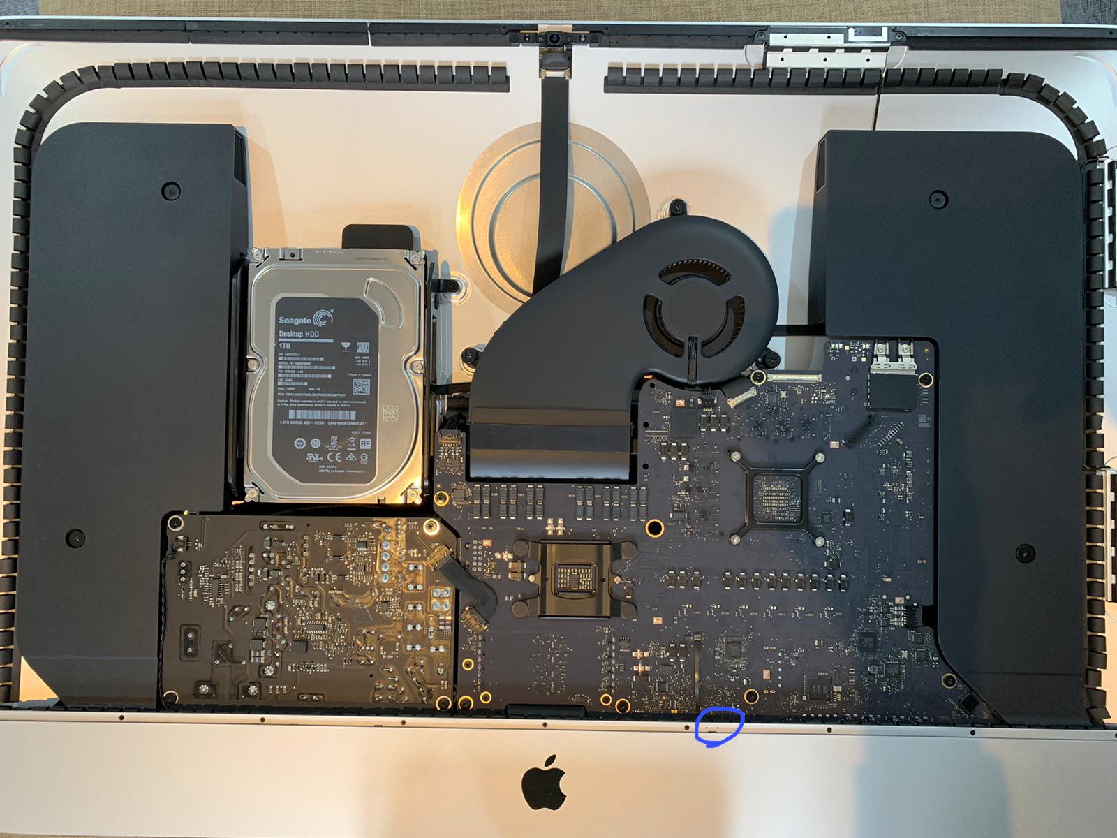

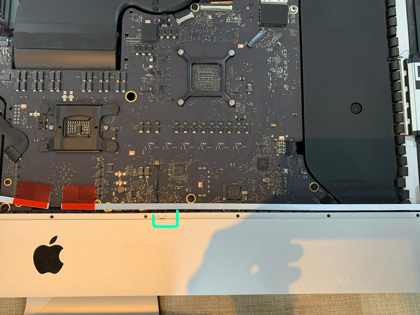

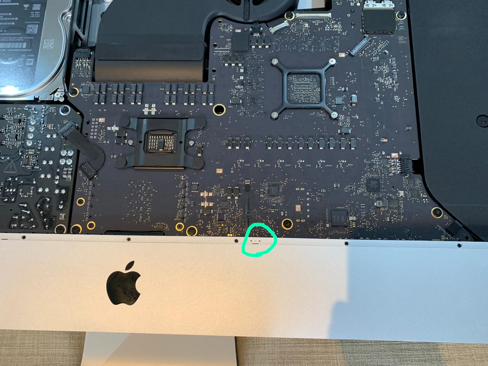

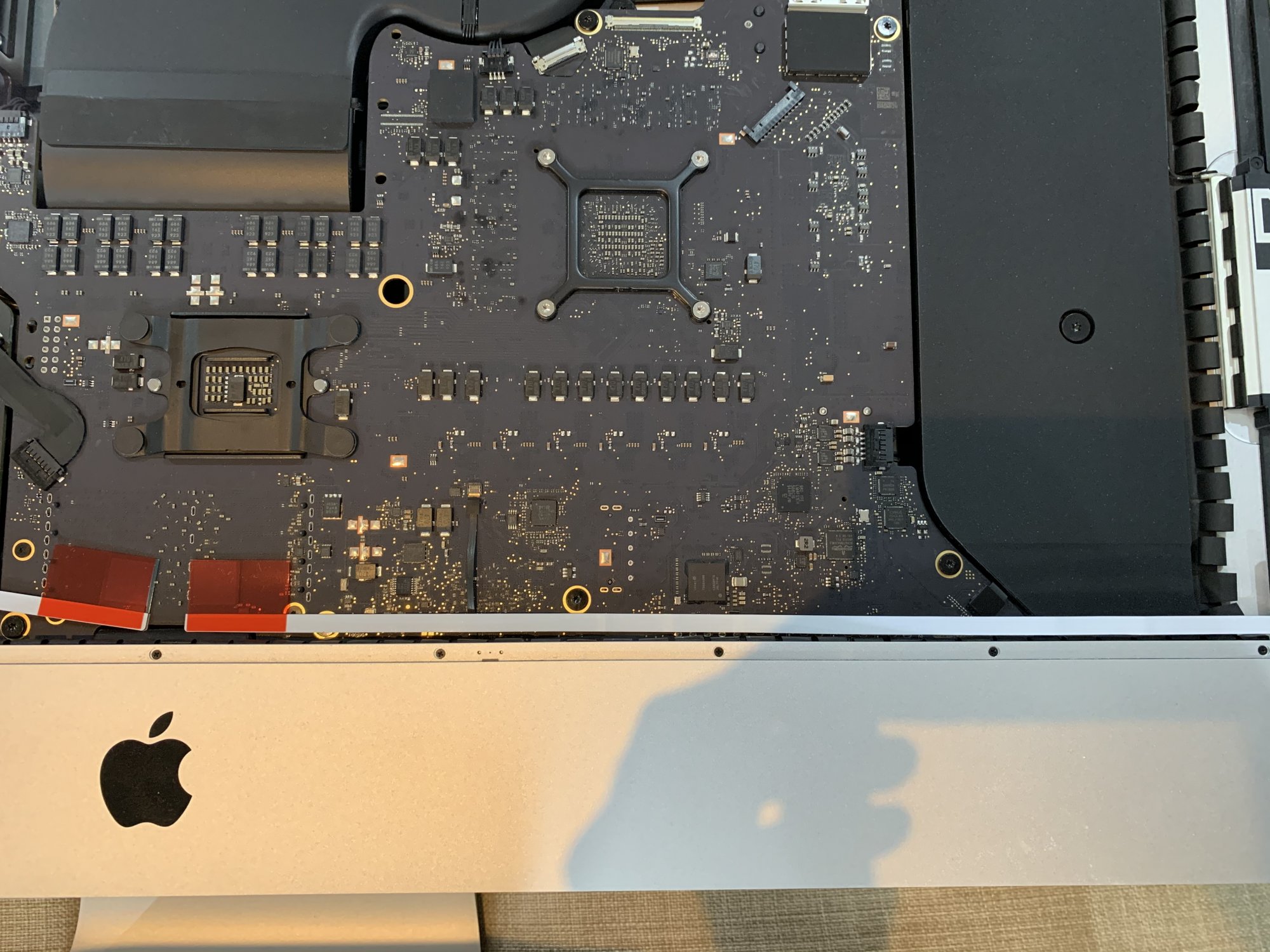

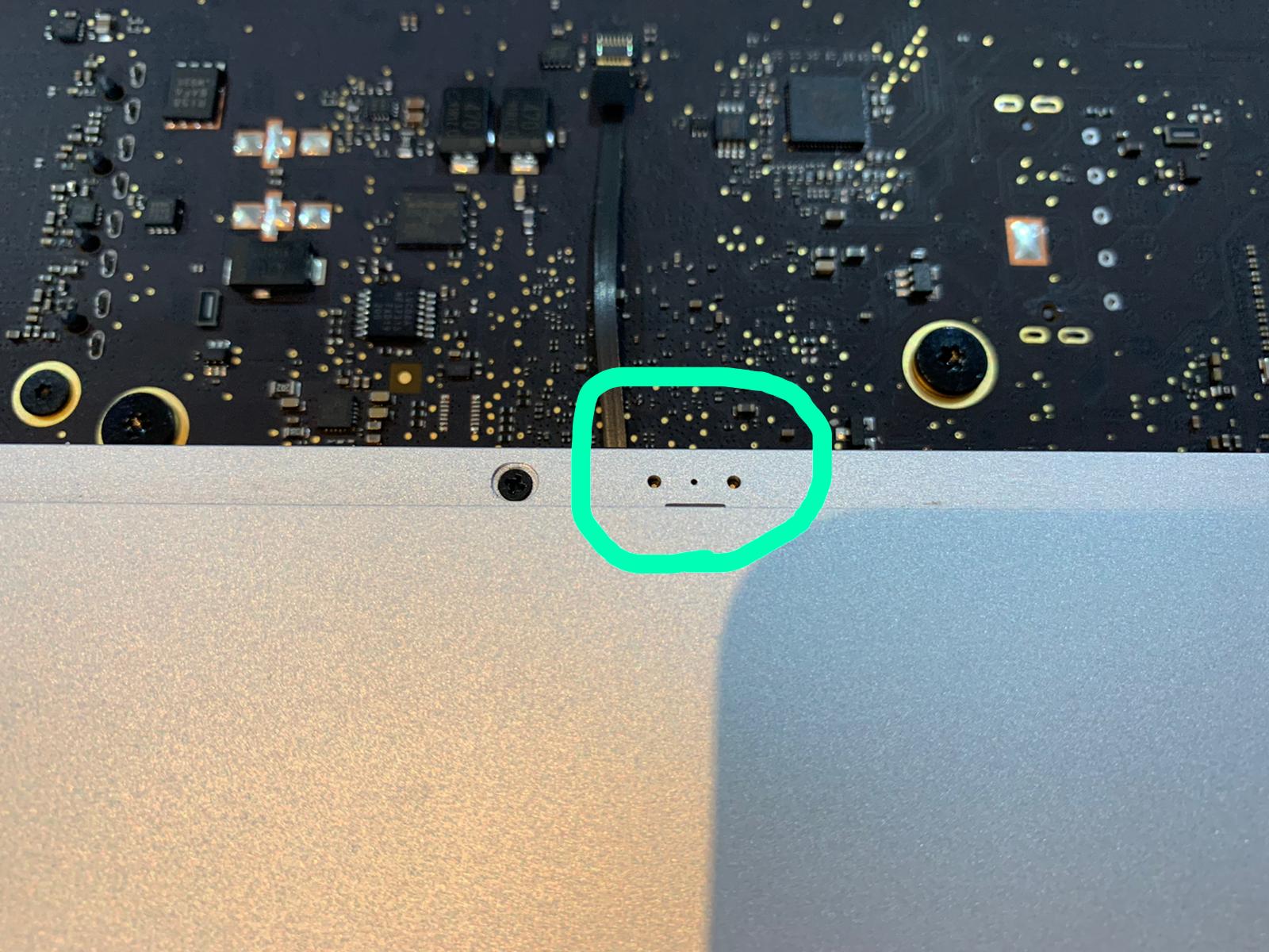

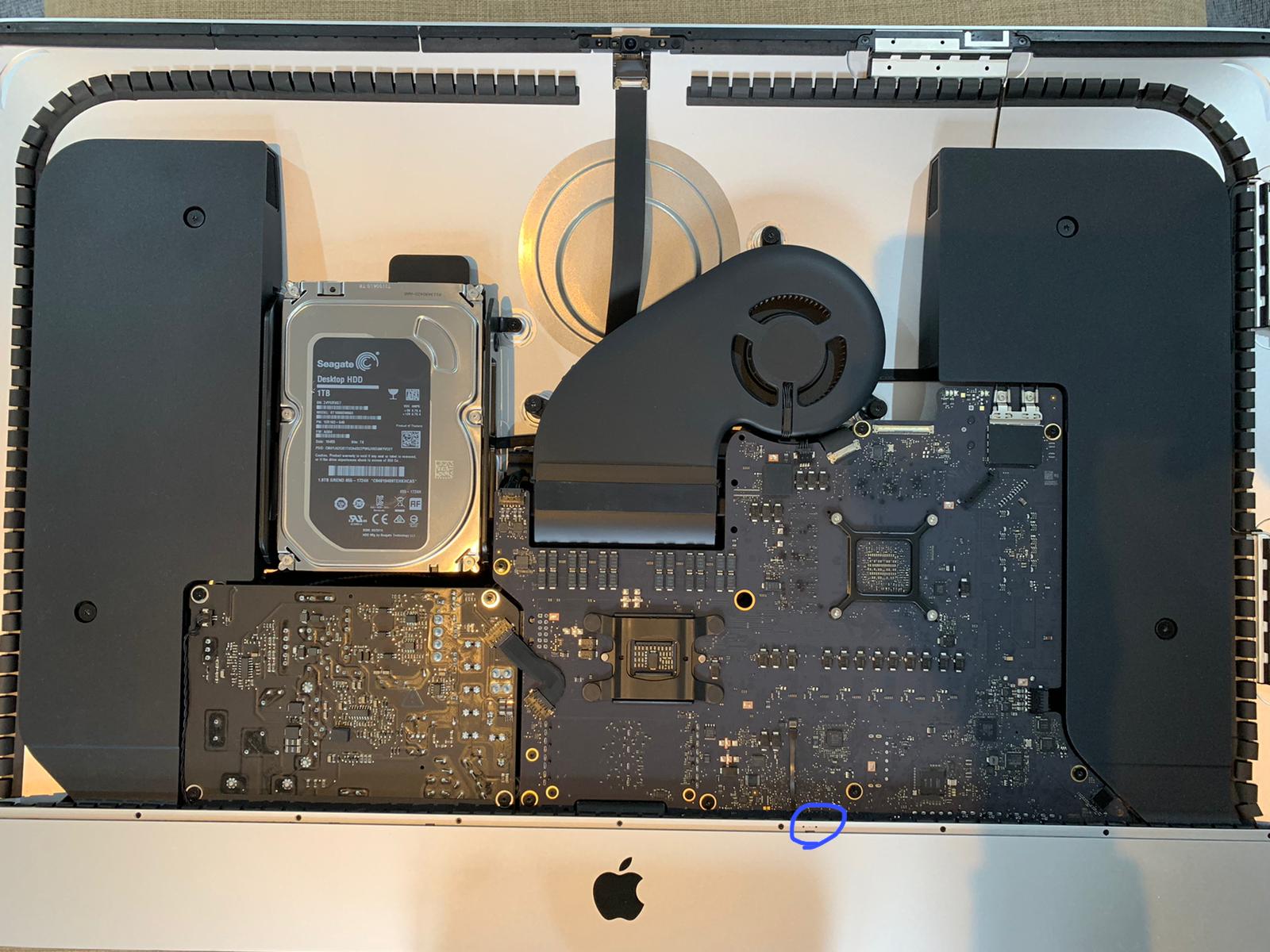

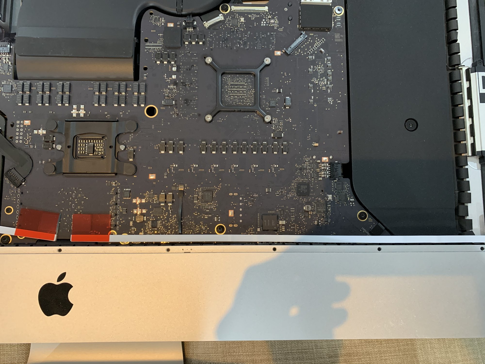

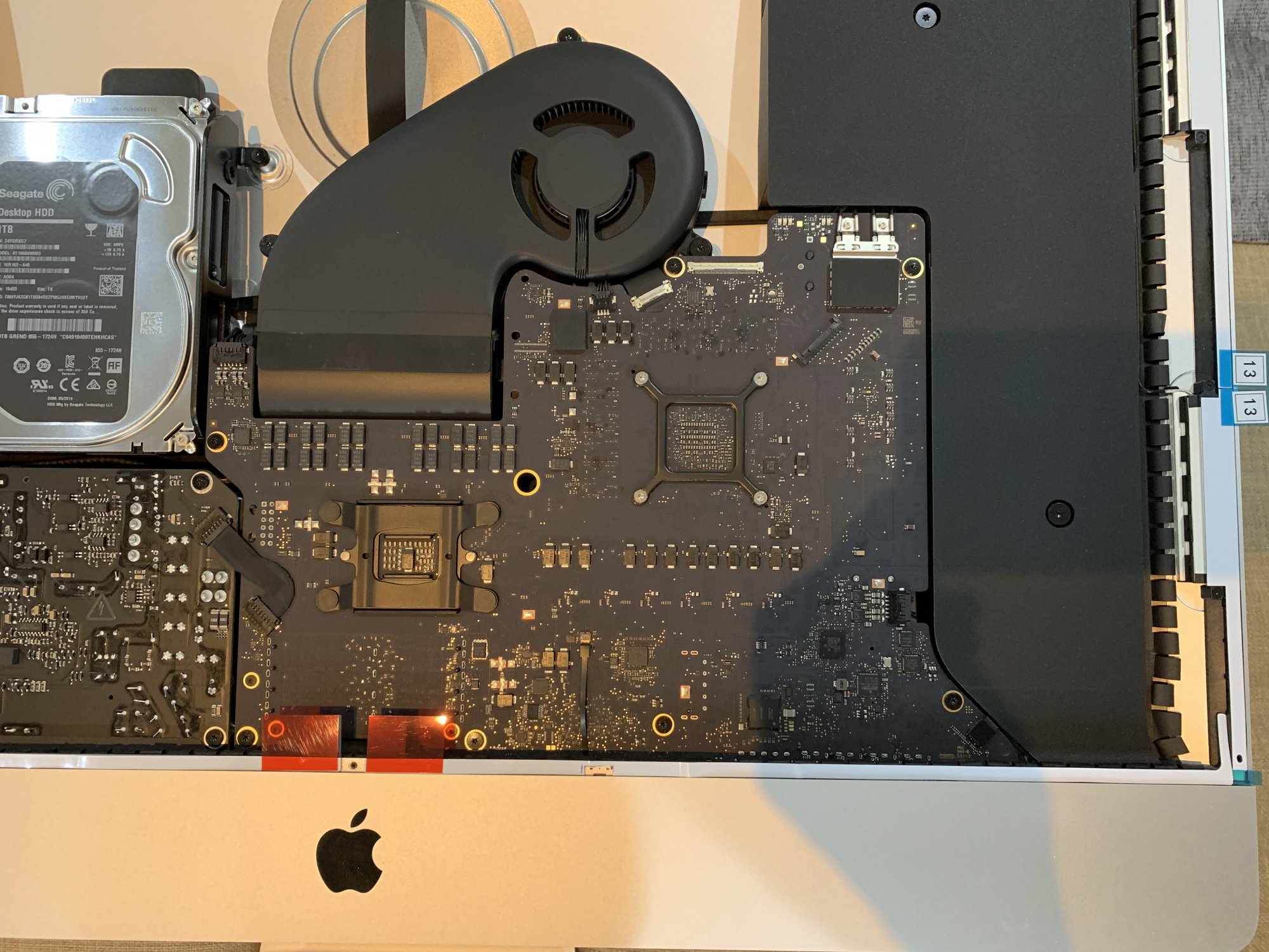

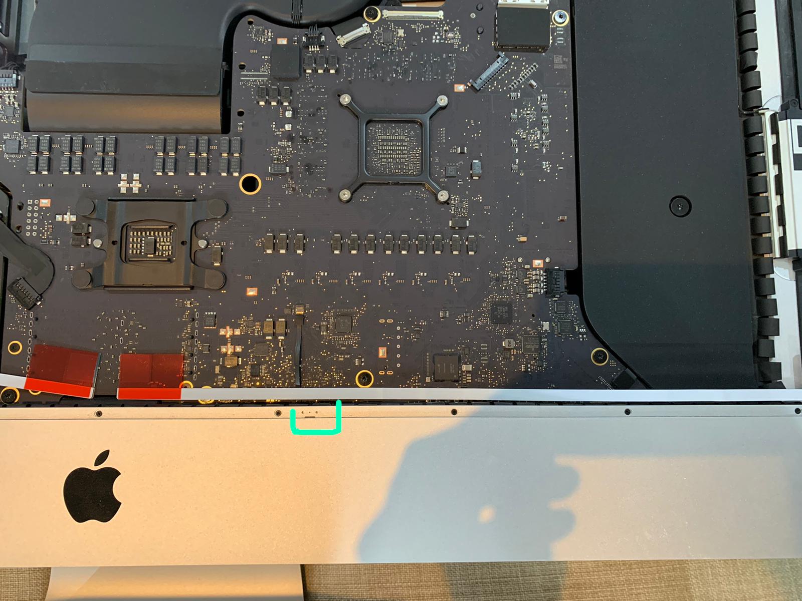

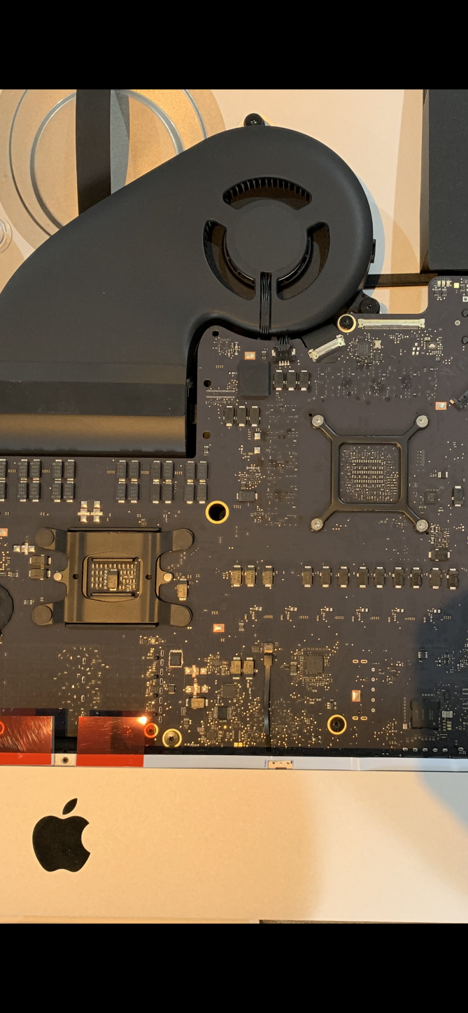

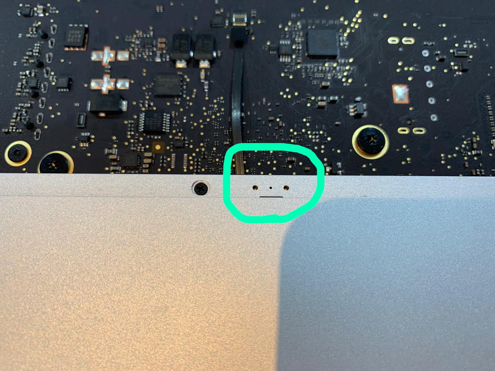

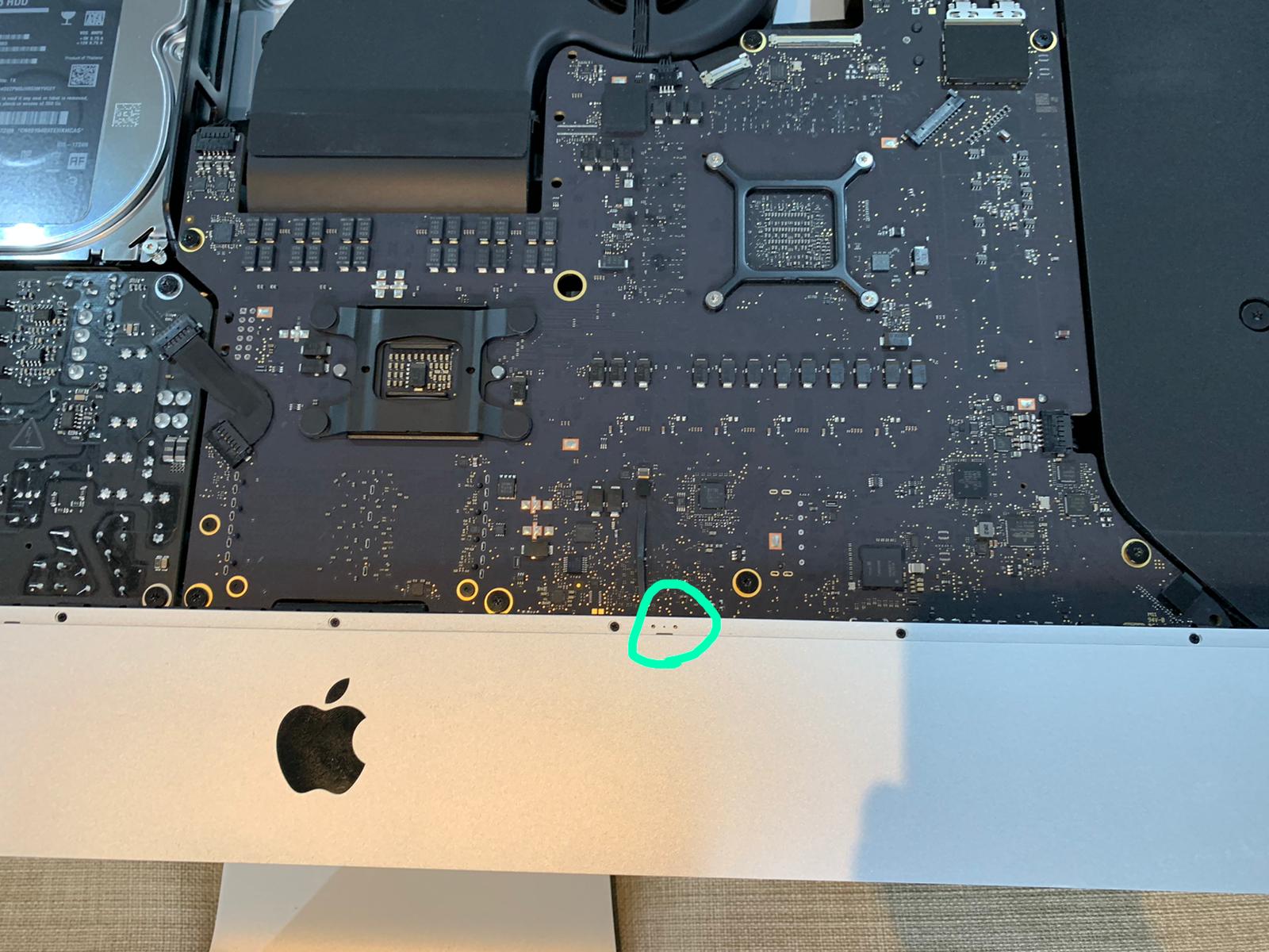

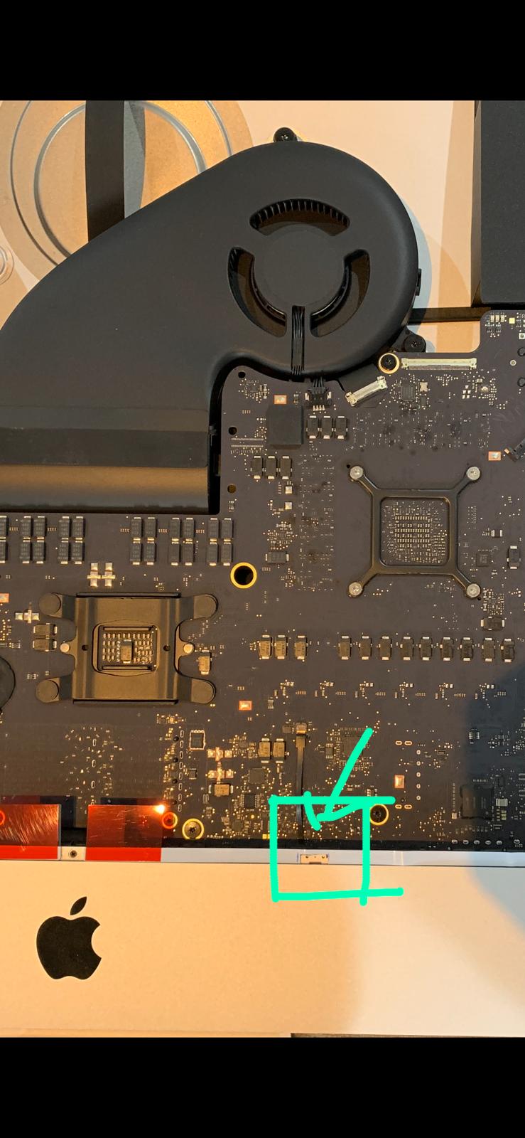

Hello ! I solved it myself! The problem was the adhesive tape that covered the microphone! My model is 2019. I know that from 2017 until now the position of the microphone has changed!
Hey, could you please explain in detail what you did? I have 2019 IMac, too with the same problem and I really want to fix it by myself.
you need to cut the tape in front of the microphone. exactly as in the picture.
