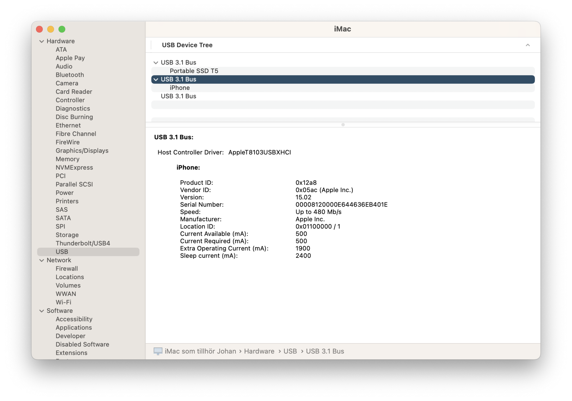

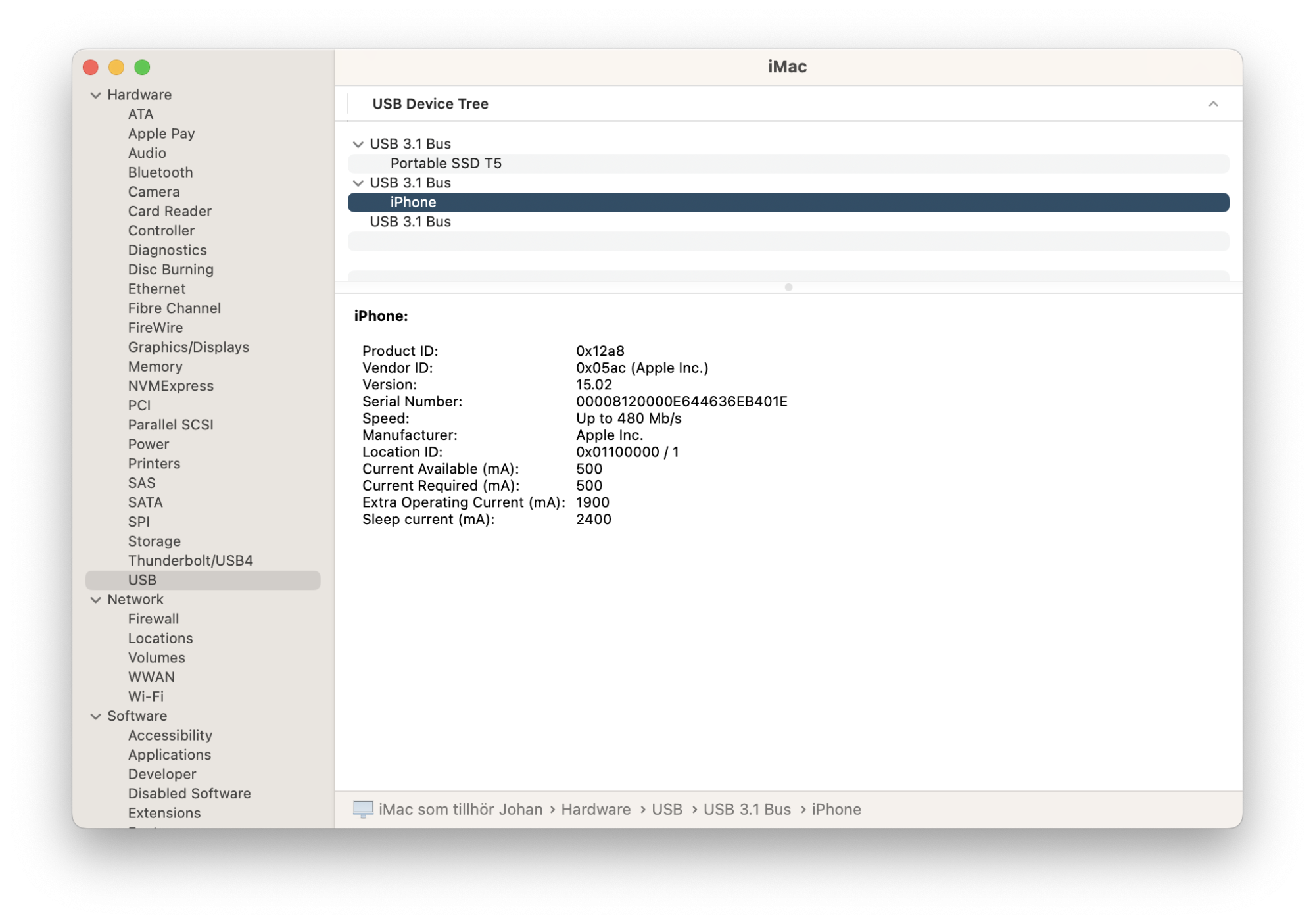

I just connected my iPhone 14 Pro to my personal M1 iMac (the Intel 2017 model is my work iMac), via an Apple USB-C cable from the M1 iMac to the iPhone 14 Pro.
This is what System Information says:
I'm a little confused what number I should look at.
I'm located in Europe with 230 volt.
I thought watts = volts * amps, but 230 x 0.5 or 230 x 1.9 or 230 x 2.4 is +100W, whereas I thought the number would be either 5W (slow charging) or 20W (fast charging).
5V * 500mA = 2.5W.
The maximum with USB 3 is usually 900mA (enough for a low powered HDD). Thunderbolt can deliver 15W - but only to Thunderbolt devices. The iPhone is USB 2, so connects as a USB device.
My iPhone draws 500mA on USB 3 (USB-A) port.
