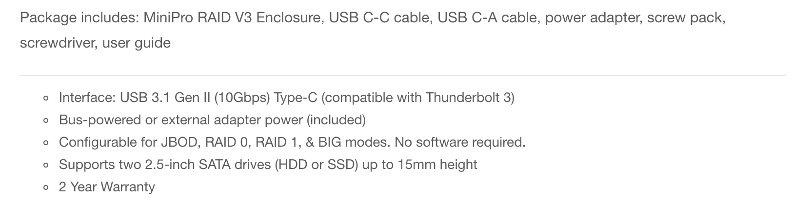

At any rate. That RAID enclosure as mentioned by @hfg is only USB. As it is USB 3.1 Gen 2. If you want full throughput. You should consider a USB 3.1 Gen 2 hub as I think the USB Type A ports are only USB 3.1 Gen 1 (3.0).

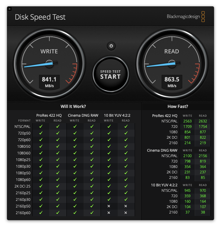

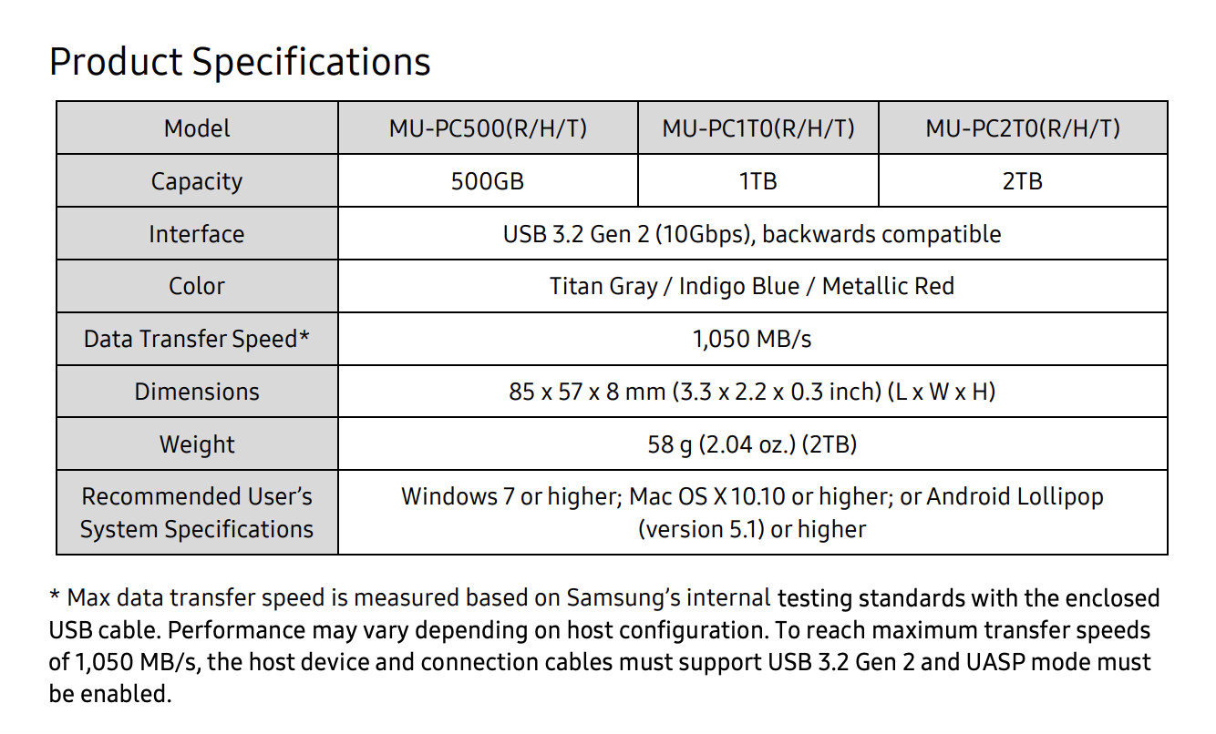

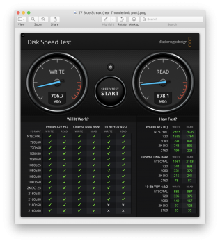

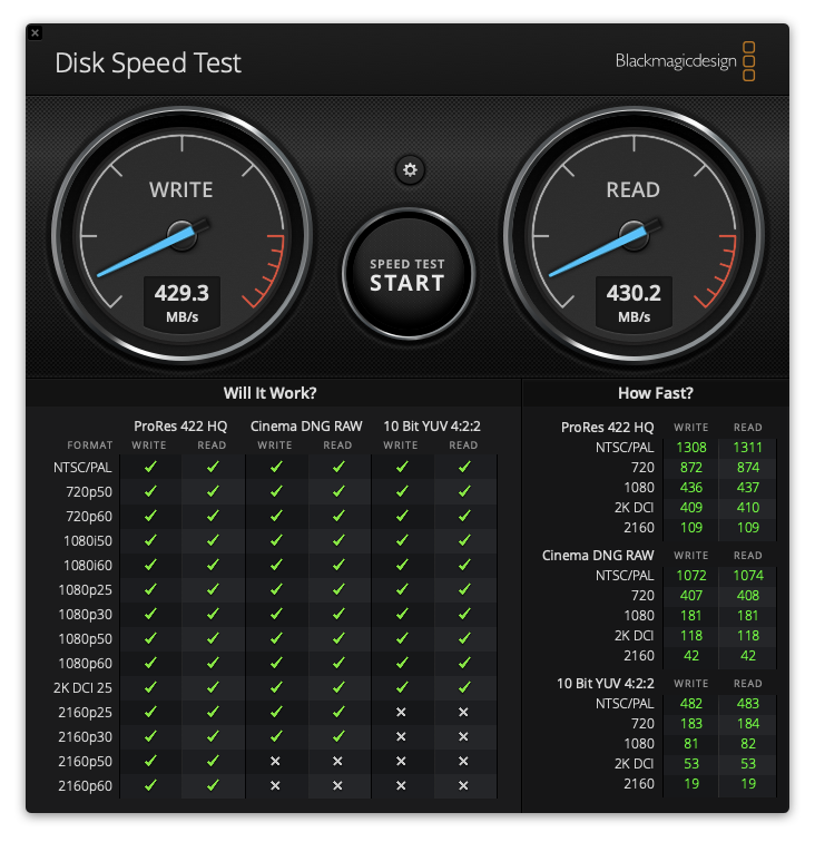

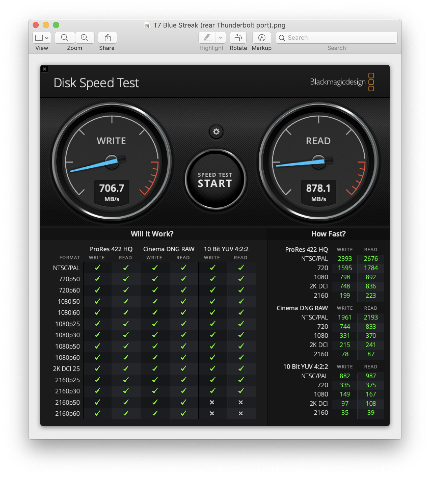

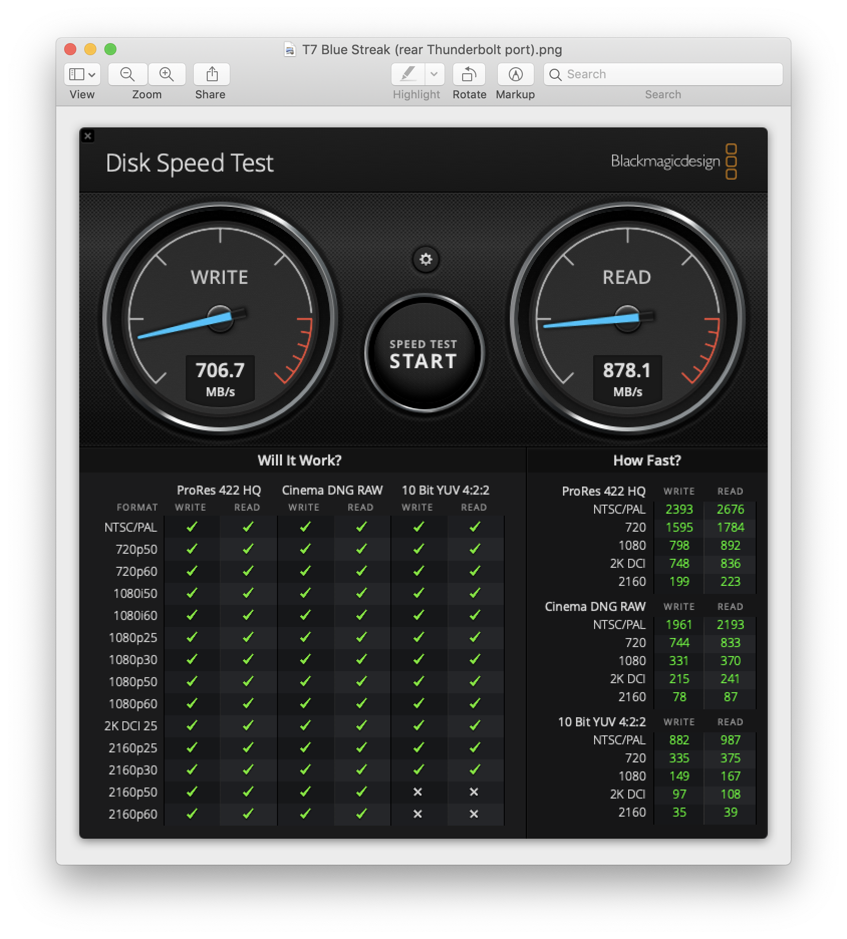

I can state for sure that the OyenDigital MiniPro Raid V3 with SSDs in RAID0 has twice the speed when attached to the iMac's Thunderbolt port versus one of the USB ports (see below). The same is true for the T7 (in fact, the speed numbers are similar). I believe the 2017 iMac's USB ports are limited to 5Gbps. The MiniPro RAID is spec'ed as USB3.1,Gen2 with 10Gbps max and the T7 is spec'ed as USB3.2,Gen2 with 10Gbps max. So, I think it's correct that neither device is Thunderbolt3 (40Gbps), but which port they are plugged into on the iMac makes a significant difference.

MiniPro RAID V3:
Samsung T7:
MiniPro RAID0, TB3 port:
MiniPro RAID0, USB3 port:
