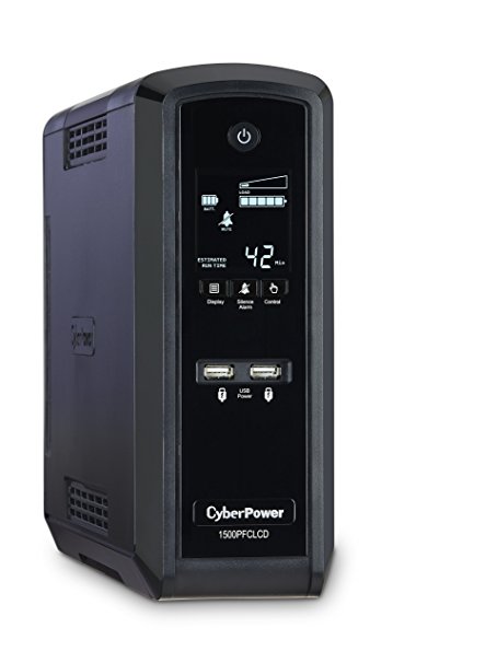

I got the CyberPower CP1500.....very nice unit with excellent feedback digital display.
2-years and still running real strong on original batteries.
https://www.amazon.com/gp/product/B00429N19W/ref=oh_aui_search_detailpage?ie=UTF8&psc=1
$215.00
