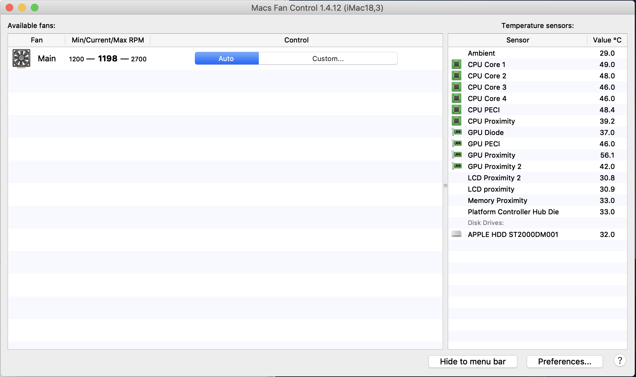

I have Macs Fan Control installed and nothing seems out of the ordinary. Also, the fan doesn't seem to kick into high gear before it happens, so I'm not entirely sure. "GPU Proximity is definitely the hottest at 55 degrees C and going up. I've attached a screenshot. I have logging going on, but nothing really of note beyond: "[2019-02-03 09:15:46:008] [thread 5677] [SMC/Service.cpp#630] WARNING: getTemperature - skipping sensor TPCD with value of 129"

Okay, another shot: If your fan is staying at 1200 rpm, there's something off. If it goes up to 2700 rpm, everything is fine here. Is it always when you're doing taxing things, as in can you replicate the behaviour?
Yes, that’s what starts it, but after it gets hot it’ll do it for any reason (even if down to idle). I’m not sure what the fan curve should be, but it takes a while for the fans to speed up.
Okay this sounds good so far. If the fan goes up to 2700 rpm or so, everything is as intended.

So, I did the 10second unplug thing, and plugged it back in and went into macOS, then windows and... it crashed when playing again. Notably the fans DID not speed up, and as soon as it restarted and I was back in macOS the cpu temps were showing over 100 C. They quickly cooled down once the fan picked up in macOS. So I do think it's a thermal thing, I just can't figure out why in macOS it's crashing too when I know the fans speed up...

I'm going to open it up and re-apply the thermal paste. It's well known that Apple over-applies and temps suffer because of it. I throttled the fans with macs fan control and haven't experienced a crash since, so I kind of doubt it's something actually wrong with the circuitry.
