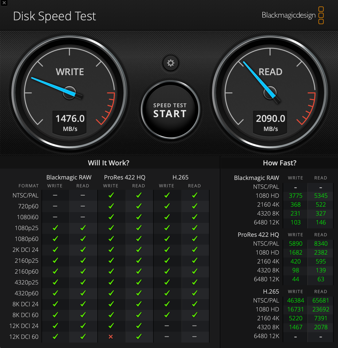

I got one of these in the 1TB size for my 2017 iMac. I'm running the OS off of it and have been very satisfied. It's night and day between this and the machine's fusion drive.
Here's what its speeds look like right now under load in the middle of my workday.
