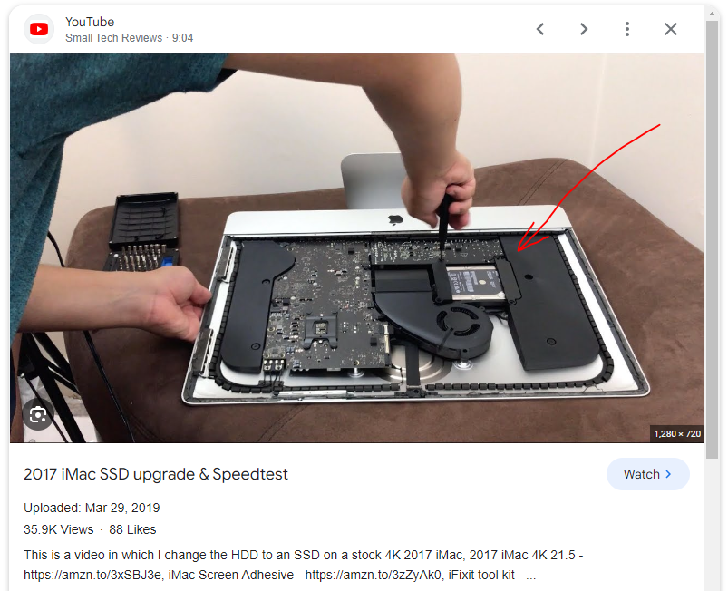

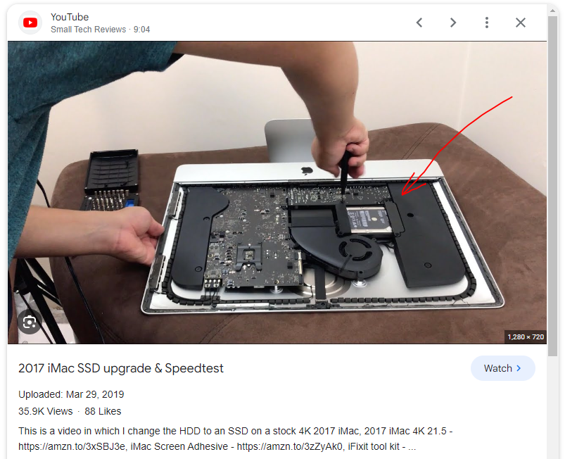

The "spinner" would've been here:
Oh I know. I have watched a ton of videos and lots of research. Just trying to figure out what I am getting in to before I open it up, or if I can accomplish my intended result. Not sure why it is not listing one in the specs unless it was built that way..... thus my questions. I would go the external route but I like to tinker 🙂

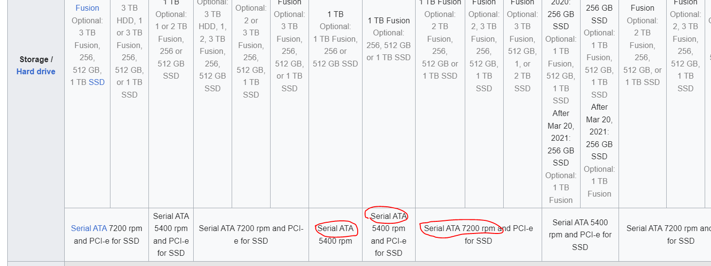

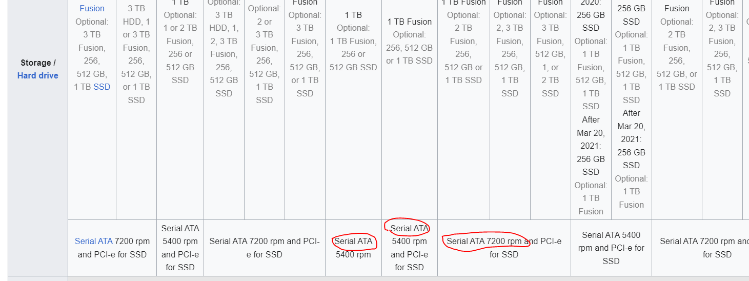

I haven't seen it myself, but:
1. Apple normally builds one machine and provides multiple configurations, which all have the same base components. I've never seen them have different ports within the same model variants.
2. I trust the Wikipedia article, it's been there for 6 years, it would've been changed if it were wrong.
But that article does not state it either. I read it. I will have to assume its there and proceed accordingly.

Isn't the above highlighted text 'stating it'?
Also, by 'connector' do you mean 'port' or 'cable'? I think it's clear the port is there, but there is no cable.

I don't read it like this.
There are two columns for your iMac in that Wikipedia article. In the "Storage" row, the first column says "1TB", which means a SATA HDD. The second one says "1TB Fusion", which means a PCI-e SSD and a SATA HDD. It means both model variants HAVE TO support the SATA port. They won't be removing the SATA port for the SSD-only configuration. That will be crazy and costly. I'm willing to bet $50 that the port is there.

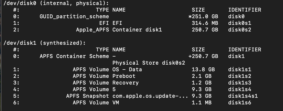

Not sure why I am seeing a disk0 and a disk1 but this is the info terminal shows
