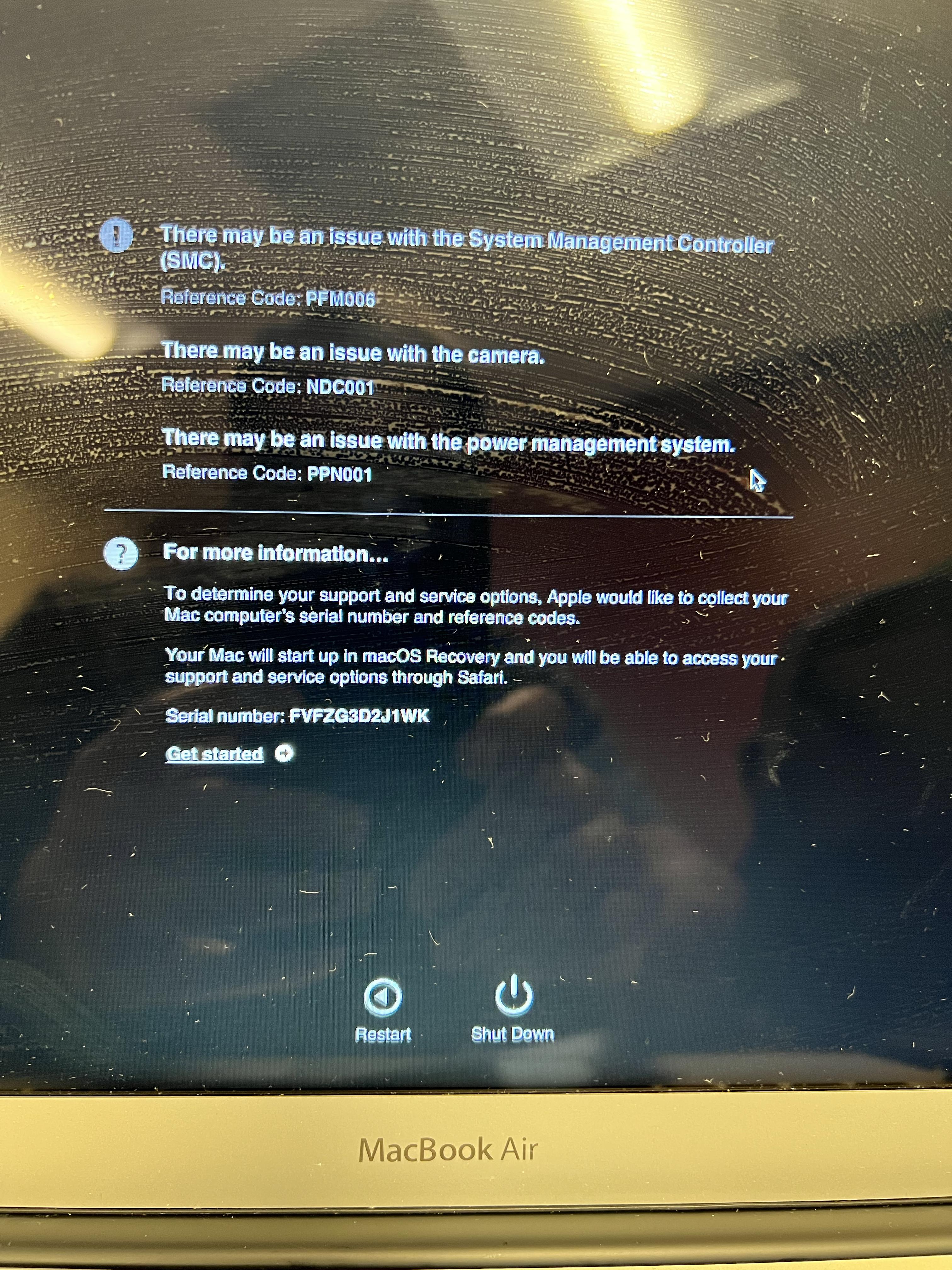

I'll try that (D) now. It is quite possible that it was dropped and spilled on. This is a college machine! There is a small dent on the top left corner of the bottom plate. There was a tiny crack in the vent tube, but I don't think that is causing it. No red indicators.
System controller?
I see from my searching that this could be battery or memory related. Question, are the memory removable sticks or are they soldered onto the board?
I suggest removing the logic board and examining the other side. There are moisture sensors that can't be seen without removal.
Seems to me that the board needs to be examined more closely by a tech who can perform board-level diagnostics. I believe there is something wrong with one or more of the temperature sensors.
