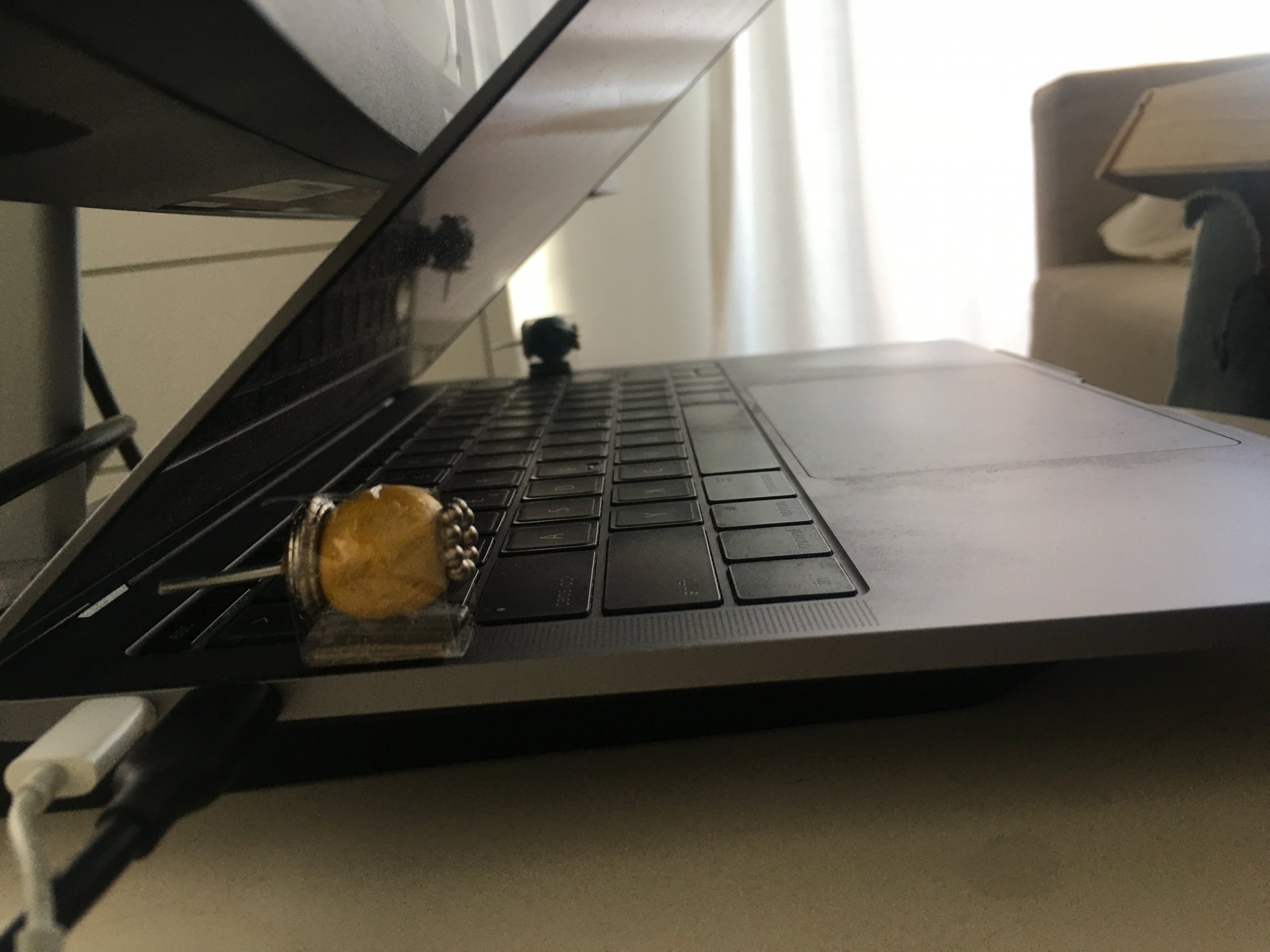

On my MBP Late 2016 nTB, it needs 2 magnets, left and right side just where the tab key is. I used weak fridge magnets, and actually had to hover them some millimeters above the case for it to work - so I just put some carton in between and attached them with a weak tape.
Here is the position of the magnets on the 15 inch MacBook Pro 2017. They are magnets from an old 2.5 inch hard drive, wrapped in tape. I had to change the screen twice, because it got bluish spots, and one guess (besides pressure marks) is the heat from the clamshell mode, so I prefer to leave it open.
