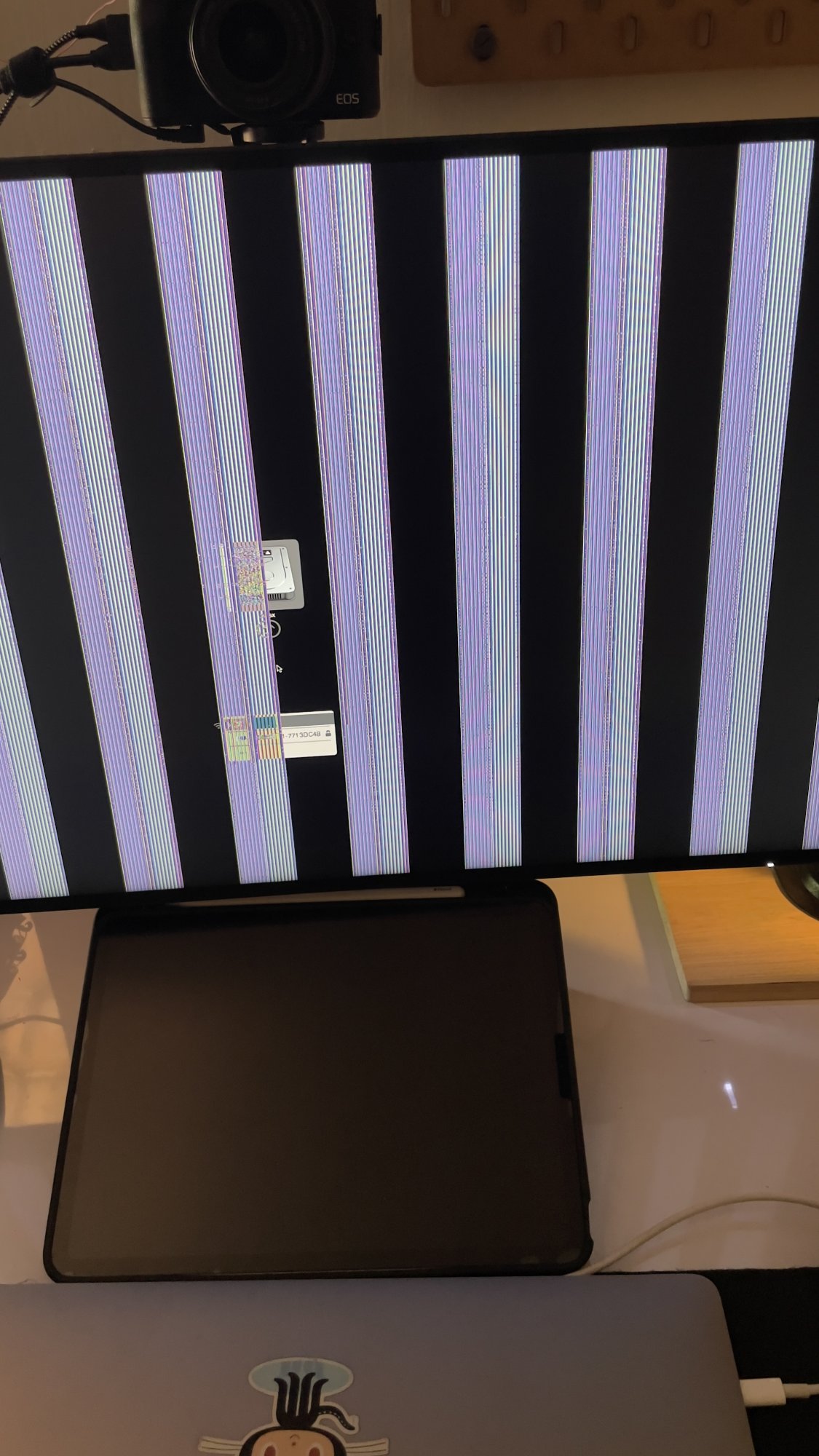

MacBook pro 2017 touchbar 15 inch on the external monitor.
I broke the LCD screen, since then I'am using second monitor as main display. Everything seems normal for a year but then I got this problem. Anyone know what is this and how to solve it? The external monitor was fine, I've tested it using another mac.
At first I thought it is because the Monterey OS, it's still beta. But the problem come after weeks later. Now I downgraded it to Big Sur but the problem is still there.
Also after the macbook entering the OS (this is where you see the login screen) the external monitor automatically sleep because there is no input detected.
I already run the apple free diagnose (Option + D on startup), but no issues detected.
Appreciate any advice, thank you!
Looks like issues with cable or even graphics card.
Did you try to connect to other mac just to make sure?
Also you can do Pram and SMC reset
Yes I tried it on another mac and it worked fine, I also did a Pram and SMC reset but it had no effect.
I also suspecting the graphics card, but the apple system diagnose didn't telling that problem :/
Thunderbolt Display Through thunderbolt 2-3 adaptor. Pretty sure any monitor will do
Well, yes -- with the right adapter. But most external displays are not thunderbolt, and some adapters are not necessarily reliable on every type of graphics connection.
For the OP, if the external monitor works on another Mac, you should try a different adapter on your MacBook Pro.
