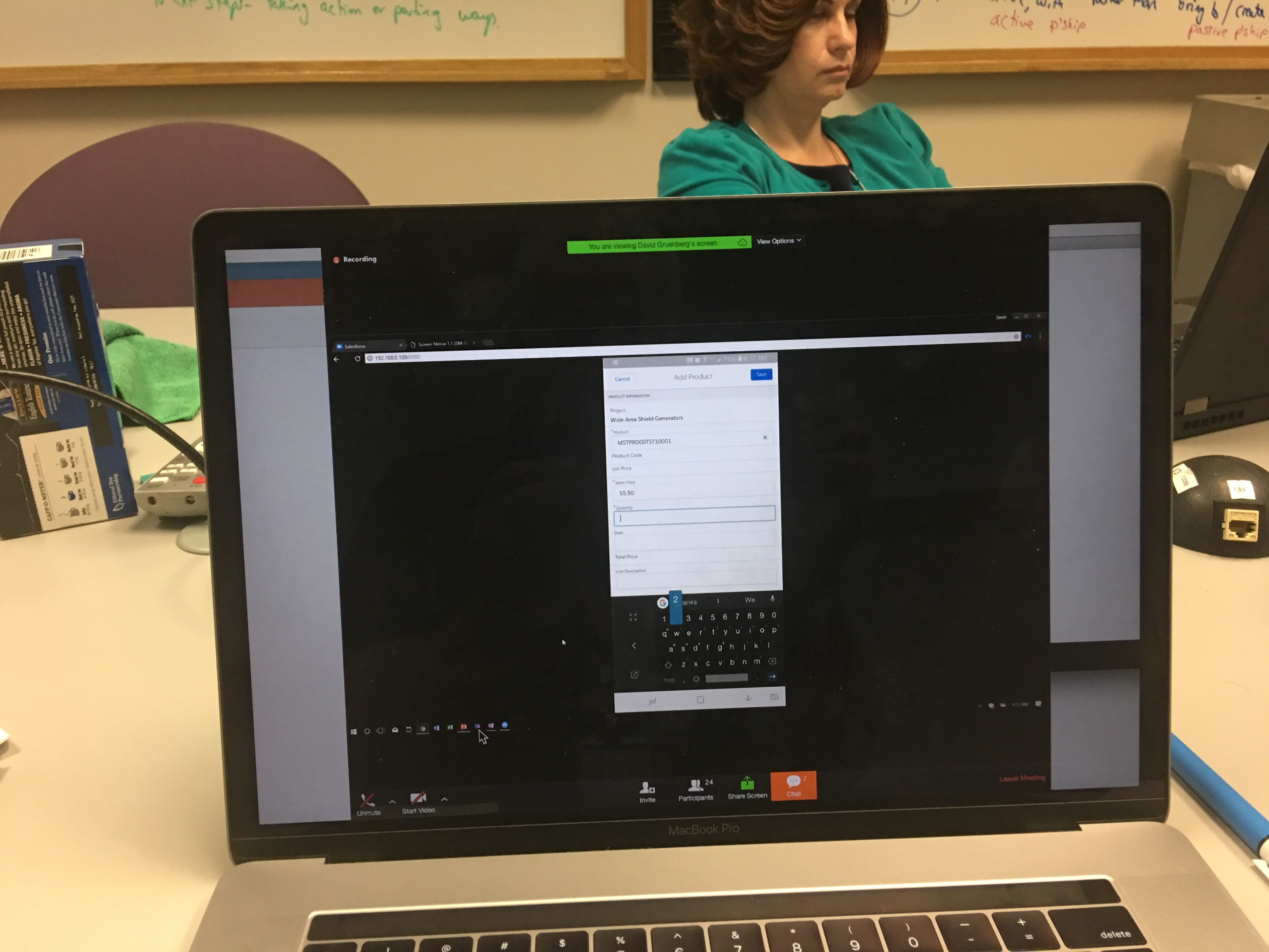

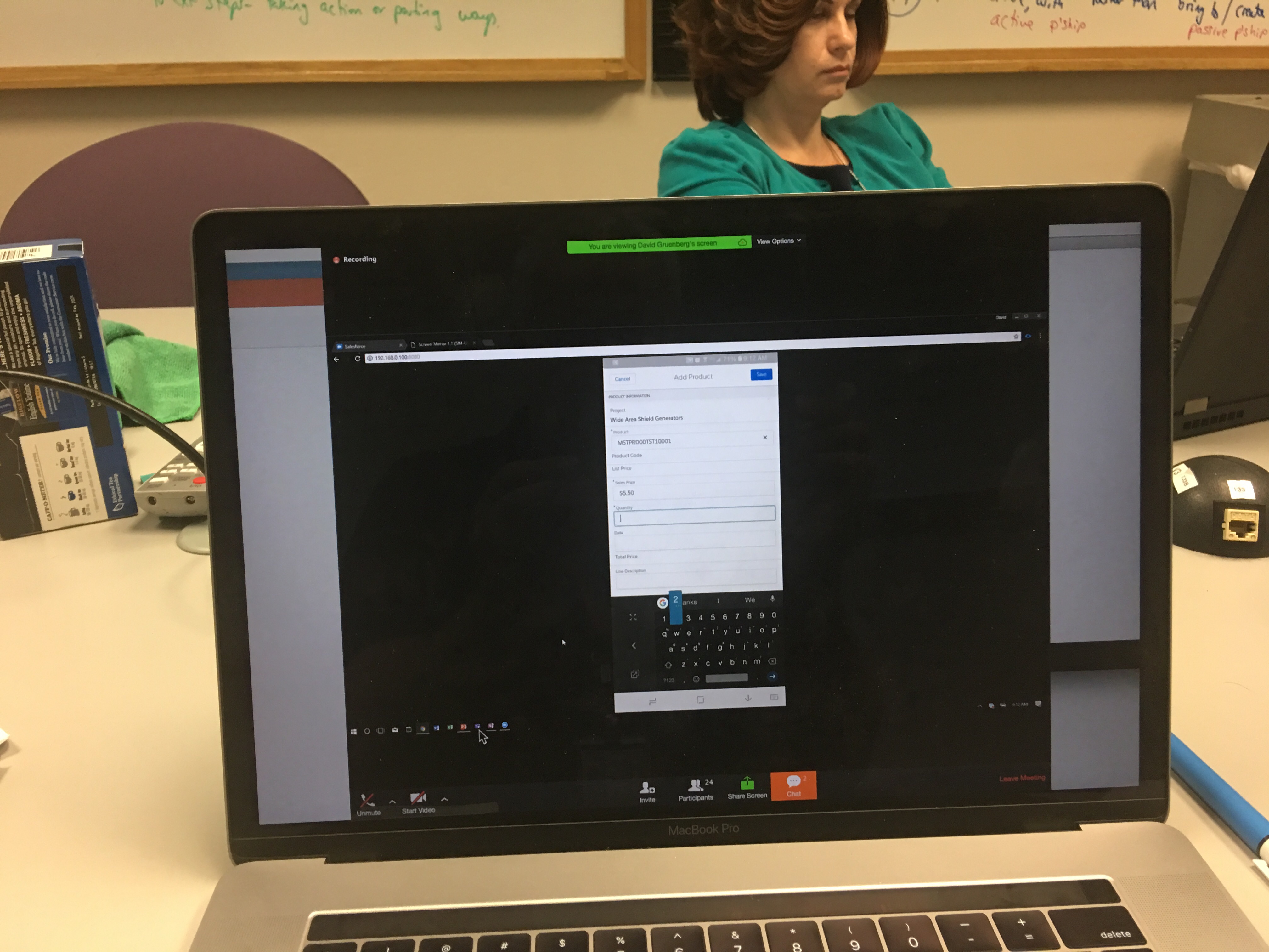

I get randomly flashing left & right border areas on my late 2017 MacBook Pro retina 15 inch when plugged in to an external projector with different screen resolutions & shape (eg 16:9 vs 4:3)
It mostly goes away if using PowerPoint.
See attached photo - those light areas on left & right are flickering randomly and quickly!
EDIT: after running a PPT presentation this flashing goes away under all other apps etc... weird!
