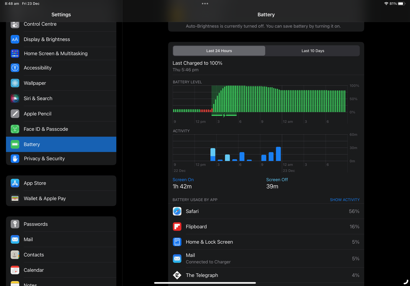

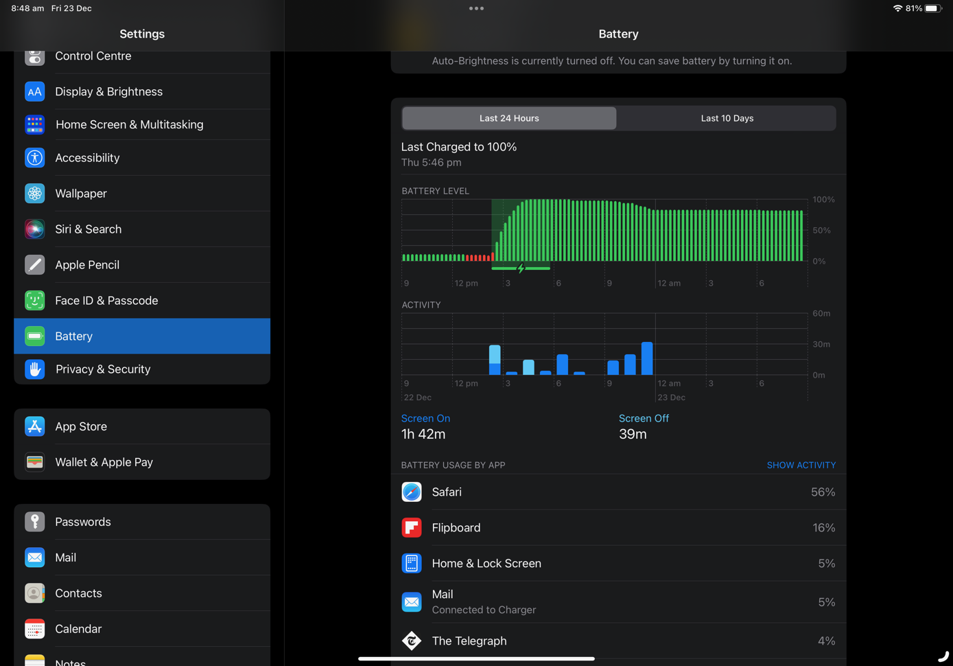

Think I may have resolved the problem. Charged it to 100%, manually closed all apps then did a forced restart. Used it for a while then left it overnight. 'Last 24 hours' battery screen below. Screen On time since completing charging is 89 minutes and battery is 81%. I will continue to monitor it.
Think I may have resolved the problem. Charged it to 100%, manually closed all apps then did a forced restart. Used it for a while then left it overnight. 'Last 24 hours' battery screen below. Screen On time since completing charging is 89 minutes and battery is 81%. I will continue to monitor it.View attachment 2132017
There’s something... off. That screenshot shows no standby drain, but screen-on time is way, way too low. 1.5 hours 100-81%? Usage doesn’t seem heavy either. Extrapolating screen-on time the best I can, you’d get around 6 hours 45 minutes of screen-on time on a full charge. Is brightness too high? Do you have mail accounts on push? Maybe background app refresh on with a lot of apps? Like I said, the drain doesn’t seem to be a background thing, however, and as usage seems light, I can only think of very high brightness, because it seems to be dropping while you use it, way too quickly.
Thanks. I extrapolated total screen-on time to be around 7.5 hours (1.5 hours = 20% depletion so 1.5 hours x 5 for 100% depletion). Is that still too low in your opinion?
Brightness is around 50%, mail accounts do not use push and background app refresh is set to off for all apps.
The 100-99% percentage point takes a lot longer (7 to 8 times longer) than the rest of the percentage points (99%-0%), which are linear. Extrapolating that percentage point directly would be a mistake, hence why my extrapolation is shorter.
Brightness isn’t so high so as to drop it to a sub 7-hour battery life, and the rest of the heavy settings are off. I still find it too low, especially considering that usage isn’t heavy, and like I said, the main battery drain culprit isn’t insanely high (brightness).
