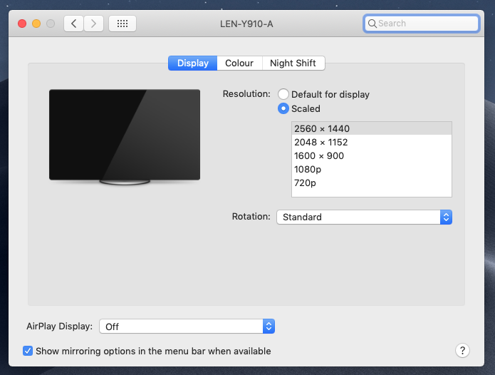

How do you access the "looks like...." resolution?
I'm asking because on my 1440p display (over hdmi), to get the "native retina" look i would need to set a 720p resolution...but it looks like crap, so it's not doing the 4x interpolation apparently

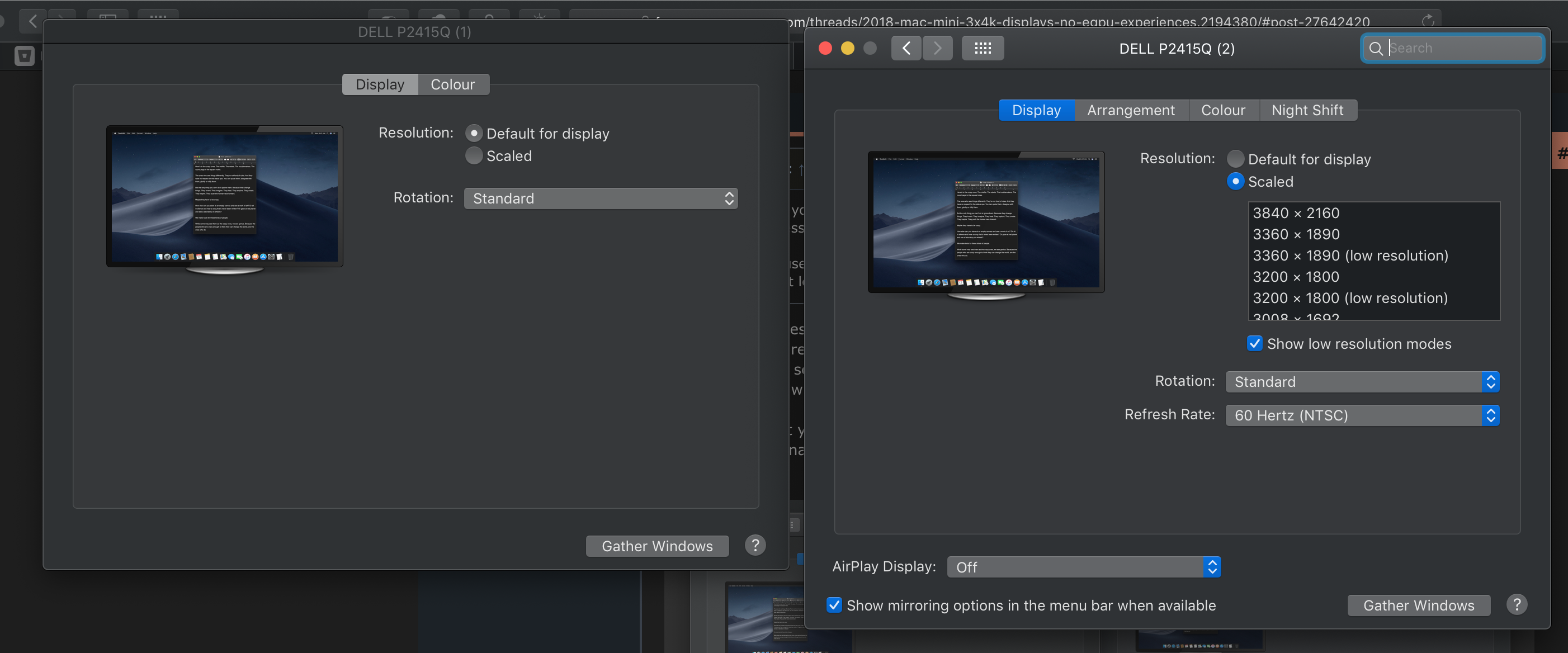

The default on these displays (and I believe most other displays with a suitably high PPI - certainly it's true on my 2018 MBP15) is "retina" mode. I have to hold Option and click "Scaled" to get the old-style list of resolutions, which has both "retina" scaled modes (all of which will end up sending a 3840x2160 image to the display), and the non-retina approach (where it's sending the resolution you pick to the display).
I'm guessing that you'd need the display to be no bigger than ~17" or so, for macOS to detect it has being "high DPI" and offer the retina scaling mode.

I don't see those "low resolution" resolutions on my screen....still, it's a 27" 1440p display...at least 720p HiDPI should be available somehow, but i can't see it. It only lists it as 720p..(not even 1280x720). Default resolution for display is 2560x1440, but it looks...nothing as sharp as yours.
I'm using DP, but your problem is that you're using a low PPI screen. 2560x1440 @ 27" is ~109PPI, using it at 1280x720 would make everything on screen comically big, and still wouldn't look that great, because the physical pixels are still quite large/low density.
As I said - the "Retina" modes only seem to be available (and only really make sense) on displays with reasonably higher than "normal" PPI (normal for macOS being ~110).
yeah, i know. I'm running a hackintosh partition on the AIO which has this 27" screen and there i manipulated the display modes to show 720p hidpi, as well as 1080 or even 1440p (by creating a fake 2880p resolution). While 720p was the clearest of them all (like in your screenshots), it was also the smallest 🙂 so yeah, unusable but worked. Anything else in forced hidpi mode (like 1080 or 1440) looked a bit better than native 1:1 but nowhere close to sharpness and clarity of 720p hidpi.

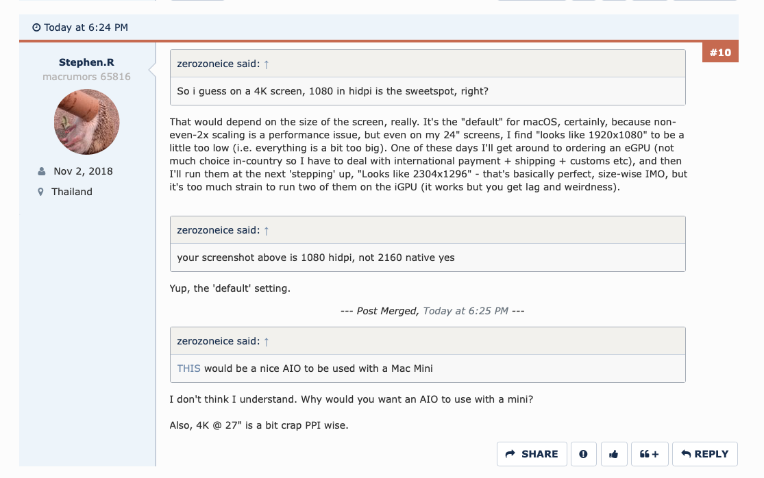

So i guess on a 4K screen, 1080 in hidpi is the sweetspot, right?
(your screenshot above is 1080 hidpi, not 2160 native yes?)
THIS would be a nice AIO to be used with a Mac Mini 😉
That would depend on the size of the screen, really. It's the "default" for macOS, certainly, because non-even-2x scaling is a performance issue, but even on my 24" screens, I find "looks like 1920x1080" to be a little too low (i.e. everything is a bit too big). One of these days I'll get around to ordering an eGPU (not much choice in-country so I have to deal with international payment + shipping + customs etc), and then I'll run them at the next 'stepping' up, "Looks like 2304x1296" - that's basically perfect, size-wise IMO, but it's too much strain to run two of them on the iGPU (it works but you get lag and weirdness).
Yup, the 'default' setting.

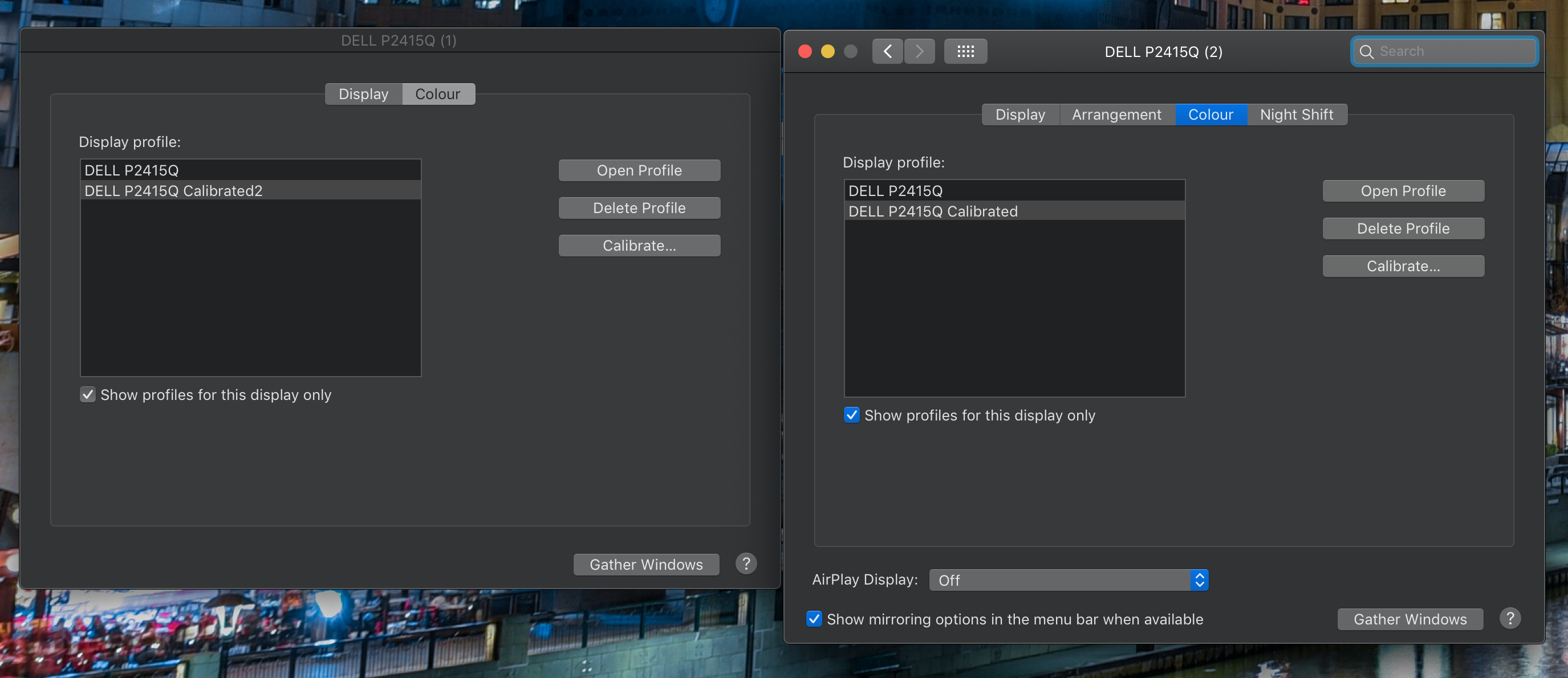

Now, do you use the default monitor profile or use the calibration wizard to adjust it more?
yeah, the image seems a bit darker after the calibration wizard. Kind of almost like slightly more contrast. But is good.

as i sidenote, the calibration over DP is different than HDMI.
also the calibration wizard creates a profile that it's identical to the default one.
in case of HDMI, the custom one was a bit darker, more contrast i believe.
Your monitor may have different settings between the two inputs if you tweaked them there before. Alternatively depending on many things like phase of the moon etc. the DisplayPort may be on v1.1 and have less bandwidth or HDMI may have picked a different encoding (4-2-2, 4-2-0, …) leading to different colours.
