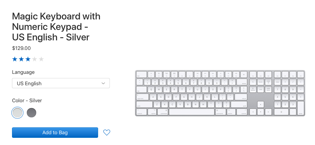

I have the Magic Trackpad 2 and it works flawlessly when connected. Plus I don't have to worry about charging it. The same is likely true of the magic keyboard. I have everything plugged into a powered hub and have computer sleep turned off.
It is, although I rarely use the keyboard wired and I'm not having much of an issue to begin with.
[doublepost=1550001174][/doublepost]
So I can't use the Magic keyboard/trackpad if I'm using anything else in the USB port? What the hell did I buy?

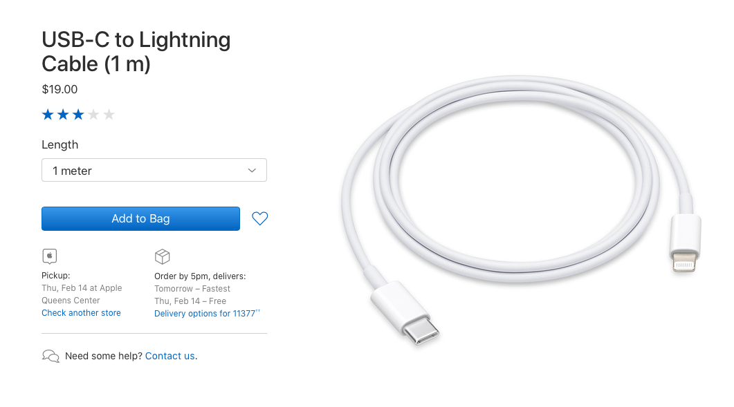

If you want to use these wired, you have two USB-A ports and four USB-C ports. What's the problem? A choice of six ports isn't enough?
This is Apple's Lightning to USB-C cable, which comes in 1m and 2m lengths.

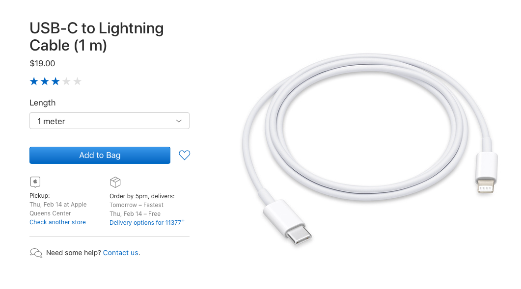

No thanks. Why do you think they created wireless peripherals in the first place?

I wasn't responding to you, was I? I was responding to someone talking about using a USB port and complaining that the port might be needed for something else.
Personally, I'm not having a problem in the first place, although I do use peripherals wired sometimes. Indeed, the Logitech G900 mouse that I'm using right now is 2.4GHz and requires use of a port even when used wireless. Great mouse, by the way. Before the G903 was released, it was US$150, but you can pick up New Old Stock for about $85.

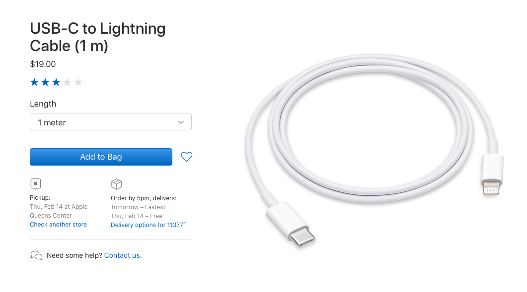

You must be joking? Your trolling is working because I'm supremely irritated by your response. I bought this setup because I need the bluetooth when I'm working with audio. Your "solution" doesn't work for me, and I sure as hell ain't paying 3400 dollars for a computer and peripherals that are supposed to work in a way they simply don't.
