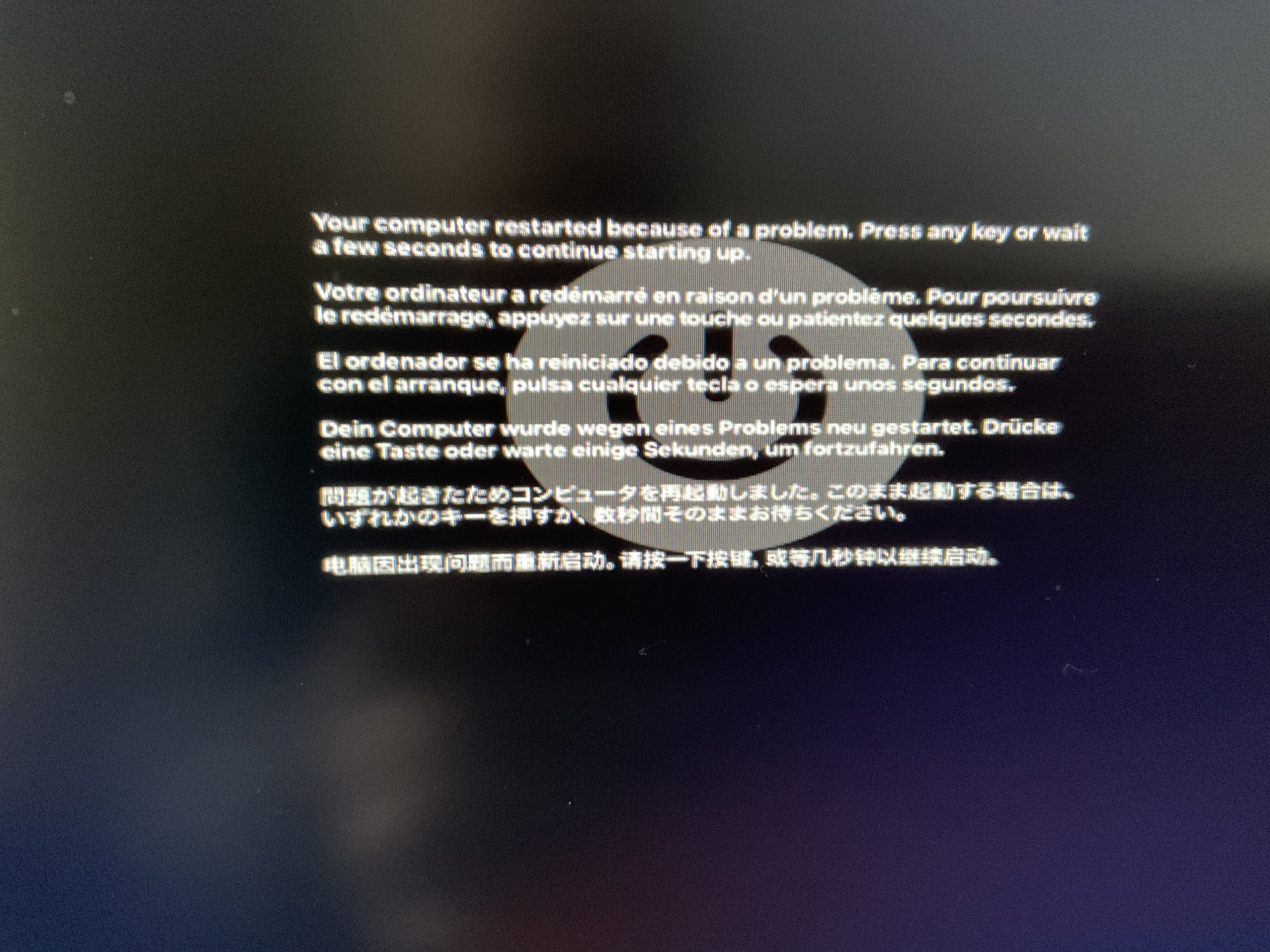

Seeking help for the Mac currently running on the latest MacOS software which is constantly rebooting and greeted with the following pictures then it reboots again showing the same messages in the pictures. I am using the logi-tech IR keyboard therefore not sure if I can get the Mac into Safe mode (or any other modes for that matter!).

Ok, little progress, was able to get the Mac into Recovery Mode and got as far as the Utility Page then it reboots again.
Now I cannot get the Mac into recovery mode, every time the Mac is switched on it will display the Apple Logo and the White LED is illuminated, then the Mac reboots again (LED is now off), this process repeats over and over!
Update, LED comes on, now no Apple Logo, then LED goes off again, repeat!
Can only hazard a guess that the power supply unit is goosed, or worse, the motherboard?!

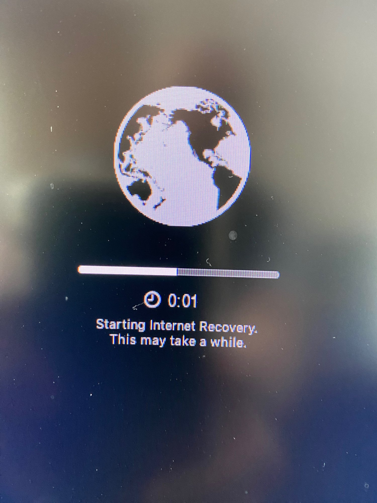

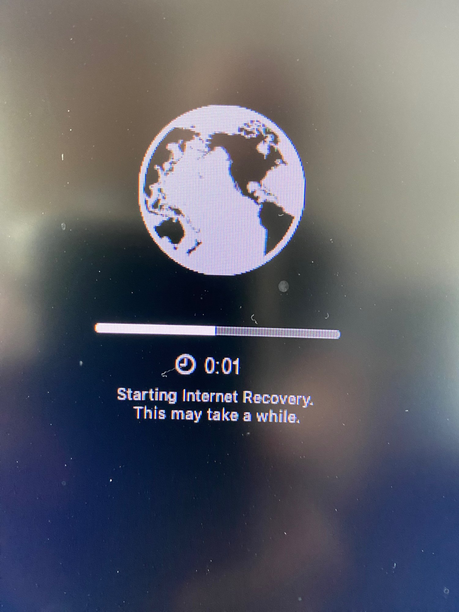

Many thanks Fishrrman, the wired keyboard with Command-Option-R now brought up the internet recovery but the holding down the Shift didn't work.
1. Out of the power-up power-down cycle;
2. Now in a starting internet recovery (this may take a while) loop each reboot approx 2mins, would I be correct to assume that this constant rebooting in internet recovery mode is normal and just let the process continue?

Leave it for a few hours. If the internet recovery doesn't work or finished, there's a (physical) problem with the machine.
Took the mini to the Apple Store to see if they could resolve the issue, preliminary diagnostic suggests that the Thermal Interface Module (TIM) has failed. They’re going to run a deeper diagnostic on the mini however the Tech is 90% certain that the motherboard will need replacing!
