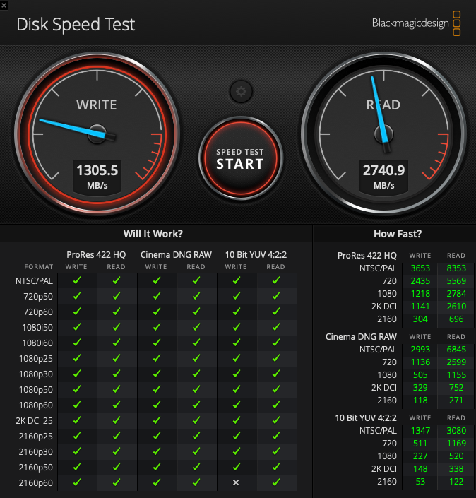

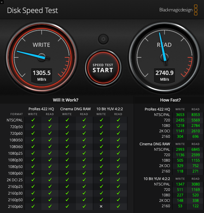

That's interesting. When I run Blackmagic on the i5/256GB/8GB, it gets pretty much the same read speed, but a much lower write speed:
That’s because the lower SSD 256GB size. They increase in speed with size.
