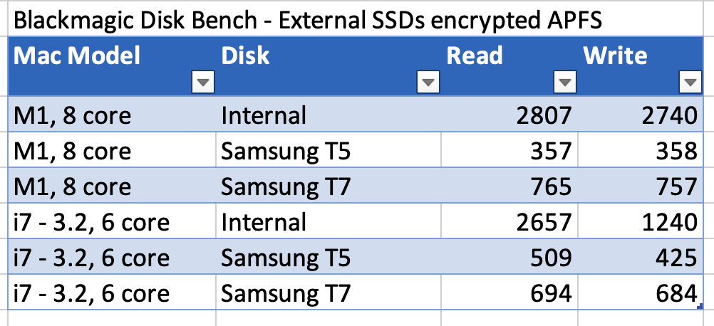

I tested my 2018 i7 Mac Mini vs my M1 in external SSD speeds. The M1 was quite a bit slower.
Similar results in copying 1 large file from internal dist to external ones.

Would this not be a Thunderbolt controller issue/disparity?
I have this Thunderbolt enclosure with a third party SSD and get about 2,000 MB/s on both an Ice Lake MacBook Pro, and an M1 Air.
I opened another thread about this as I hadn't noticed this one. I also have the T5 and see much lower read/write speeds with the M1 mini compared to when it was connected to a late 2017 iMac 🙁
Reactions: OSX15
I just tested my external TB3 SSD drive on Mac mini M1 and MacBook Pro i9. I can confirm that speed on M1 is very "jumpy". Between 500 and 2100 write and same for read. On the other hand on i9 it is always at max! So M1 seems to have a problems with Tb controller, not only USB affected but also TB3 devices. Not good at all 🙁
