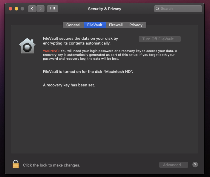

I do have FileVault enabled at the momenet, is your thought to disable allowing auto login - thus removing the need for a second screen connection from the onboard gpu to view the password prompt screen?
I opted for security over convenience so do not allow auto login. I haven't tried but it is logical to assume that enabling auto-login may get around the issue, but I am not certain. I make use of the USB A ports on the back of my monitor, and my understanding is it is advisable for me to have the mini directly connected to the monitor to have the ports passthrough to the mini anyway, so it doesn't bother me too much. The display issue is only an issue on mine when I reboot, which I rarely do anyway (I let it sleep when I am away from it).

Actaully ended up disabling FileVault, removed locally attached monitor, and hey presto. It works perfectly... Now to get the new Vega VII 😀
For future reference, Apple addresses this specifically in its support document on eGPUs. See the footnotes: https://support.apple.com/en-us/HT208544
You are correct "If you have a Mac mini (2018) with FileVault turned on, make sure to connect your primary display directly to Mac mini during startup. After you log in and see the macOS Desktop, you can unplug the display from Mac mini and connect it to your eGPU"
